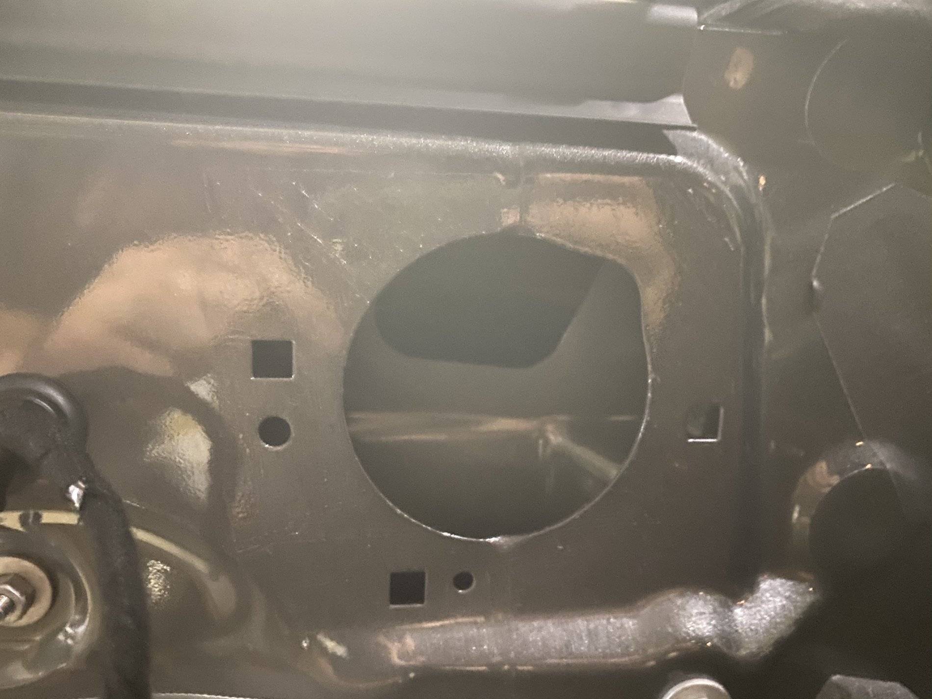

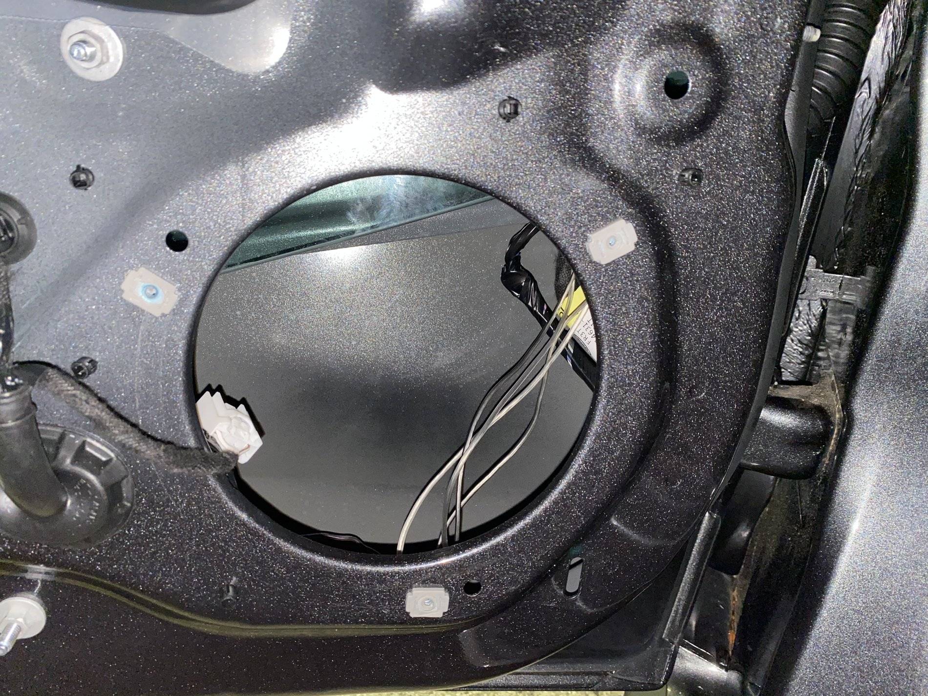

I am adding a 3" midrange to the door (along with other aftermarket components). My mustang is the base model and did not come with the speaker in the door, therefore it is missing the mounting clips and I just have 3 square holes on each door. Does anyone know the part number or how to find them?

For anyone that needs it the part number for the “nut” as the call it is either 5175742 or W715150-S900. They come in a pack of 4 and were about $10 with tax. This nut fits in the small square holes and allows the bolt to mount to the door cleanly with stock hardware. This is mostly for those with the 6 speaker system looking to add mid ranges that didn’t come with the car.
