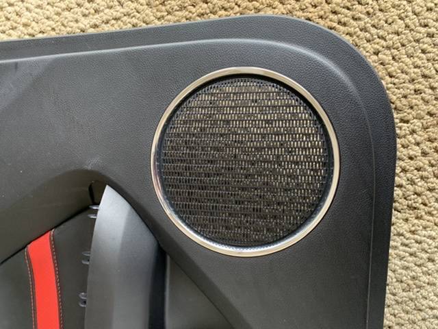

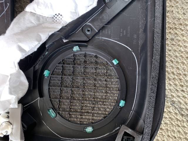

I replaced the lower door speaker with aftermarket speakers, but they jut out a bit farther and contact the grill in the door panel, making it rattle. I’m considering removing the grill altogether. Anyone done this? It appears to be permanently glued on from the other side. If I break the attachments, is there any going back later?

Can't shave it down, it's already thin which is why it rattles so easily

I know how to swap out the speakers. I’ve already done it like three times. My door panel is currently off. I’m just trying to find out if the grill that’s part of the door panel can be removed.

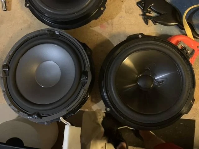

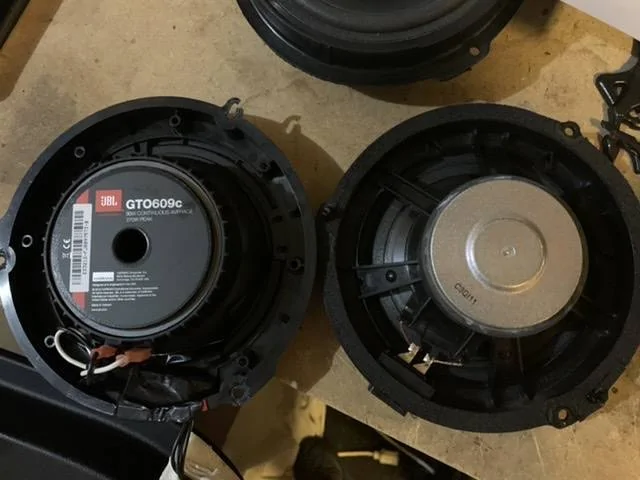

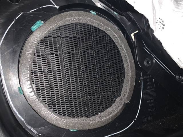

thanks I might try that. I already put some foam tape around the edge of the grill, going to try that first. Assume it will accomplish the same thing. Picture below. I installed JBL GT0609. Significantly bigger magnet. Not sure it will make much difference with the stock amp, but it can’t hurt. If I decide to do an amp later I should be good.

I already had film on the outside edge of the speaker. I believe it’s the raised perimeter of the speaker that is hitting. Don’t know what that’s called exactly. The foam I put on the grill will probably contact that raise perimeter, but hopefully it won’t affect sound much if at all. If it doesn’t work, I will get those foam things that you posted. Thanks again.

Here’s a picture of the JBL in the bracket with the foam surrounding it. I took the foam off of the stock bracket. I suppose I could use thicker foam. But I don’t think that’s the problem. The problem is the speaker surround, the raised perimeter of the speaker, is contacting the grill.

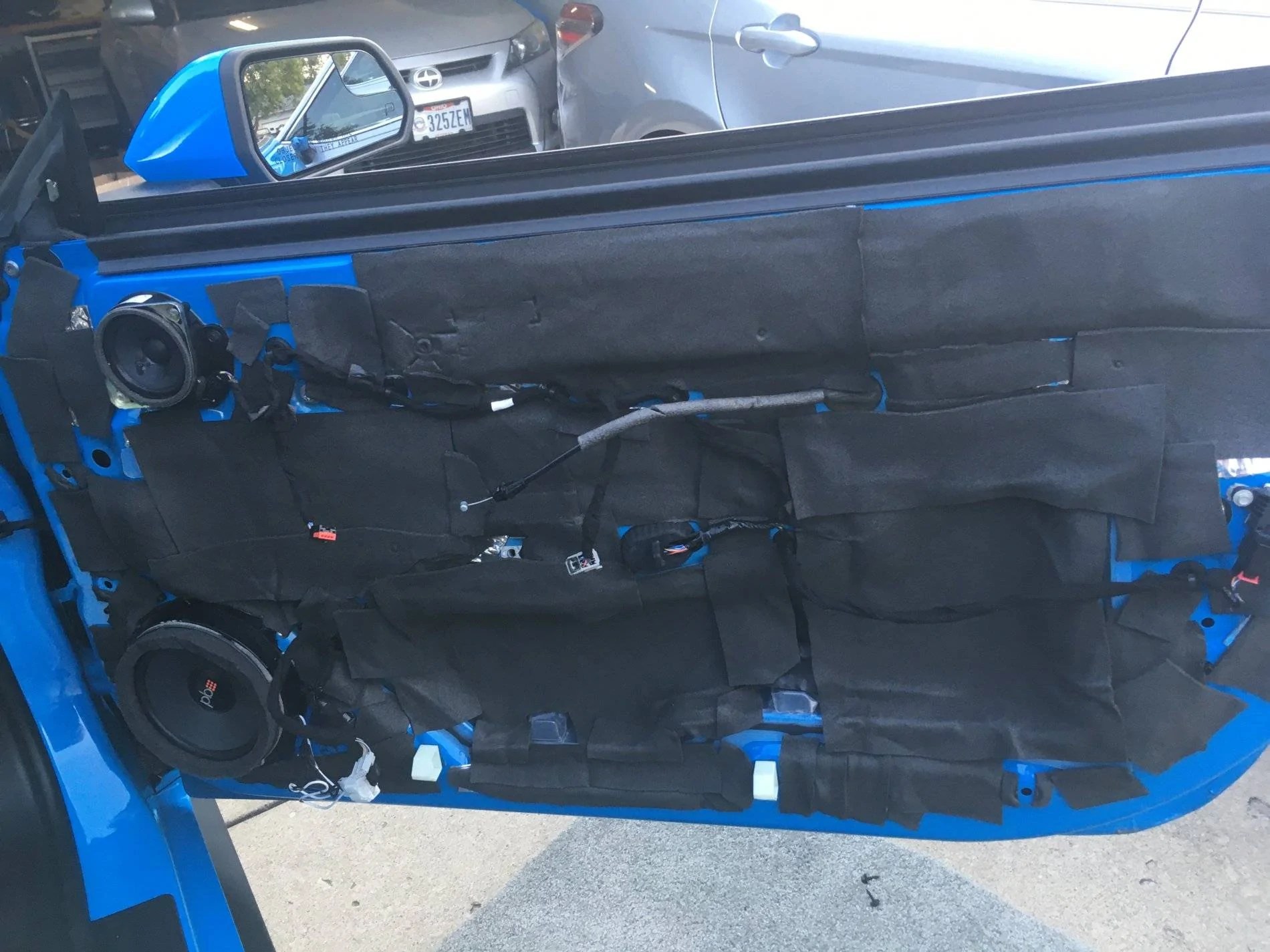

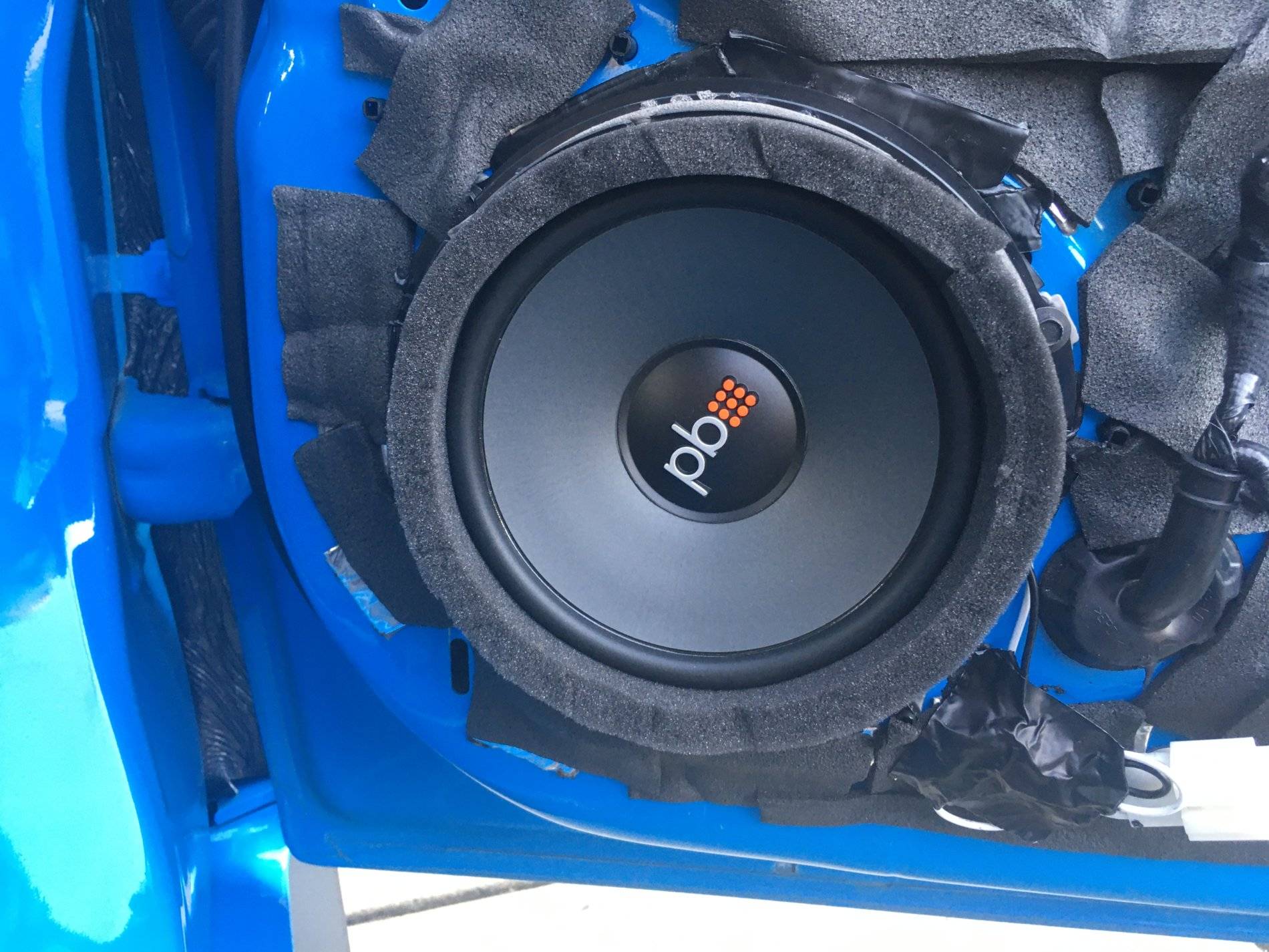

Fast rings are legit, I have the piece behind it, and behind and around the magnet too, and in front, I had to reduce thickness of front a hair but they firm. Plenty supportive. No rattles
I tossed dynamat in first then I tossed some ensolite over it, and between abt plastic to plastic or metal to plastic surface. No vibrations from my bass or sub

You like the Powerbass? If I can't get the JBL to fit, I may go with them since they are a direct swap.
