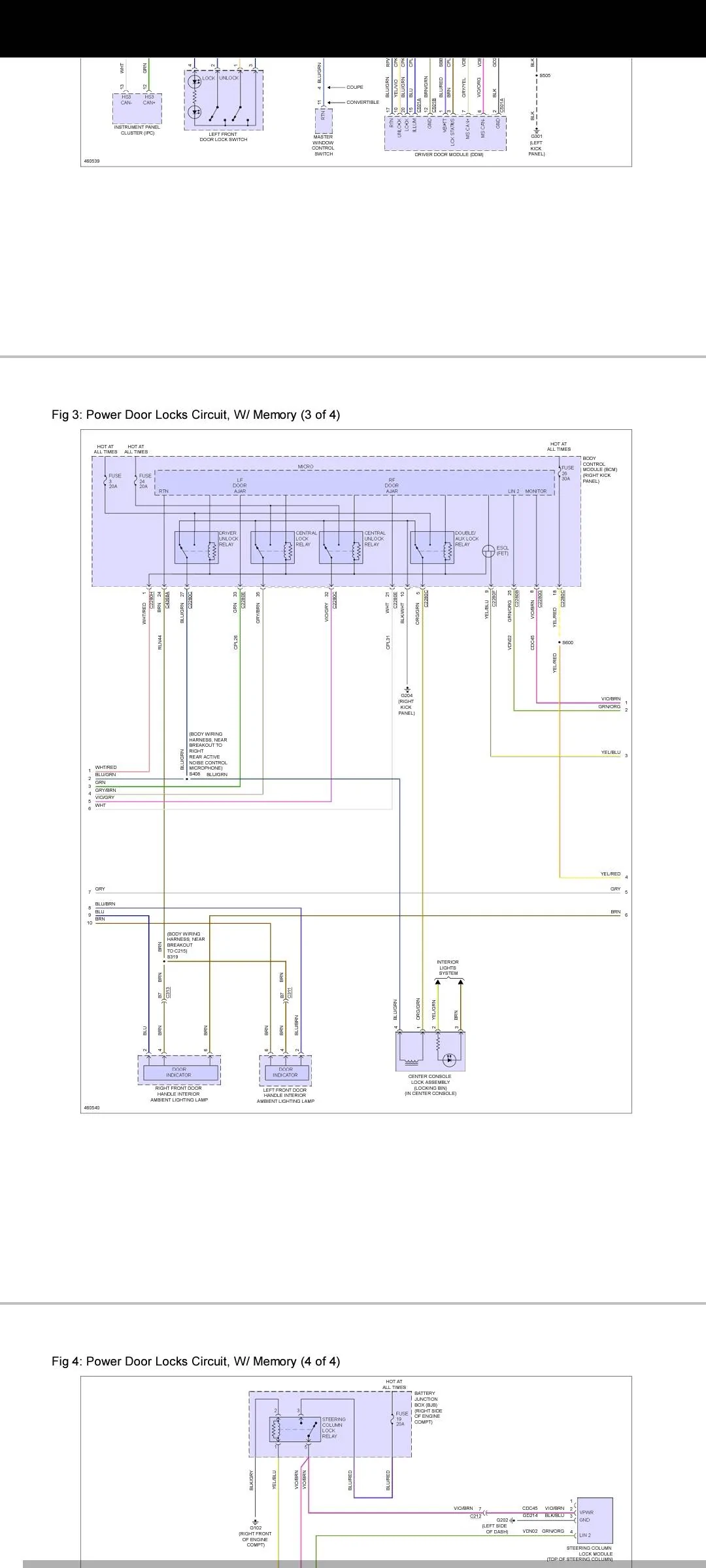

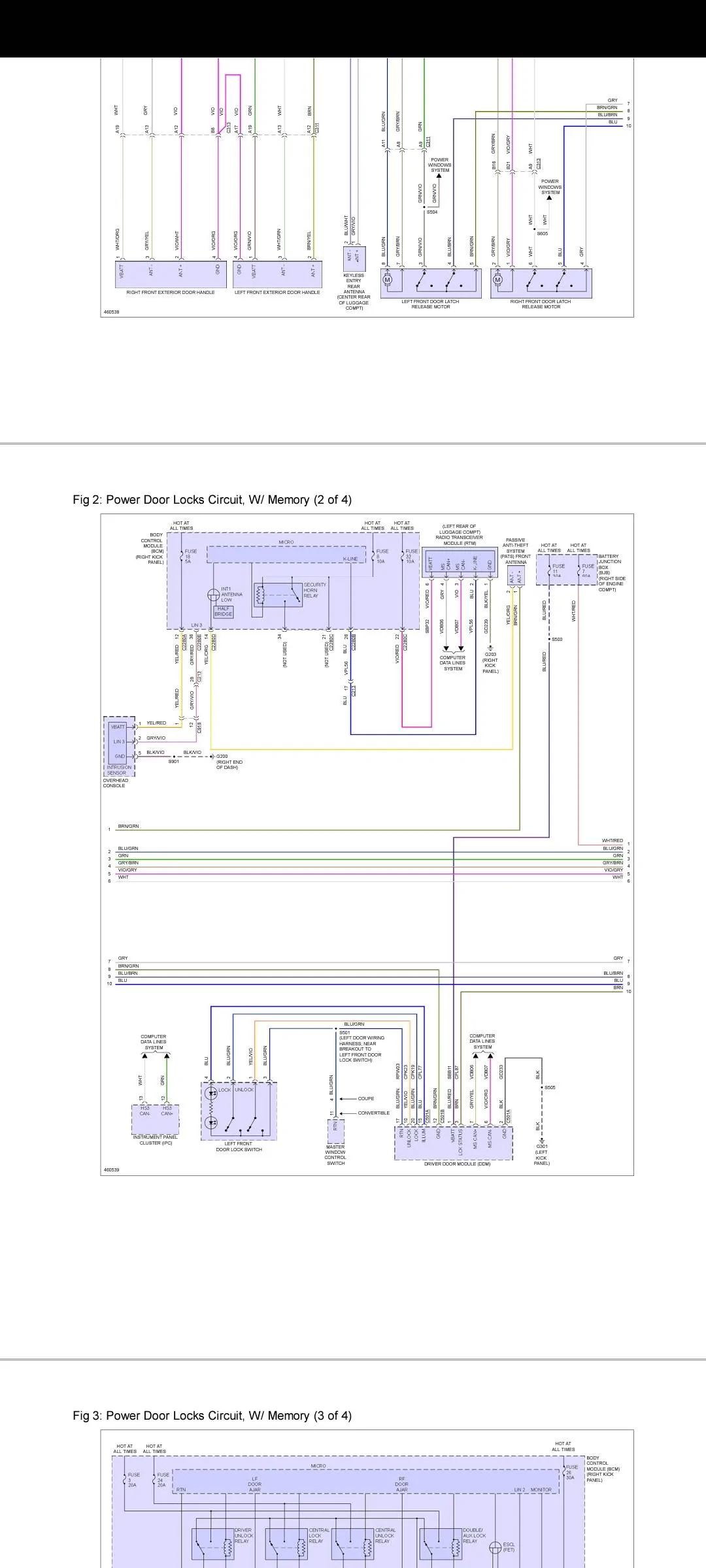

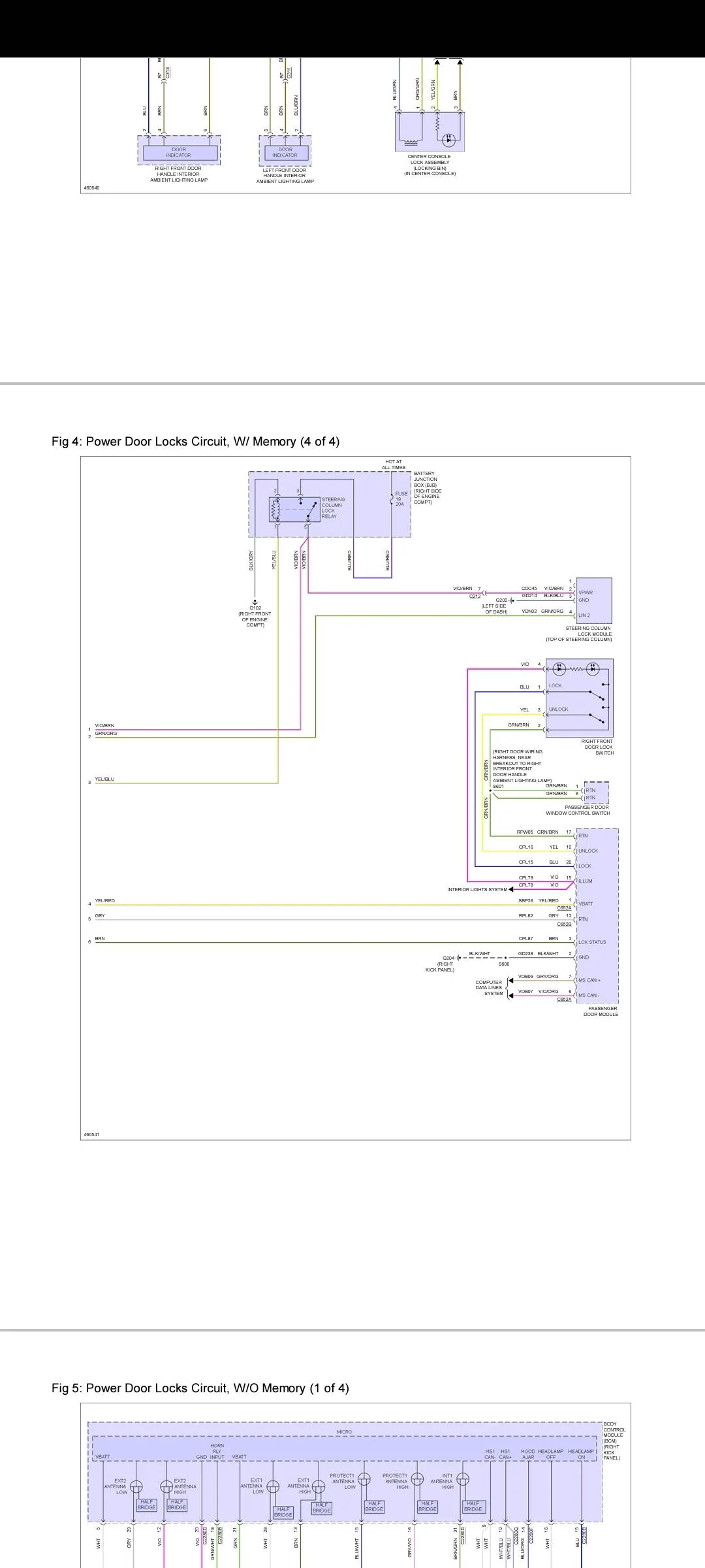

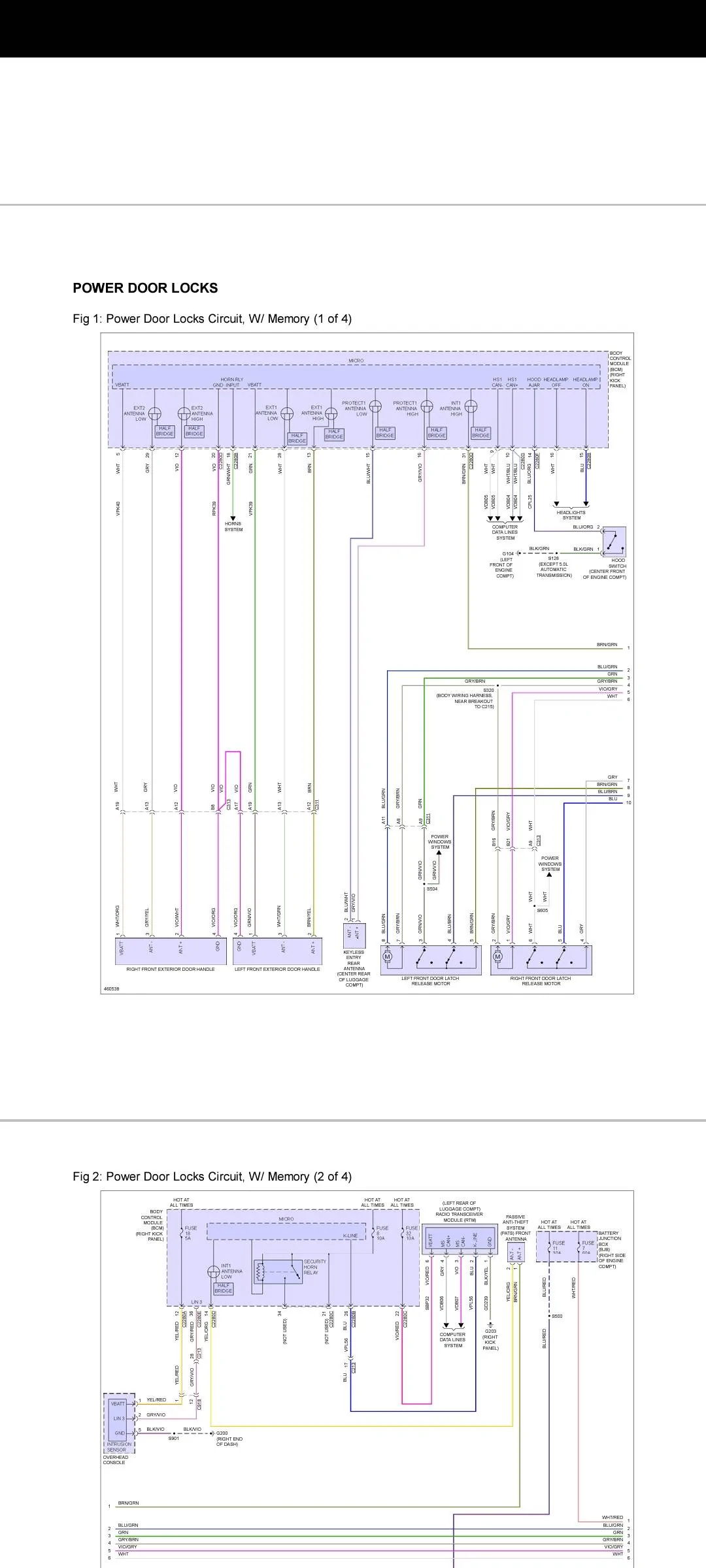

I'll include the wiring diagram from my '18 manual. It may be useful, it may not. I know quite a bit changed between '15 & '18.
Since it sometimes works I'd venture it's not a fuse. It could still be a failing switch, drivers door module, ground or BCM.
If you have access to a known good switch panel you could try that as suggested above.
If not it will probably require some fairly sophisticated troubleshooting. If you can DIY electric/electronics the wiring diagram may help.
Has there been any work done on the car recently? If so it might give you an area to start at.
Anyway, good luck.
