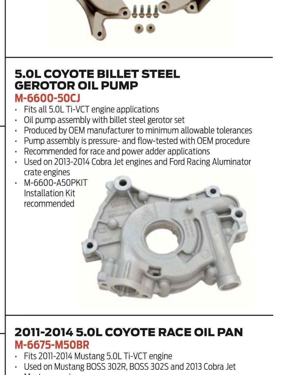

So the cobra jet is running the Whipple Kit with ATI dampener.... Does it have Billet opg's???
Yes, the different oil pump. Then again, that is a legit race car lol.
