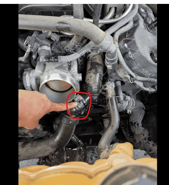

What number on that picture do you need? And what year is the car?

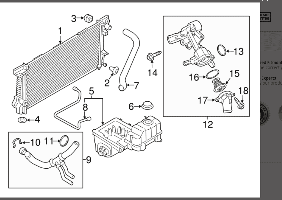

Exactly I asked for the oring that goes into the upper hose radiator for a 2016 GT like this one:https://lmr.com/item/KM5290/mustang-gt-upper-radiator-hose-15-17
But the employee told me that they only sell the complete hose! should I go with Dorman 926-168 ? Or what would be the OEM part number?
PS: this image isn't from my car but google!

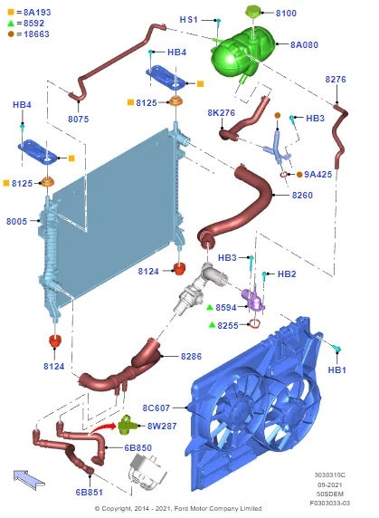

They say they don't sell it because this is the diagram they reference. As you can see it doesn't show a gasket for the hose. Not to say that Ford doesn't sell it, just that the dealership people are having a hard time finding it because this is the parts diagram for the coolant system, which doesn't show it.
This is exactly what they showed me!!!
