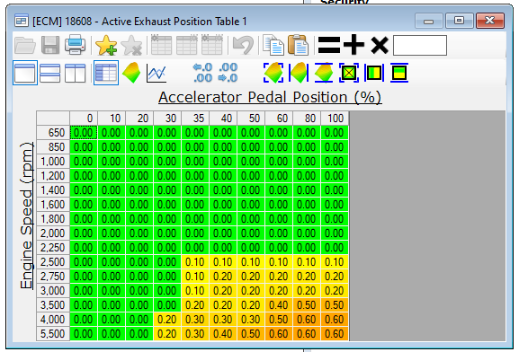

No, the AE is actively changing as you drive. Its not fully closed in quiet mode all the time, at redline in quiet mode its 60% open actually.
Ford did the math on that and came up with this:
This is quiet mode^

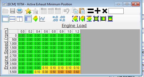

They also set the absolute minimum position of the AE to prevent backpressure.
This look up table is called backpressure control:
So to answer the question: no risk at all, if quiet mode is what you prefer you can leave it in quiet mode all day long.
