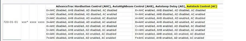

I'll leave this here so you can use it when you get your OBDLink:
Depending on your current configuration, the last digit in the first group will be one of the above. Just change it to the value corresponding to the same configuration plus auto-lock.
For instance, I had an E there, which I changed into an F. I have a hunch that it will be the same for you.
No changes in the BCM were necessary. The above change will make the auto-lock option appear in the menu on the digital dash, and once you turn the option on the doors will lock each time you start moving.
Great info - thank you :like:
I could find it for pre 20's, but it was in the BCM and we know the BCM changed in 20 - I would have been a little nervous trying it :like:

Even without the OBDLink you can already download the as-built data for your VIN here:
https://www.motorcraftservice.com/AsBuilt
It's an XML file which contains all the values in all of your modules, as they were set from the factory.
Open it in any text editor and search for 720-01-01. Mine looks like this:
LABEL="720-01-01"><CODE>8F4E</CODE><CODE>1C64</CODE><CODE>62E8</CODE></DATA>
This means the values at that address are 8F4E 1C64 62E8.
I would expect yours to look more or less the same.
