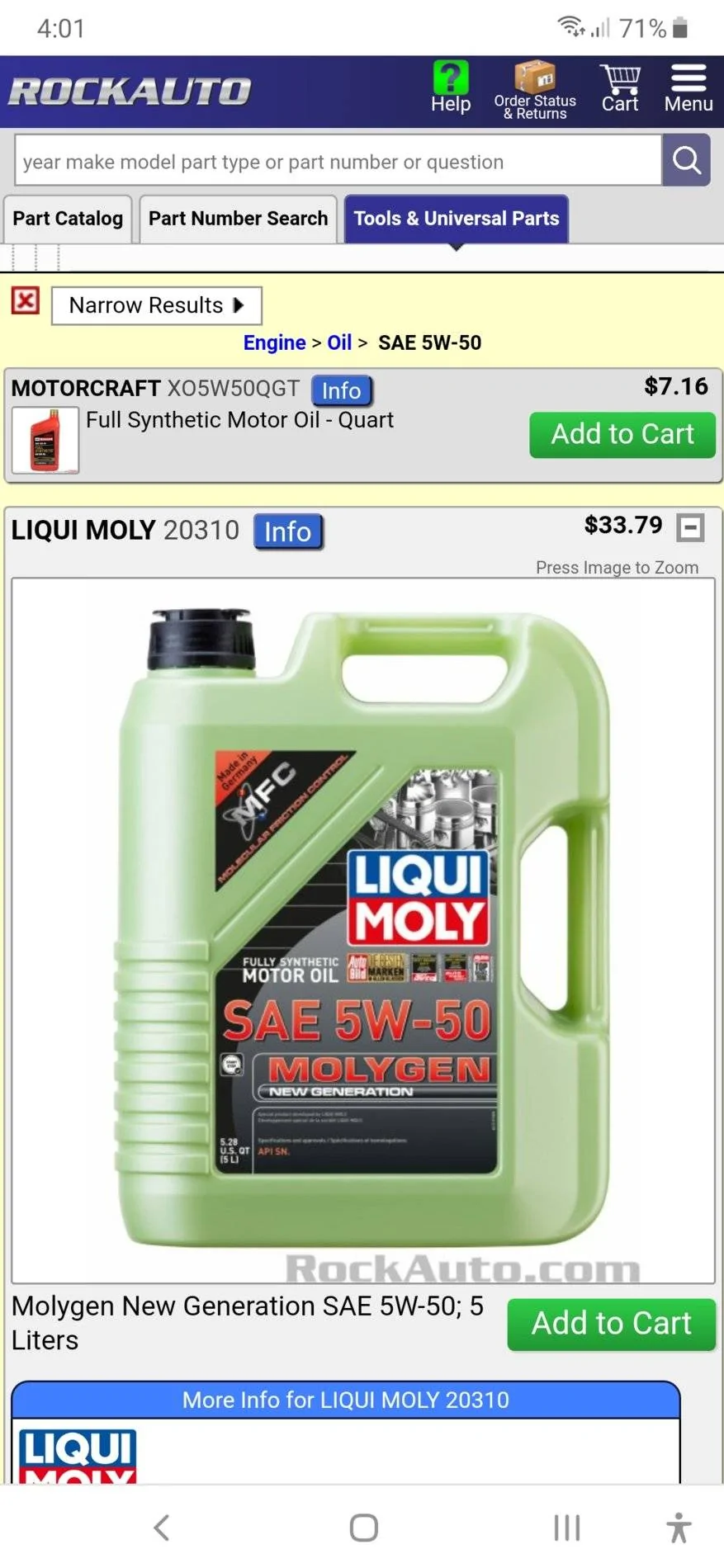

Liqui Moly is big in the European car scene. It's used by the big name brands like BMW, MB and Audi. In my experience it always has had a good rep.
Use it in my 2017 Golf R. Good stuff with a good rep in the Euro's, like you said. Motul is another big one.
