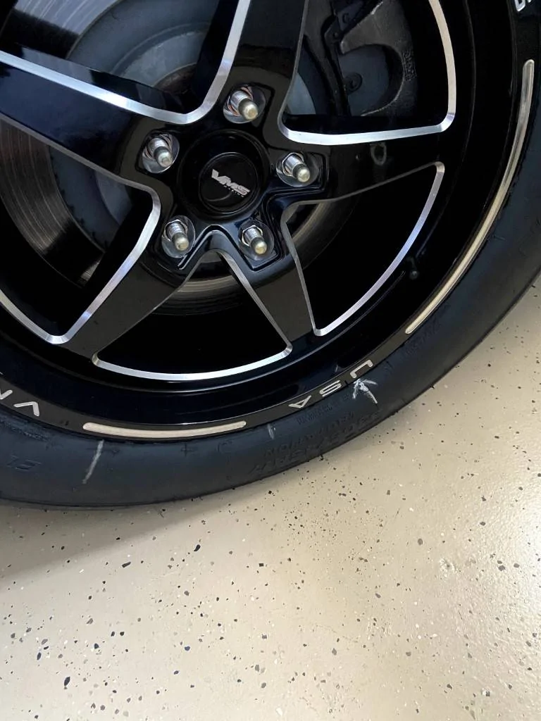

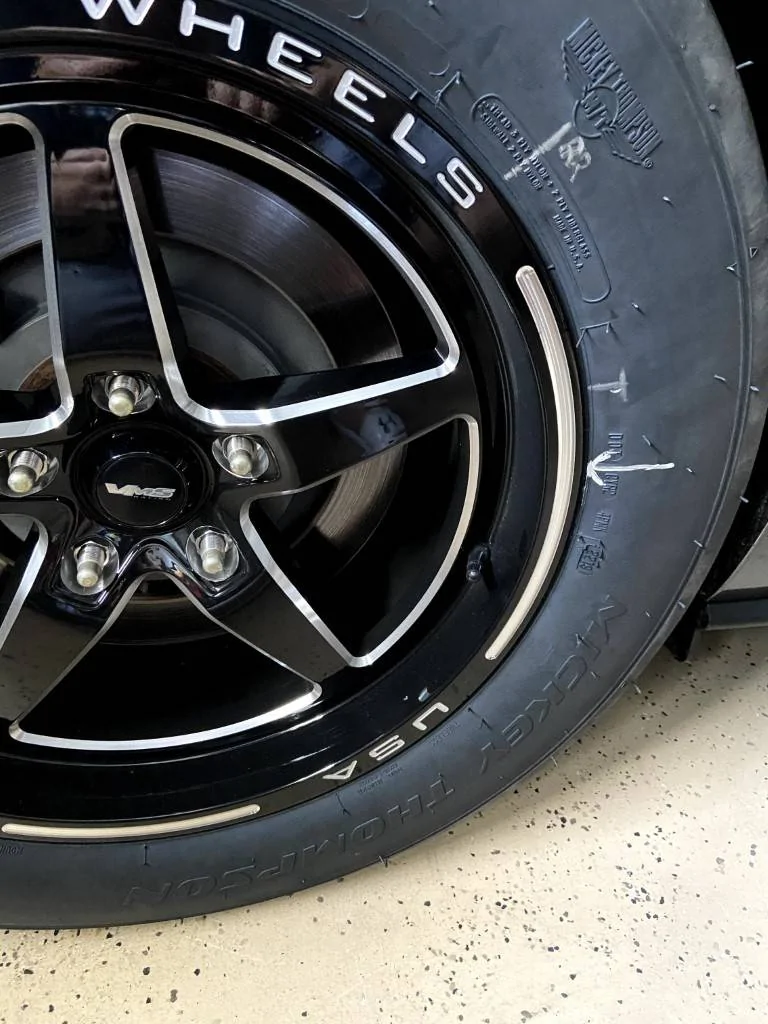

Trust me, it would be much cheaper to stay on my current rear wheels. But it's definitely slipping. I mark the tires before each track day and you can see how much it has slipped in the last 3 outings. Both wheels slipping by about the same amount.
Passenger side:
Driver side:
