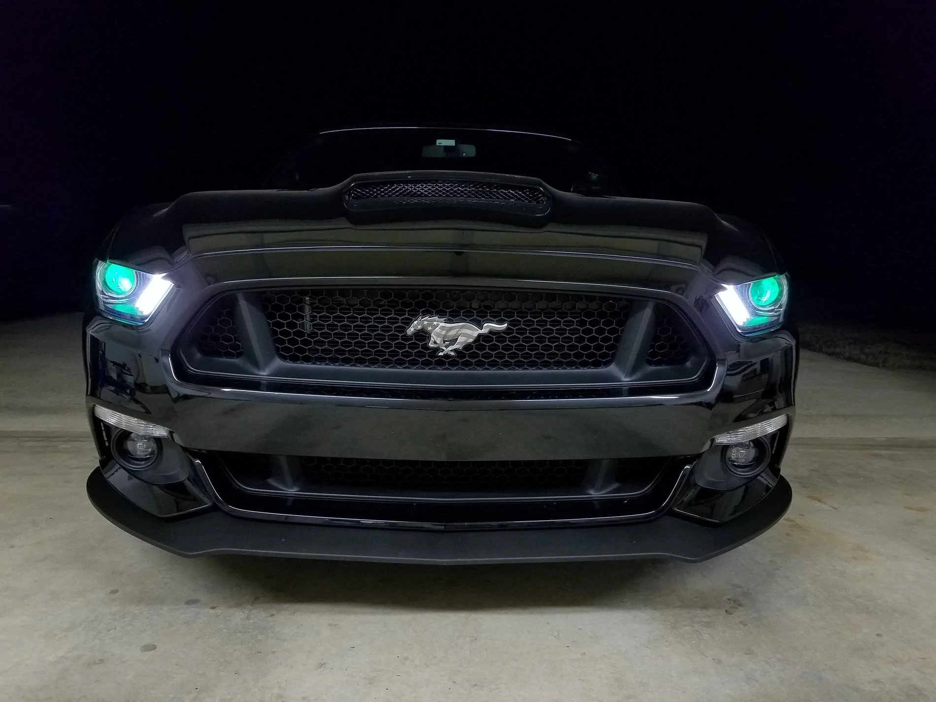

Hey so I’ve been looking at the diode dynamic demon eyes and saw the install requires bumper removal but I’m pretty sure I could get the job done without it. Just wanted some opinions from people who have installed it.
I looked at the car and the cover I need to take off faces the inside of the car. On the passenger side I could easily get to all the bolts to remove it. After removal though it would be at an angle but I figure with a mirror (possibly even without it) and a short/medium magnetic screwdriver i could take out the one screw required to install the bracket. If I can do the passenger side all I have to do is remove the air box on the driver side and I would have enough clearance.
Also I would be doing all new wiring and not tapping into the headlights.

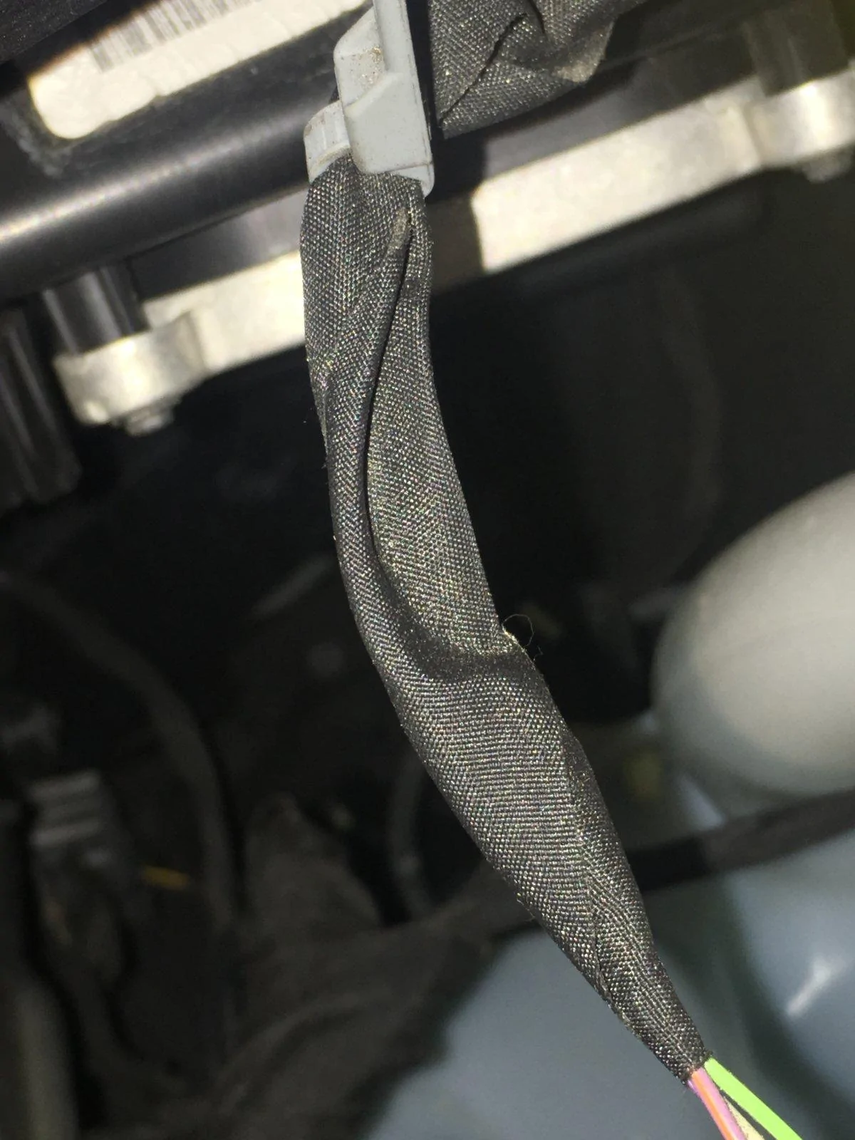

Where did you guys wire up your wires for the demon eyes? The way I wired them the only work if the car isn’t running.
DRKHORS
Dec 13, 2015
536
388
Mark
'18 F150, '23 Mustang GT
Mine are powered by the DRL gill lights.
Looks like you have a '19, which the wiring may be different for the '15-'17 models, but I've attached the wiring instructions for the '15-'17.
Hope this helps!
