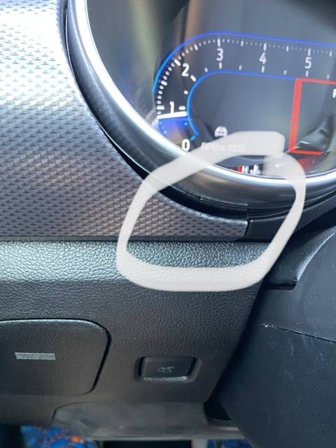

The area circled has some play. I hold it in and no more rattle noise. For me it’s the Chrome bezel also.

I dismantled everything and put a lot of foam behind cluster and also tucked some paper between chrome bezel piece around cluster and no more rattling. Thank God. It was driving me crazy.
