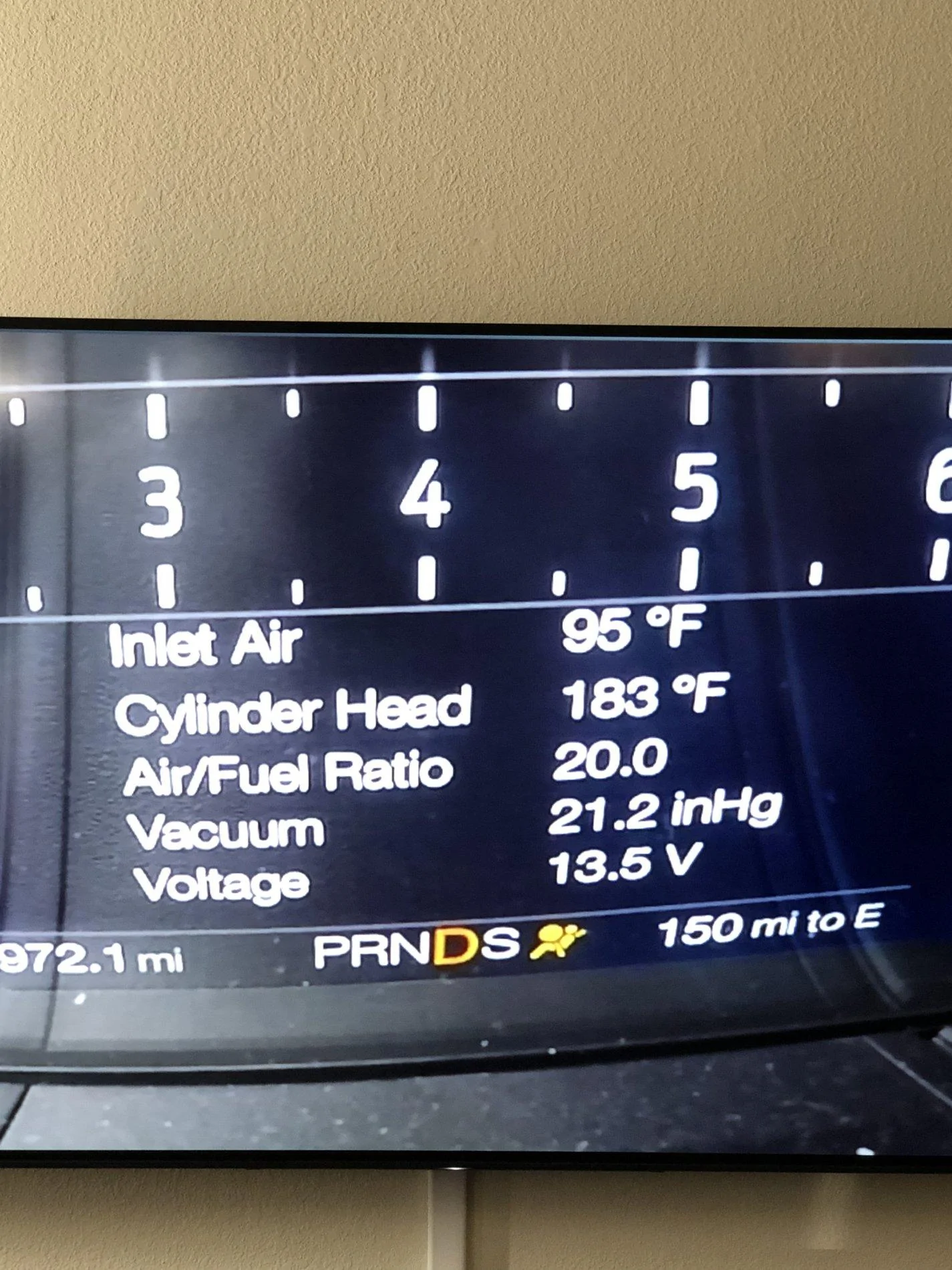

on my digital dash I have no problem picking and choosing the gauges that I want to see, but my question is, how do I get it to show as text?
I’ve seen people can do either gauges or keep scrolling down and they can have for example inlet air temperature, cylinder head temperature and all the different values read as text. I’ve tried to follow videos, but for some reason mine will only show the digital gauges. I’ve attached a picture of what I am trying to get it to look like.

After selecting my three gauges and hitting the pony button to go back to the main screen I see the gauges but if I scroll down I just cycle through the different gauges and eventually a lateral g force meter before starting over again.
You have one of the earlier released firmware versions that scrolls through 3 pages of gauges, a lateral gforce display and a blank screen then repeats. You probably also have an oil temp gauge although can’t choose it as a preselected gauge. You can go to the dealer and have them upgrade the firmware which will give you the line gauge display but will remove the oil temp digital gauge and the ability to scroll through the rest of the gauges.
That explains it then! Thank you and everyone else for your help. I’ll stop by the dealer and have them update

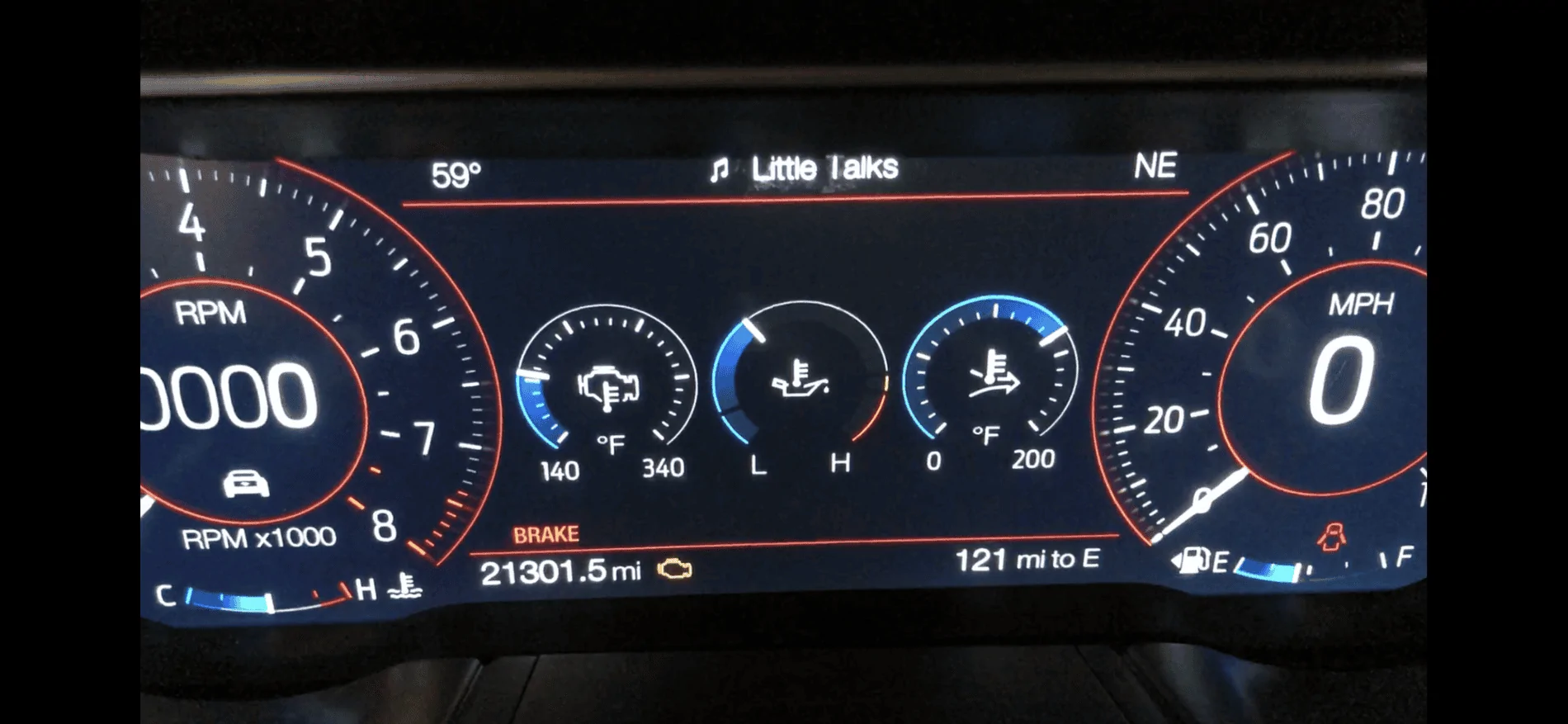

Here is a shot of mine......I have no intention of upgrading my firmware. While the oil gauge is nice, I appreciate the ability to scroll through all the gauges with the up/down arrows on the steering wheel at will.

Mine looks exactly like what’s posted. I don’t mind I just don’t know how lol.
