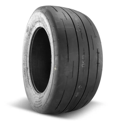

You need better rubber not wider if you want to stick. Drag radials are about your only option. ET streets will work pretty good.

wow quite an outpouring of support for Mickey's ET Streets on here, i'll have to give them a shot on the strip for sure. How street-able are they though? If they cant handle rain whats the best i can do that can? Overall I'm looking to get as much performance as possible while still being able to daily it (jack of all trades is a master of none, i know).I planned on having an extra set of wheels for the strip, I'm just currently more interested in what i can do on the streets (because when you spin shifting into 4th the fear of corners becomes real)

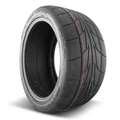

They’re not great in the rain. If your looking for a more street than track tire. Try the nitto 555R. They are still a drag radial. But they have a lot more groves to move water out of the way. Compared to the M/T.

These. Swapping out my 315 555g2 for 305 555r in the rear. Hook and not a death wish in the rain :)

I run 305/35/20 Nt555r’s in the rear and they hold well under 700whp. Over you need a sticker tire. Also, while the will do better in the rain than ET’s, they still suck when the road is wet. You gotta be really careful when the roads are wet with any DR.
