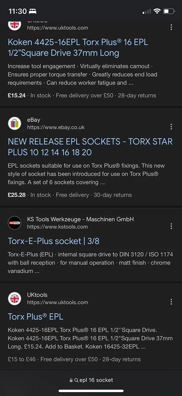

They are easy to source over this side of the pond :
Looking at the above, would it help if you searched ā€˜Torx Plus’ ?
I swapped mine out for flange headed stainless steel so I’m now on a standard hexagon socket.
WD :like:

Thanks! Koken has USA distributor and I just ordered the socket. Thanks again
