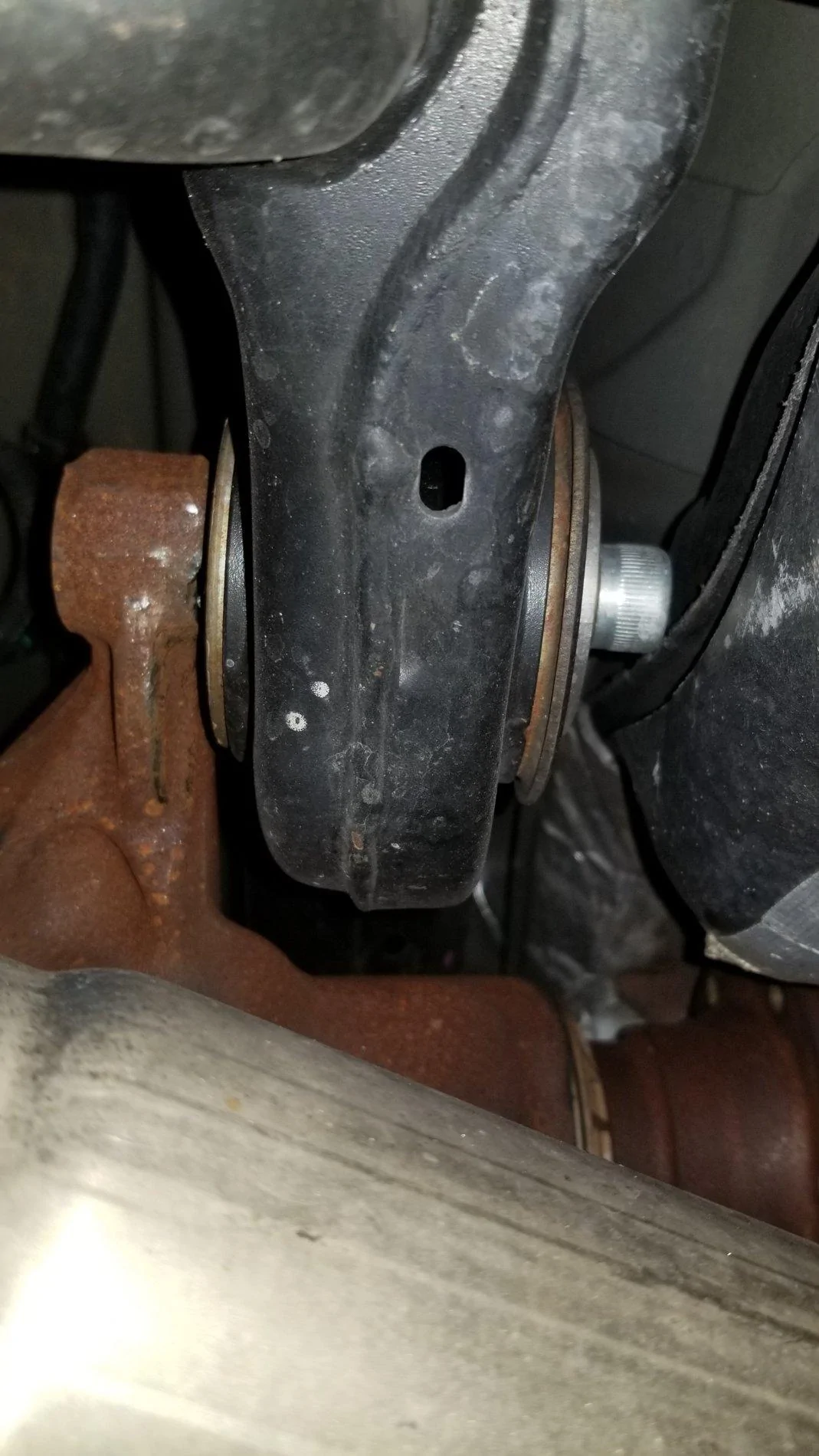

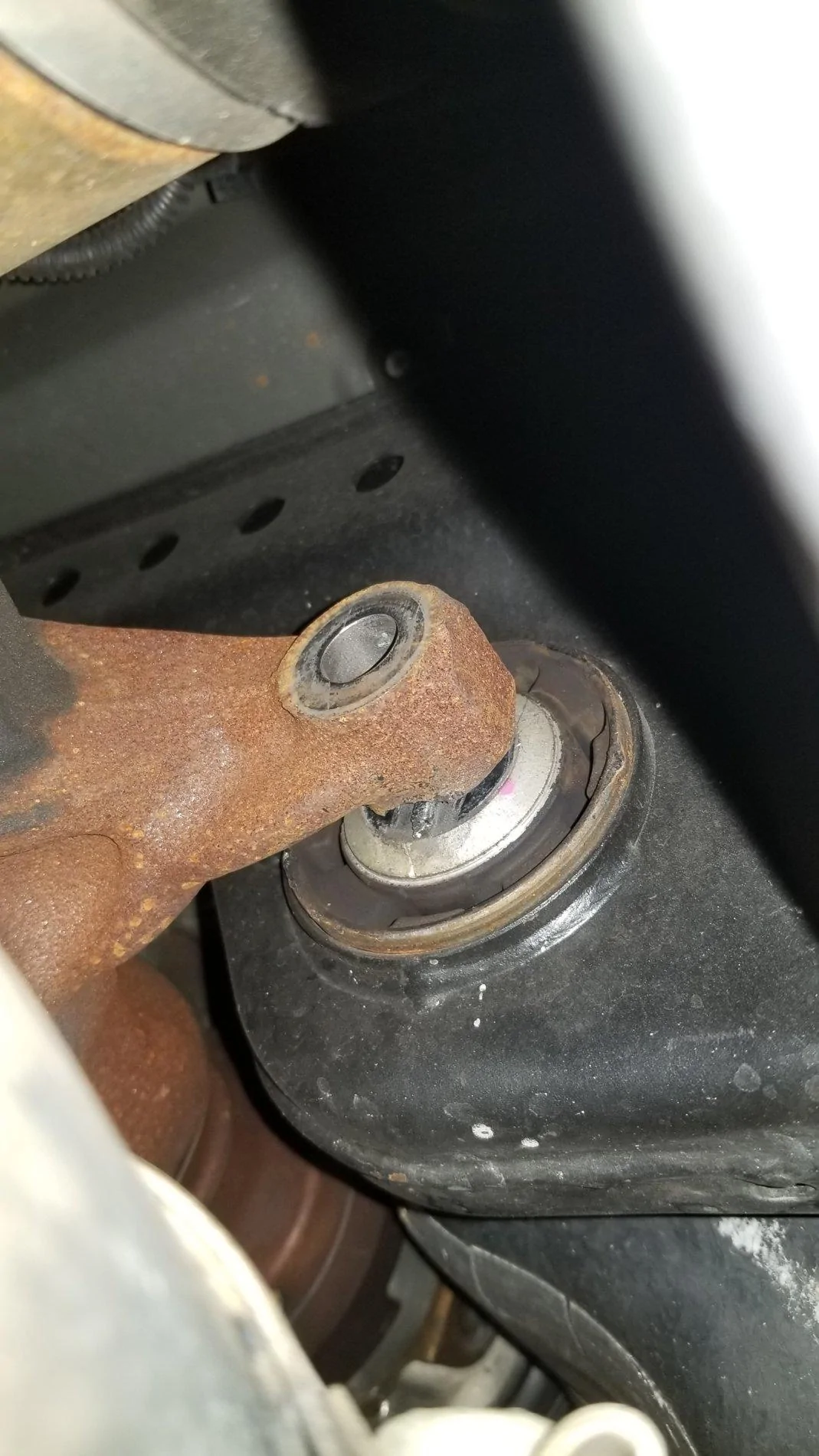

Broke diff bolts doing a 60 roll. 3rd to 4th gear. No wheel hop. Shifted to 4th and it broke. Bk051 with the upgraded hardware bolt kit and it still broke smdh. Spoke to BMR and the recommended the BK054 with the upgraded hardware bolt kit. Has this happened to anyone else with the upgraded bolt kit. What kind of diff bolts are your guys running? Thanks
ATTACH=full]393904[/ATTACH] View attachment 393904 View attachment 393905 View attachment 393906

I'm not seeing your pics. You broke the RH017 12.9 grade bolt kit?

This has happened to me before. Why does this keep happening? Is the diff flexing during hard shifts? Breaking the bolts during shifts? How do I keep the diff from moving? I'm thinking the shop didn't torque it down to spec? Is that a possibility?

I think the diff was moving under hard shift. How do I prevent it from hard shifts? I'm really not looking forward to the
use the correct shank bolts. Or shim to correct size. You *never* rely on fastener torque to limit movement in an oversized hole.
I'm using the correct bolts..it fills up the hole.
every hole? Or just the diff bushing? I might be mis-remembering but I swear I saw some pics where the holes in the casting were oversized.

Are you still using the stock rubber bushings? If so thats the reason why you keep breaking bolts. You need a stiffer bushing to share the torque load...
I'm using the BK051 bushings from BMR and the bigger diff bolts from BMR. I also have the BMR vertical links and cradle lockout
