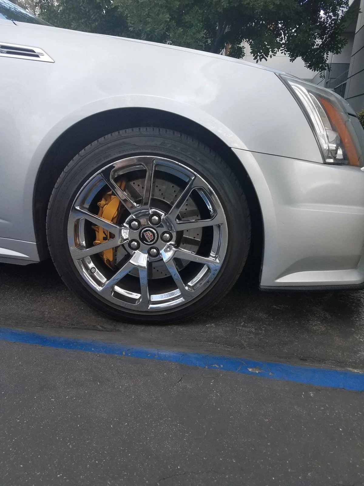

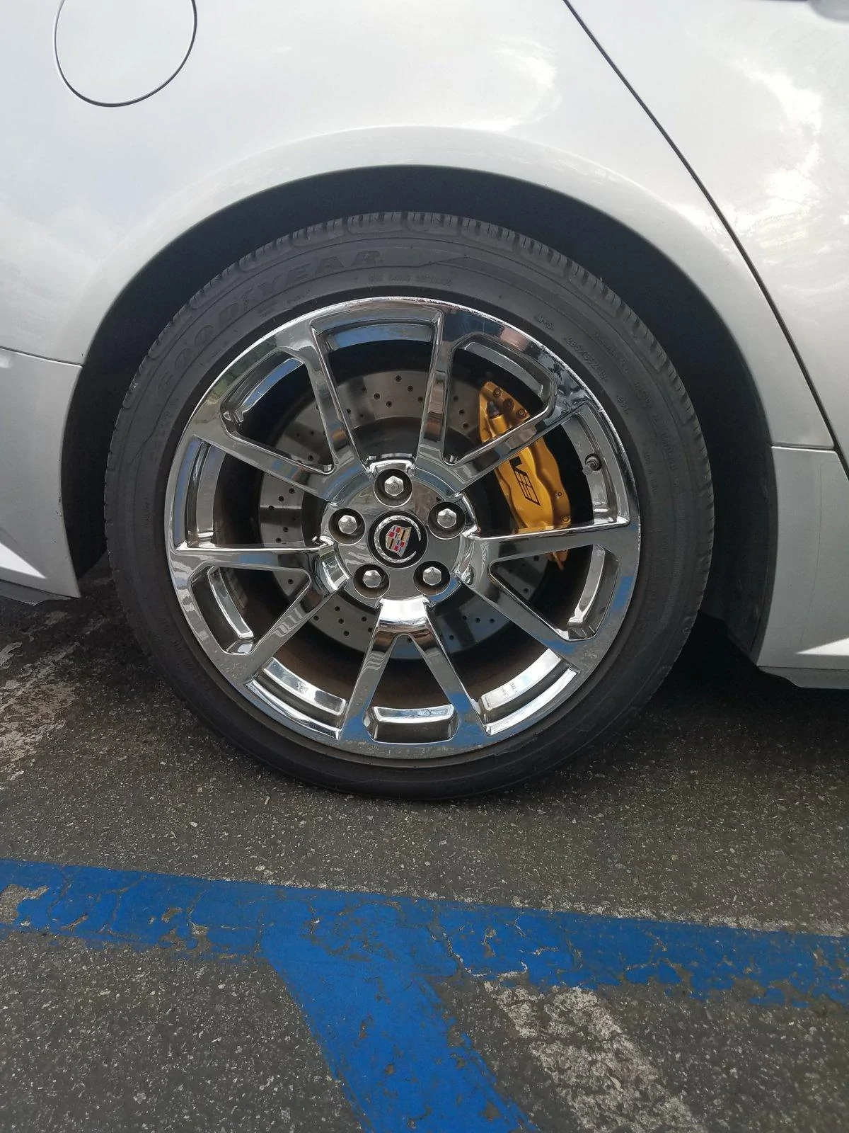

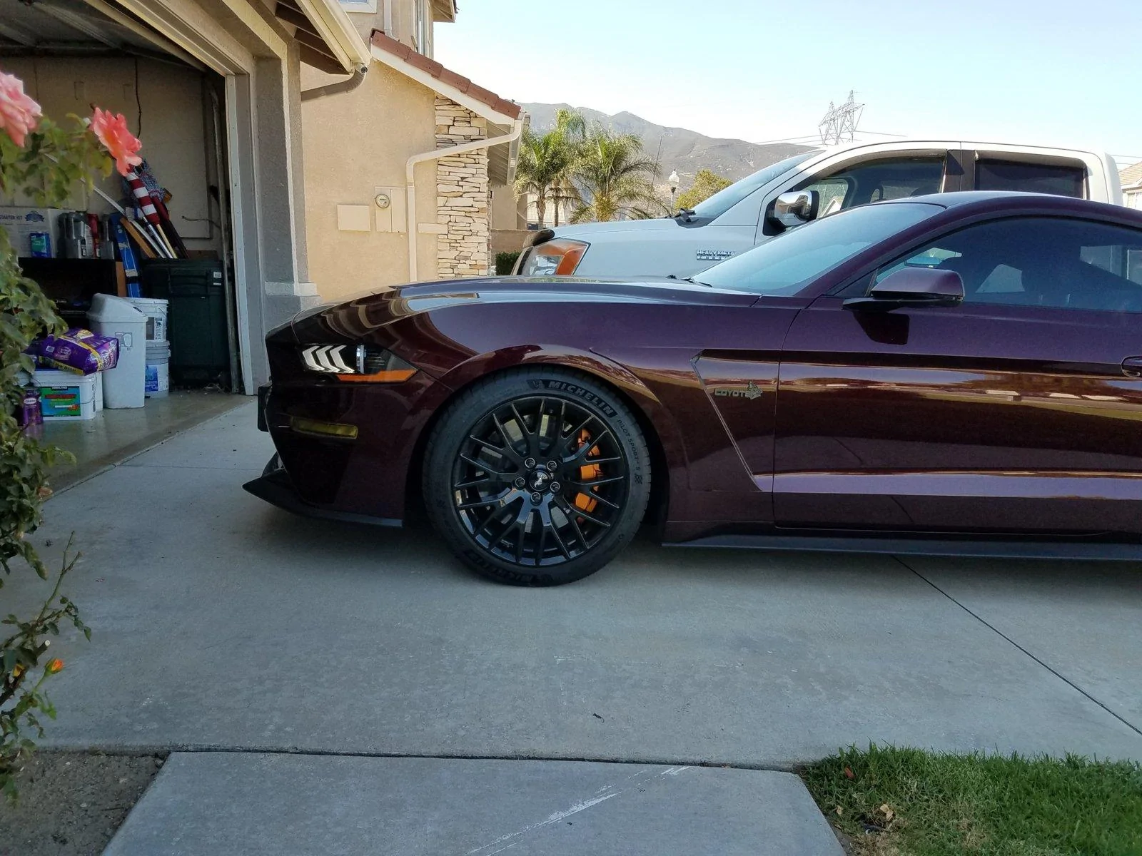

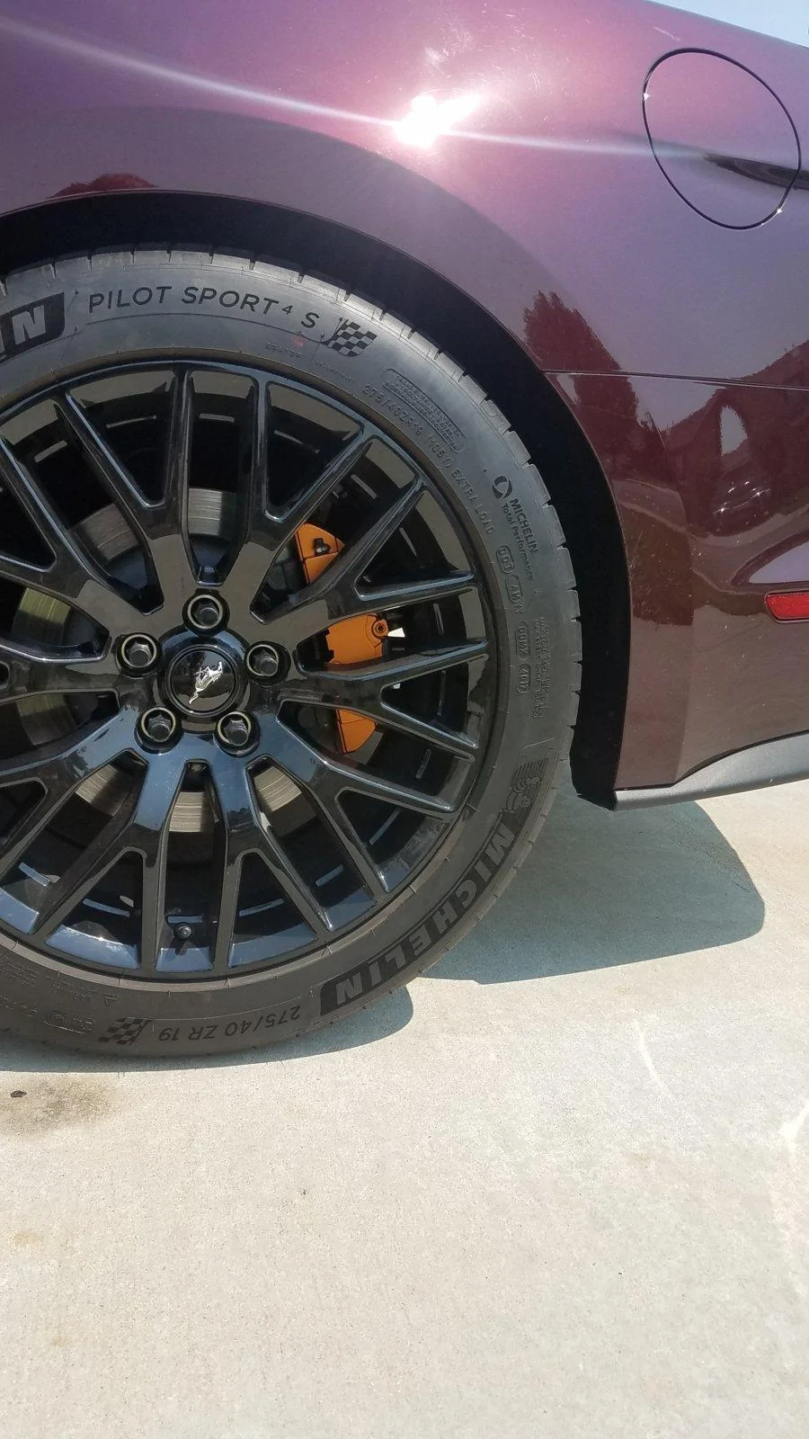

The first pics are the calipers on my CTS-V. They were painted over four years before I took that pic. They lasted so long that I used the same paint and method on my Mustang. Use the right paint and good prep and they will last as longer then you want them too.

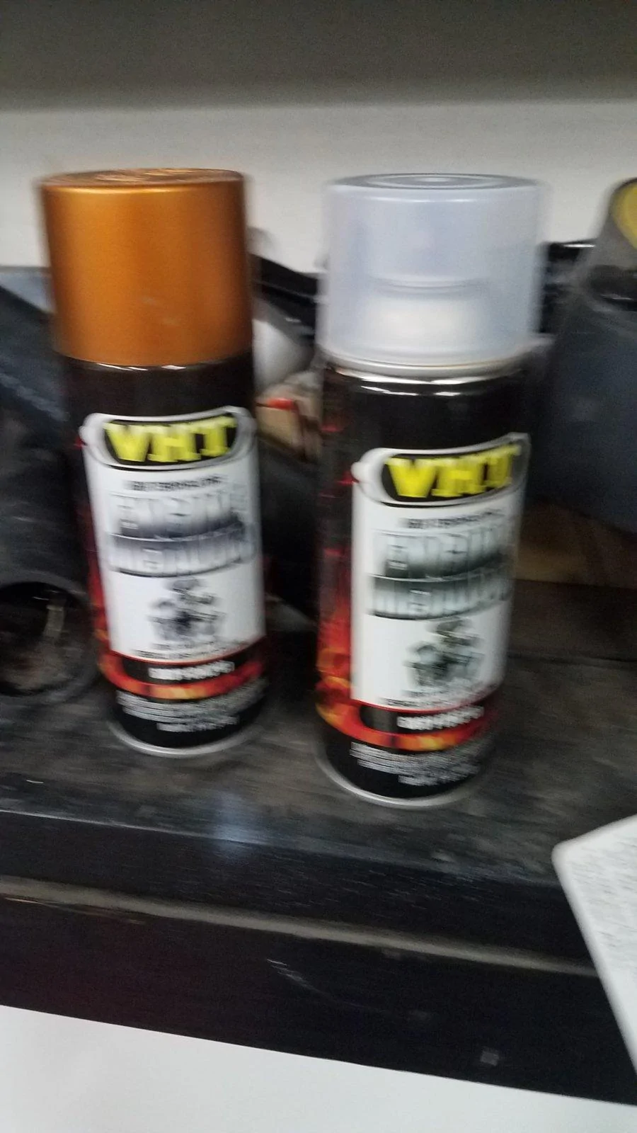

1.Clean the hell out of them with soap and water, 2. Scuff them up with a scotch brite, 3. Clean them again. 4. Paint them with as many coats as needed to get a good even color coverage with about 30 mins drying time between each coat. 5. after applying any decal, clear coat them with between 3 and 5 coats of clear. DISCLAIMER: This will not hold up to track use. That much heat will over heat the engine paint I used.
