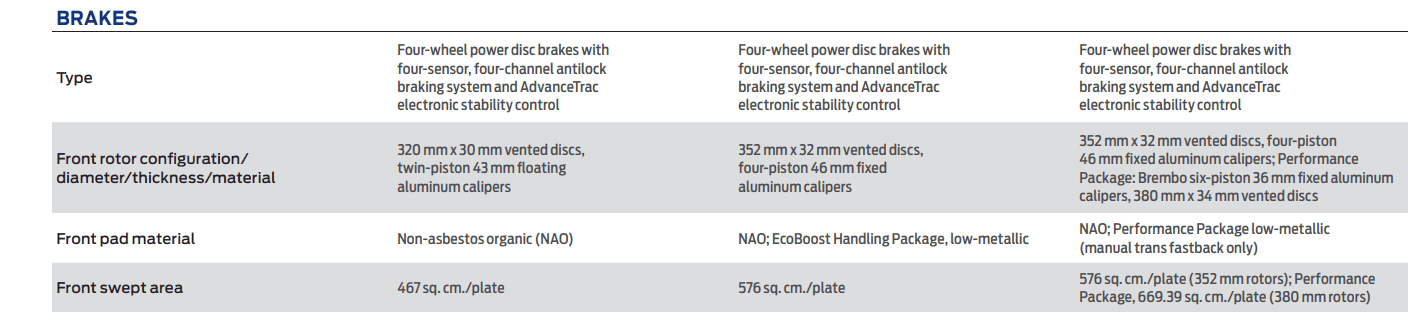

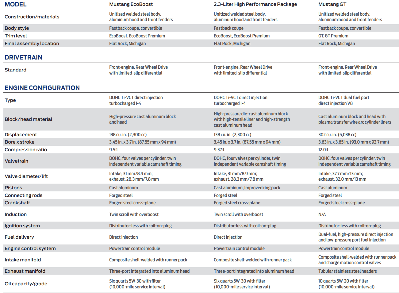

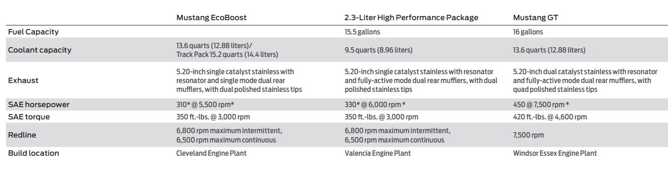

Australia gets the "High Performance" version, which, apart from more power, also has bigger brakes, and thicker sway bars to the standard EB. You can draw your comparisons below.
Our cars lost a couple of KW due to the difference in Emissions Standards to the US - and the Euro Cars lost even more due to the extreme Green Nanny Nazis.
However with Bidens new tighter "Green" Envio standards applying to the new S650 / MY24 Mustangs, we might end up with the same power ratings as the US cars - although at this early stage, they seem to have dropped the H.P. EchoBoost I4.
This is for thr MY22
2022 Mustang Tech Specs (ford.com)

Cheers. That answered my question around power output. Looks like emissions laws is the reason.
