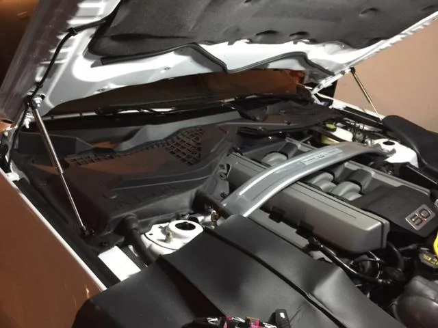

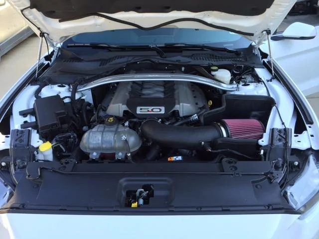

Started off installing my Redline Tuning Elite Struts:
These things are nice and super easy to put on. They work perfectly and I love the stainless finish. Thanks Redline Tuning! I took off the decals however. Since I am old school and keeping the chrome 5.0 badges, I think they look pretty slick.

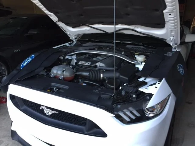

Next, we started getting ready to take out the airbox, Sountube and then install the 170 Thermostat to go with my Lund 93 Tune via NGauge!:headbang:

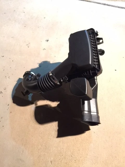

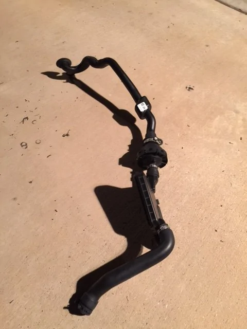

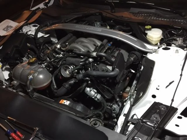

These things came out! Plugged the firewall with some recommendations from other forum members of the Ford Master cylinder gasket only to find out later JLT or BeefCake put a plug in there! :doh: Oh well, if the one I used falls out Ill use the supplied one!
Ready for thermostat.

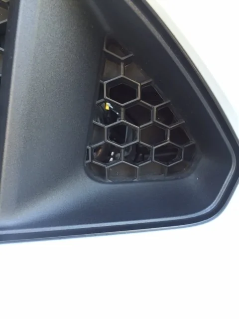

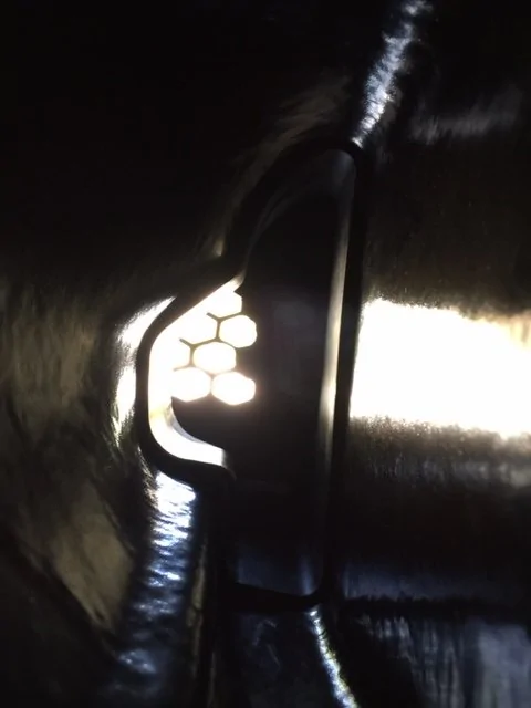

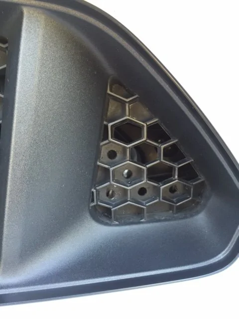

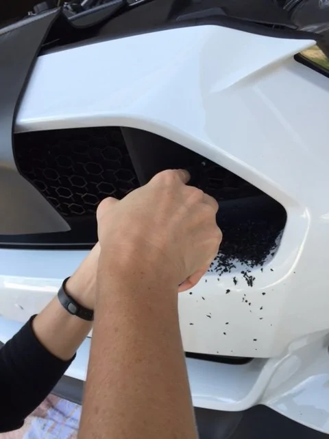

Once the thermostat was in, decided to open up some holes. I pre-drilled the ones I wanted and then had my wife do some fine touches with a small dremel to make it look clean. (NOTE: holes and thermostat seem to have made a HUGE difference in head temp and IATs for me. I was very very pleased!)

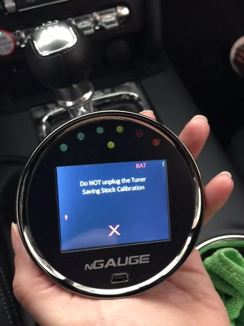

Then it was time for the NGauge and uploading the tune from Lund! I had my wife take care of the PC stuff...(I hate computers and I was a little nervous about the tune as I am from the foxbody days and this new "tune" stuff is so foreign to me.)
Anyways, the Tune from start to finish was an absolute breeze!!!! Only took maybe 15 minutes and I hit the start button. Car started up right away and ran like a top!!! No lights, no funky gauge issues..NOTHING! I then let the car idle and did all of the coolant top off and got ready for a test drive.:thumbsup:

What's the 170 thermostat for?
Sweet job, looks nice!
Tele5.0
Tele5.0
Oct 28, 2014
489
74
"The Pearl"
2015, PP, GT
Hey Thanks!!:cheers:
The thermostat is recommended with the tune. I think its mainly to keep cylinder head temps down and help with pre-detonation. It also keeps the fans from running so much.
