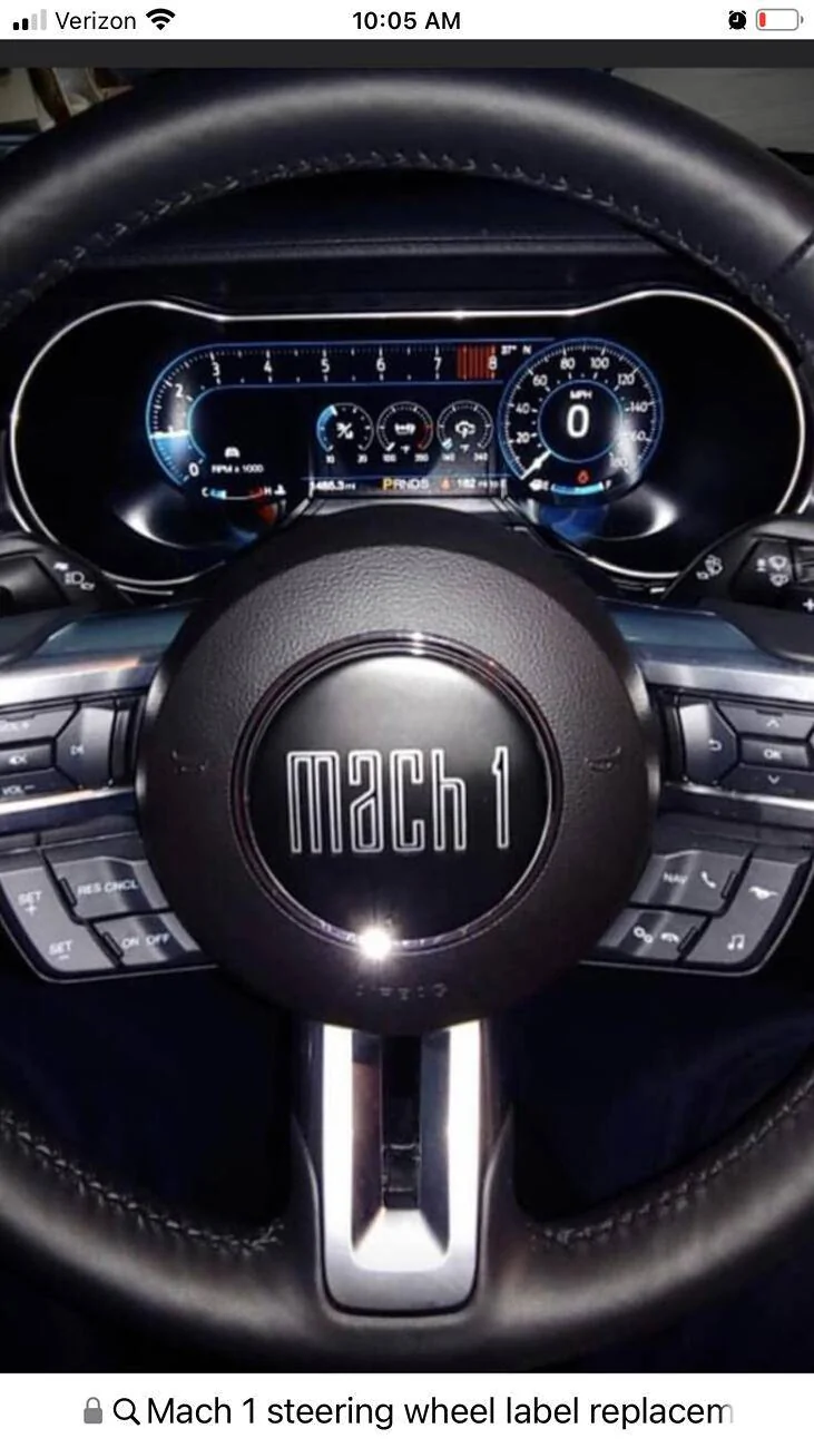

Now it’s time for the Mach 1 overlay on the center of the wheel. I don’t know why Ford left the pony there on the Mach 1.
Love it!!!!!!!!1 Where did you get it? I need 1 for mine. =)
Thanks Anthony
That came from Badge King they make a bunch of stuff for cars and trucks. The one in the pic is from their site. I have the same one on my car. It’s a perfect fit and not a piece of junk. Once it’s on you’d never know it wasn’t from Ford. Also goes over the pony super easy. John
Oh very cool, Thanks John!
