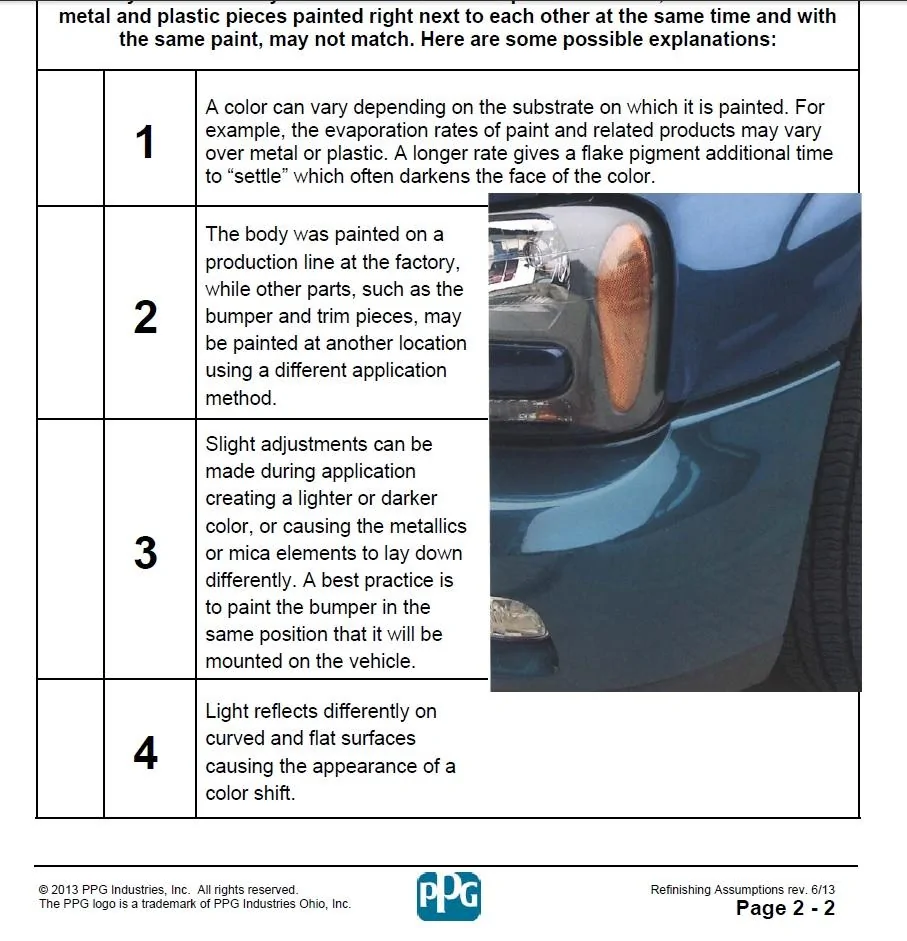

You just need a new shop. I use to do this for a living and gave up on painting because I was not good at it. I could do an all over paint job as good as the best in the industry. But when it came to matching metallic paints, my work looked like yours, and I knew I didn't want a career of pissing people off. The guy that replaced me (I moved over to bodywork only) could mix/match and shade paint in his sleep.
No excuse for this other than an inexperienced painter. he might have the metallic as called for, but the wrong pressure at the gun. It does make a big difference.

I'm really surprised they didn't blend it. Putting different panels together like that with different paint is not going to match.

There should be no issue matching that color. They need to bump up the pressure to 20 on an hvlp. The flake is missing.
Painting plastic parts always leaves the color off a tad. Yours looks like more of a mica or "metalflake' issue.
The best way to catch a better match would be to cut the end of the discarded bumper off with an air saw and use it for a spray out panel. Then you can snap it up into place to check the color against the vehicle.

As i advised earlier i didn't think it would match. Metallic colors are extremely difficult to match. You'll likely need to make a big issue about it at this point to get results you

The only body work I had done on my 2007 Redfire Mustang was the hood replaced due to a hail storm. The new hood had a good color match I think but it had quite a bit of orange peel. The factory finish was like a mirror. I know that won't apply to a plastic bumper though....but whenever cars are painted after the fact its never as good as the factory robots. It could be 98 or 99%....

I don`t give a sweet rats a@# if your Body Shop has a painter named Picasso, unless he`s painting the entire Vehicle, matching exactly a metallic paint after a Factory finish is simply a crap shoot. A repair is a repair, it ain`t like a Woman putting on and taking off her make up with Cold Creme. On a brand new Vehicle, I wouldn`t except delivery unless it was mid-day, sunny, and I gave it a good walk around. Buyer beware!
