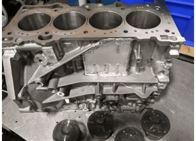

Curious. So why the 2.0 block?

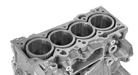

The 2.3 block has 2 major issues that can lead to a cracked block (ECOBOOM) IMO.
The 2.3 is an open deck which is structurally weak, where the 2.0 block has a semi-enclosed deck. The other issue is the external area between cylinders 2 and 3 is thin and prone to cracking once you start trying to push more power.
This is why all the pro tuners limit the stock block to 400hp, but IMO it's still a ticking time bomb. I have heard good things about sending the 2.3 block off to https://cylindersupportsystem.com/ for their CSS system and added bracing, but at the tune of $635 (doubt that includes shipping).
Where as you can grab a brand new 2.0 Fusion block from Tasca for $800 and it's nearly identical to the 2.3 block, but without the inherent weaknesses. You can build it up with all the internals 2.3 internals and all the other parts mount up perfectly.
people have been pushing 700 hp + with these blocks, so they seem to be able to handle anything you can throw at it.
Although, even with a built proof block, the cylinder heads apparently flow like junk which leads to the next major issue with this platform- head lift. Speed Performance has a great youtube vid on this
I've heard that even with advanced porting they still are underwhelming.This is why SP created some super strong head studs that I picked up for my build.
Right on. Now I'm just curious how the 2.3 internals are gonna fit in the 2.0. That is unless they are simply honed out.

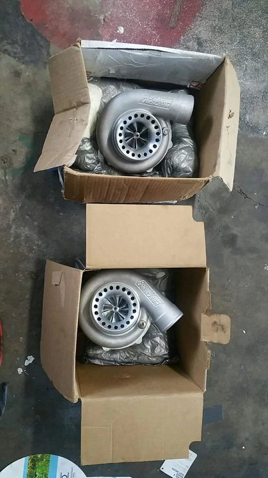

big turbo kit should be mounted up this week! just need to add in port injection to make her a 550hp monster
just picked up a 5858 to swap out the 6262

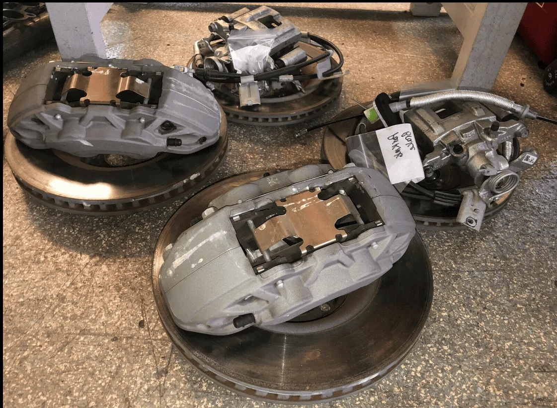

Also found another score on Ebay for a full GT brake set for $300.
my lord that thing is going to SCOOT. I'm hyped as can be about this build.
