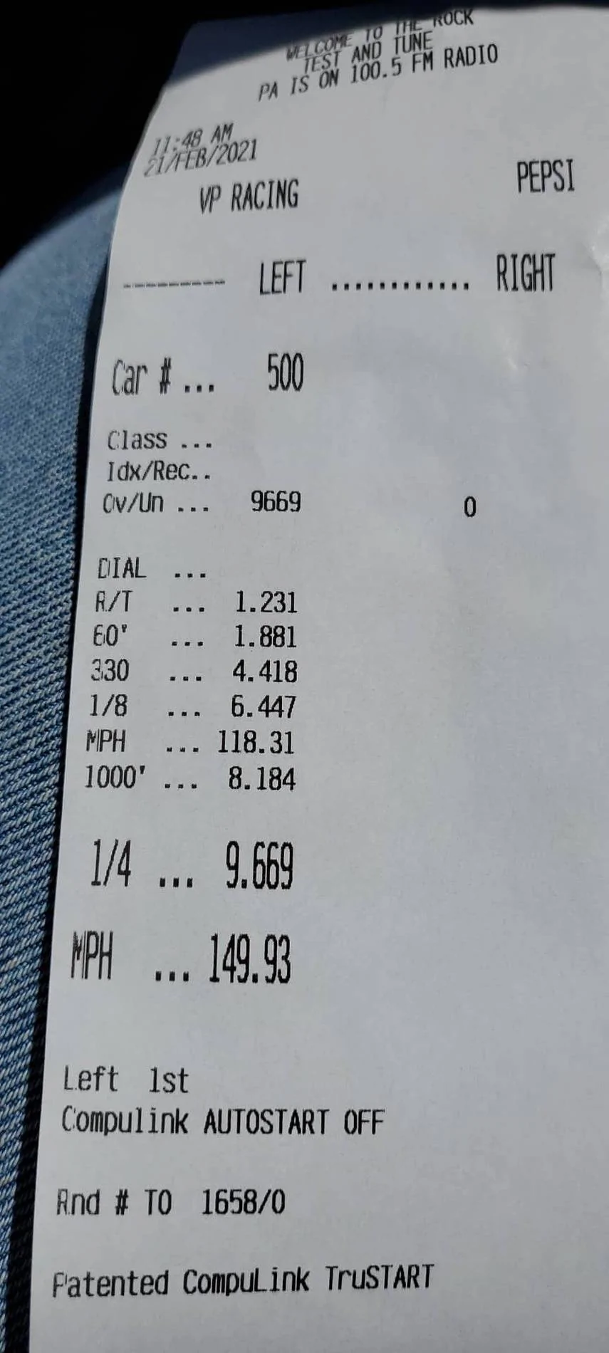

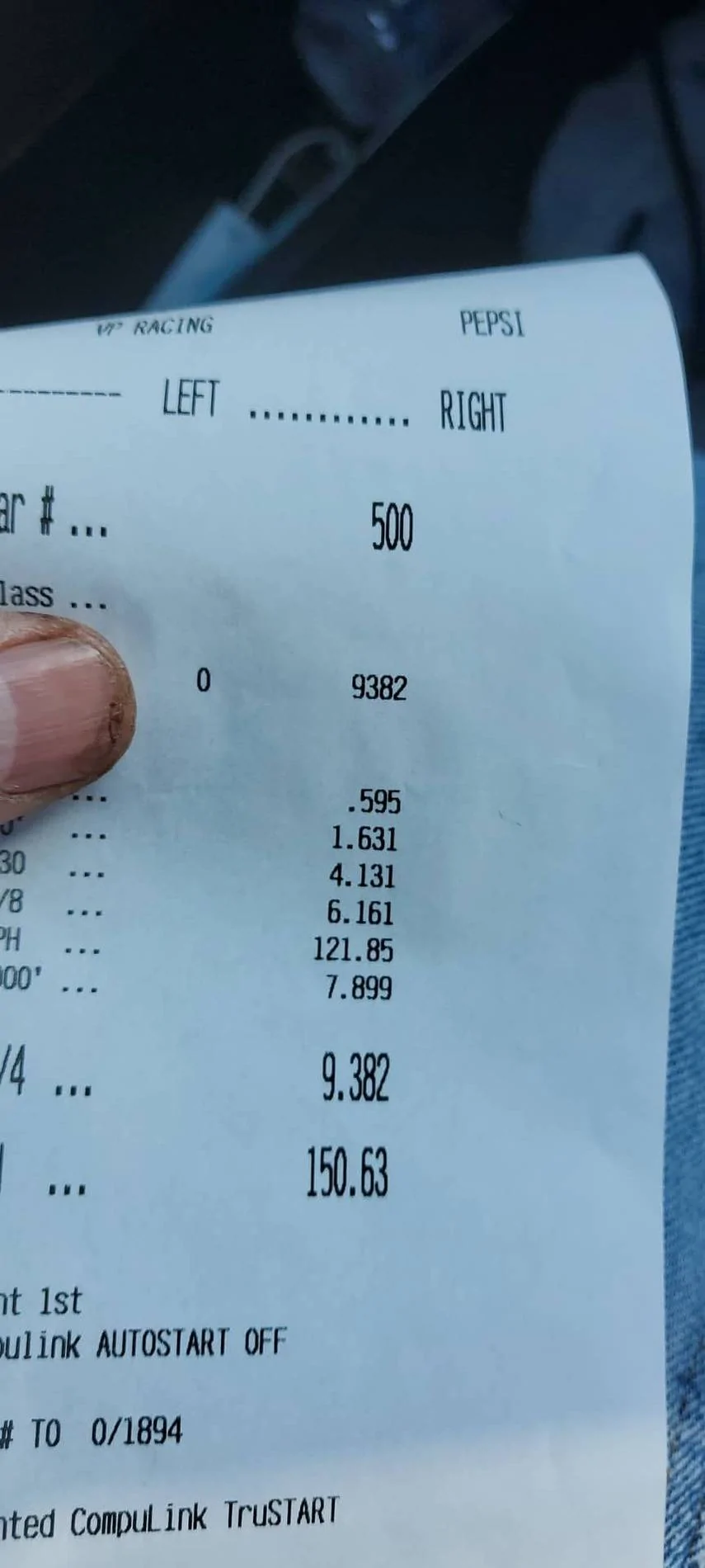

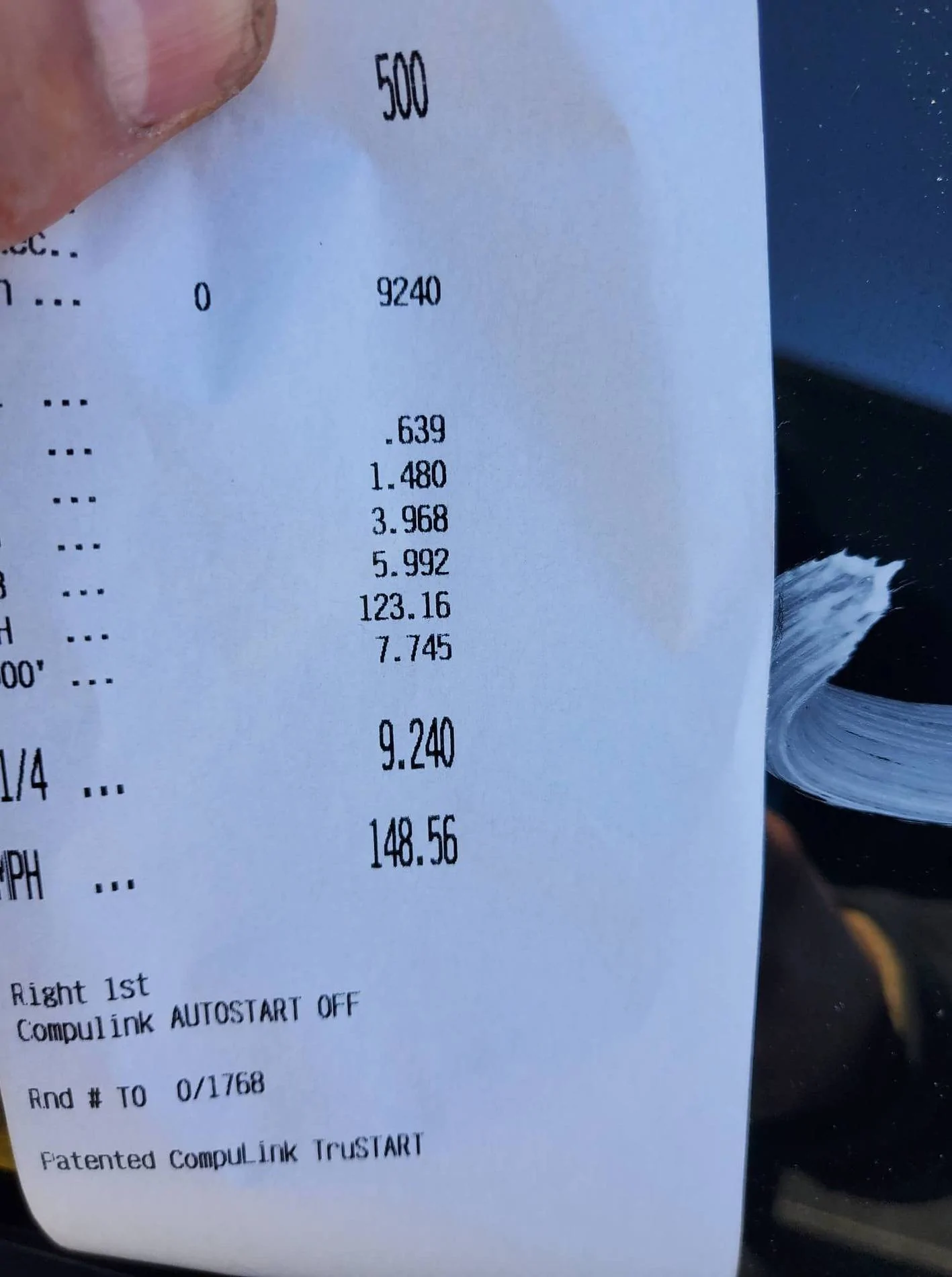

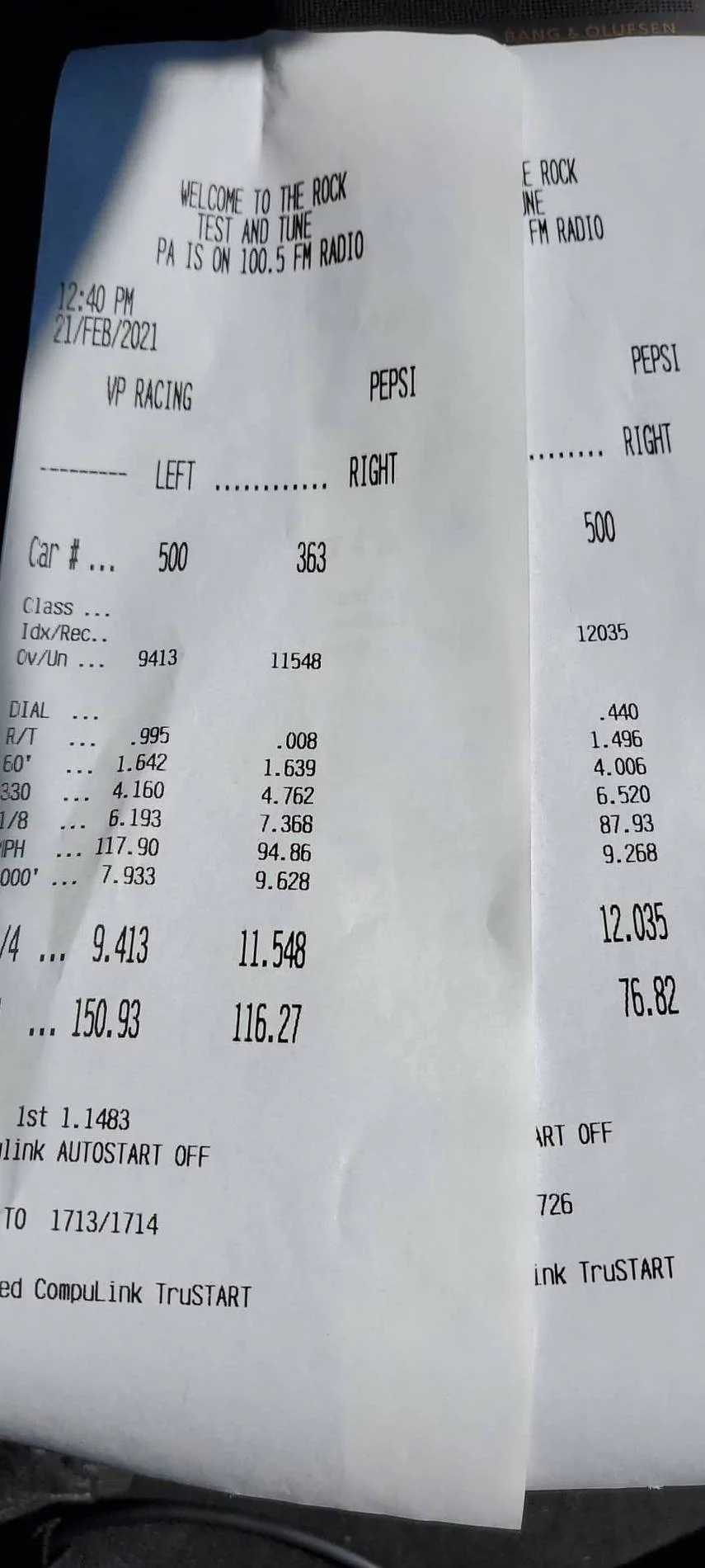

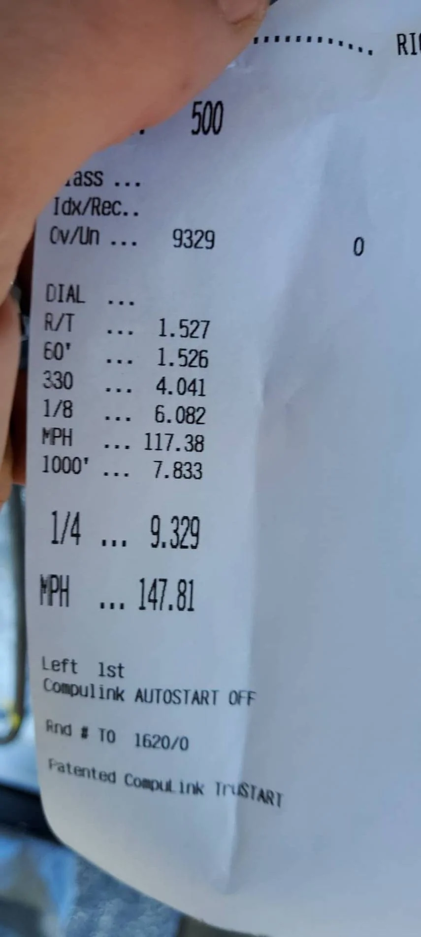

Had a decent track day last weekend. TCM tuning has finally become available (partially) which is what I needed to start taking advantage of the upgraded SSP DCT clutches. Prior to this, and even still somewhat, the clutches are doing such a good job, it was pulling RPMS down causing sever bog. Previously on launching at 3200 rpm, car would bog to about 700rpms, and then on the gear shifts, drop by about 800 rpms.
For now, thanks to HPTuners, the launch is about on point/ back to OEM levels, and the gear changes are only down about 400rpm. Plenty of room for improvement as more tables are opened up
Unfortunatley, belt slippage became apparant immidiatley. My combo should be seeing 22-23psi, but was erratic and moslty 17psi through the runs. Ill be hitting tracks again in about 2 weeks, and the boost issue should be rectified. Car is 100% full weight, and probably even over with some of the additions. at SCT Bradenton, car weighed in at 4390 with me in and full tank
