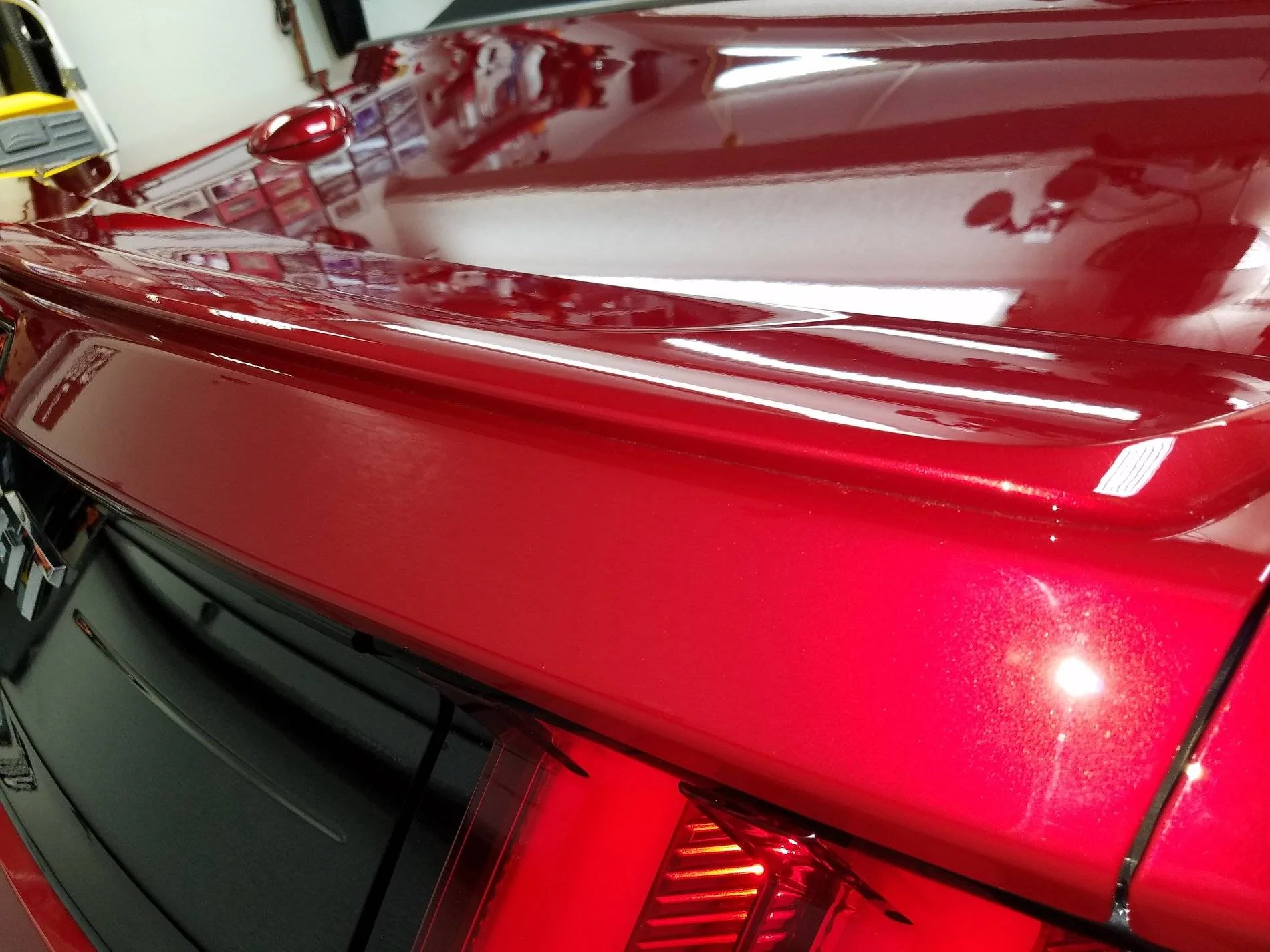

How is this spoiler attached to my 2020 GT Premium? I'd like to install one that has some level of function, unlike this one.

Its held on with bolts and tape. Access the bolts from the underside. And scrape the tape off. Its easier if you use a heat gun.

Using a heat gun to loosen the tape will work but if you’re still having issues separating the wing from the trunk lid - get a length of either dental floss or fishing string and pull it between the underside of the spoiler and topside of the trunk lid using it to separate the spoiler from the lid.
Clean the topside of the trunk lid to remove all the prior adhesive before installing the new spoiler.

What worked for me far better than a fishing line, was a simple cutter knife. Remove the screws, put some tape around the wing to protect your paint, and then try to separate your wing from the deck lid. You will see the tape expanding and simply cut the tape with your cutter knife in the middle without damaging your paint. After the first couple of inches you can use a plastic prying tool increase the gap even more.

I did the exact same thing on my 2018 GT. I just parked the car in the sun to get it nice and warm which softened up the tape. I removed the nuts. Then I just lifted the wing from one side, rocking gently front to back, giving the tape a chance to let go as I worked my way across. Then I just used my fingers to "roll" the old adhesive tape off the finish. You may want to wear gloves if your hands aren't used to rough work. The instructions that come with the new spoiler are excellent. Just follow the sheet that comes with it. The whole thing took about an hour. I hope yours goes as easy as mine. Good luck. I hope you enjoy.
