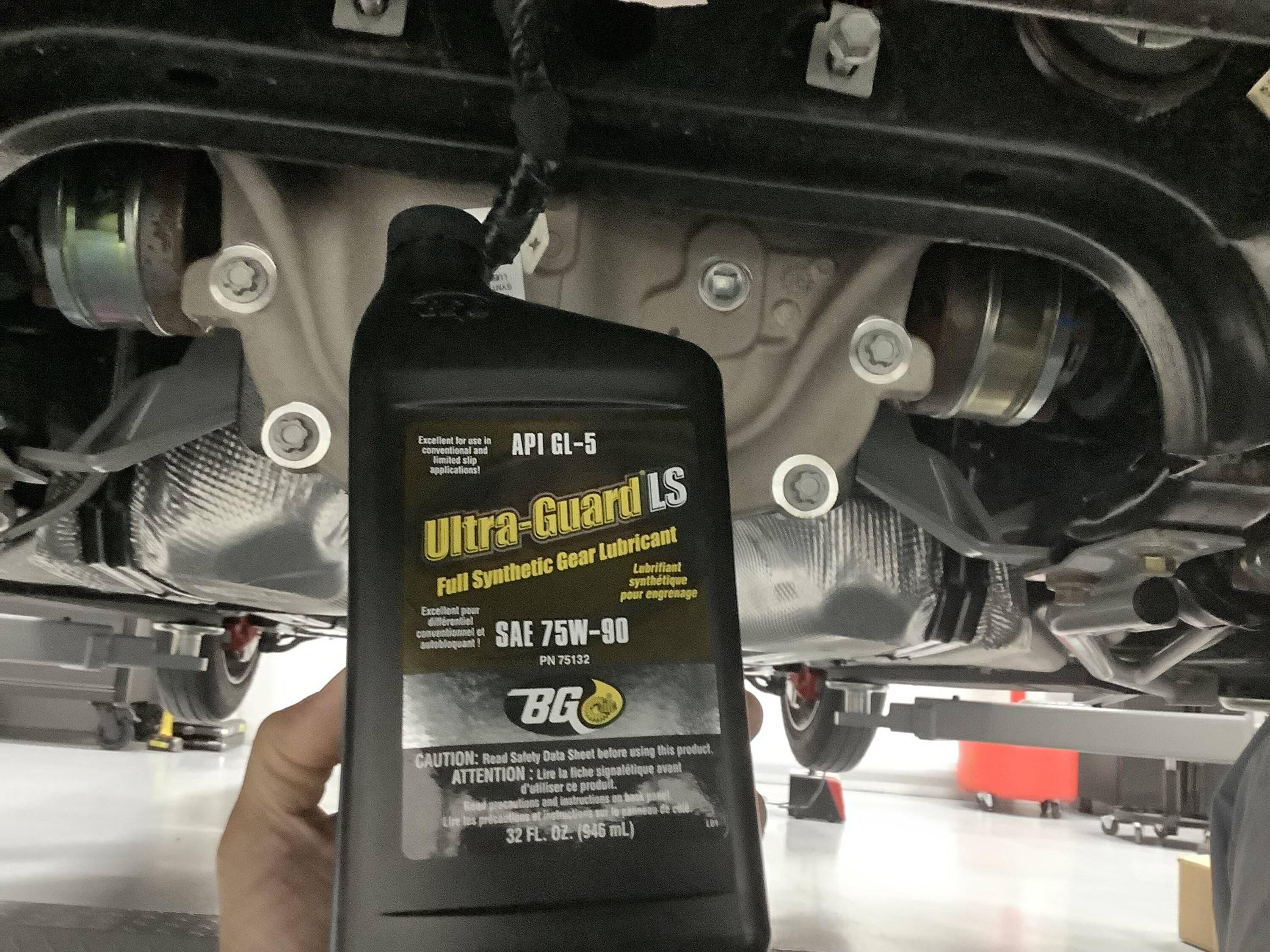

I donā€˜t know if it’s any better, but I run this in mine. I don’t have very many miles on it to give a good review though (only about 200-300 before I started working on the tranny). I also run BG Synchro Shift II in the tranny.
Most guys seem to really like that stuff. Most people probably wouldnt even notice the noise i currently have but now that ive noticed it, i cant ignore it lol
It’s cheap enough to try. Give it a shot and see if it helps.
