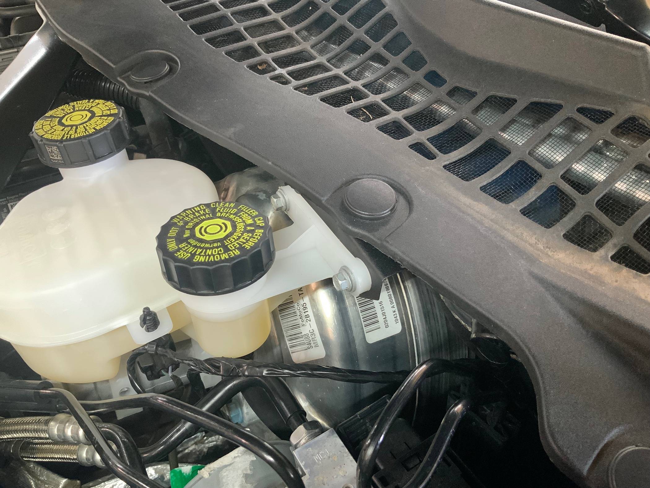

Debris in Brake Reservoir

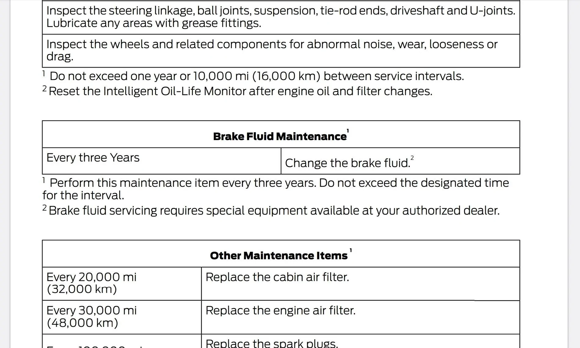

The manual recommends changing the fluid every 3 years for normal driving.

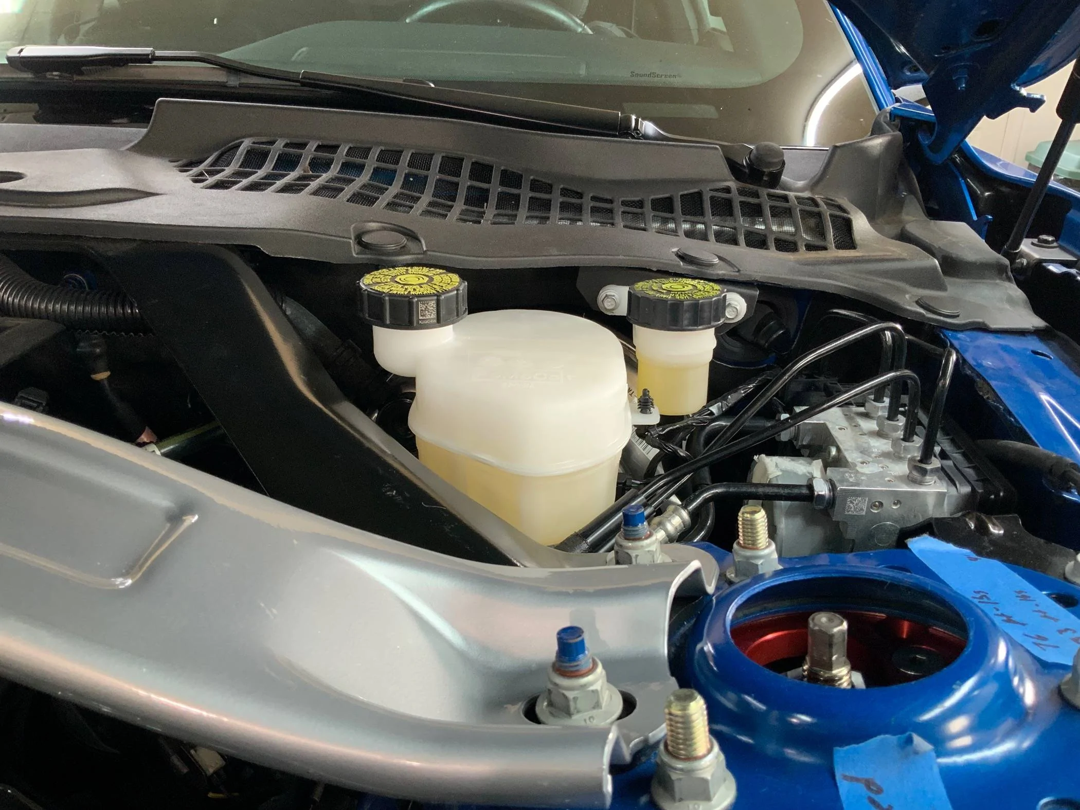

Is the car a manual?
If so then I’m sure it’s because the clutch master cylinder and brake share the same reservoir. Clutch fluid gets dirty like that. That is one of the reasons some divorce the brake and clutch reservoirs. It keeps the brake reservoir clean. I divorced my systems and my clutch fluid looks the same while the brake is clean. It isn’t “bad” but clutch fluid change is done as routine maintenance every few frack days.
