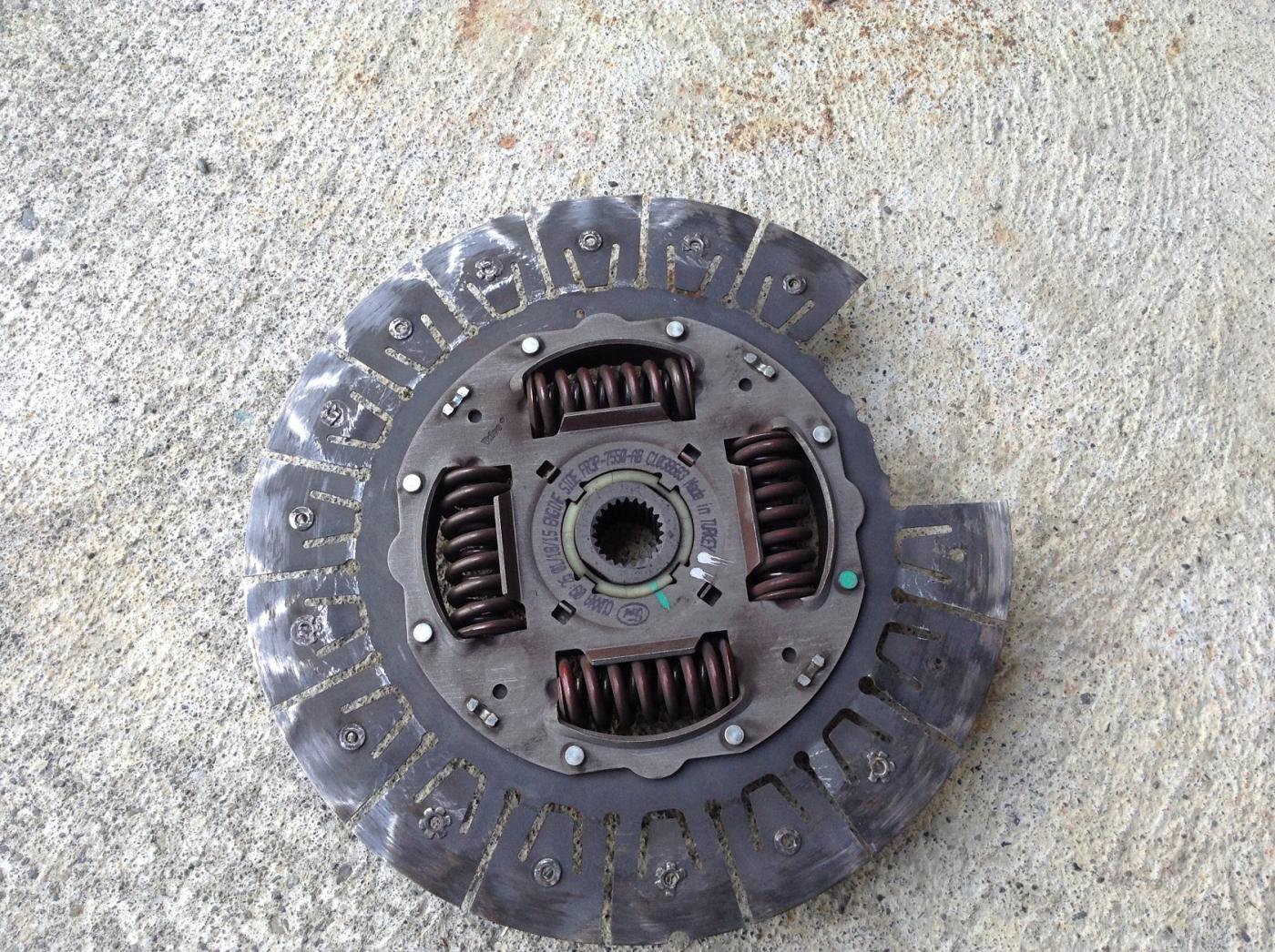

Never heard of a slave cylinder failing, but lots of clutches. Here is mine that went boom. Thing is, Ford will just put the same piece of sh1t in there and likely to happen again. I went with a McLeod RST
Stock clutch is horrible. Eventually I'll get something much better along with a TH400 trans.
