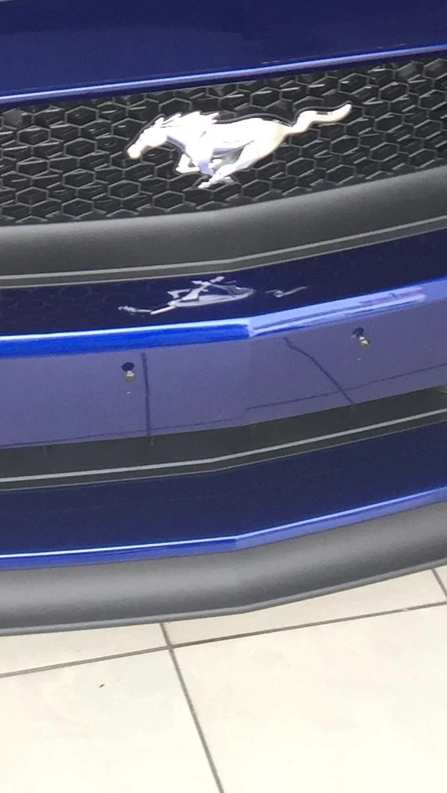

We installed in both our cars ourselves. Called dealer in advance and also sent email asking to acknowledge that NOT to install plates, period.
Went with a drill and 3 mm bit and installed in 15 mins.
In your car they don't seem to pre drill the holes. They just put the plates on and tried to use the scre to drill the holes and that's why they don't line up with dimples.
Whoever installed it never read instructions and used the standard method to install them.
Since screw supplied with Larkin plates are not self drilling he must have used another screw to drill the holes instead of a drill bit. You are lucky he didn't use a bigger screw to drill the hole otherwise the screw supplied with Larkin may not even hold properly.

They have used the Lakin screws so not sure if they drilled or just used a lot of force to make the screws into self tappers. One of the spacers is missing so maybe it flew off while they were driving them home at high speed. Surprised they didn't strip the hole out. Yet to get a response from them as to how this happened.

When you look from on top it stands out like dogs balls on a rat that it is not even centred . Luckily they were also too stupid to use the 3M sticky pads so it's easy to get the bracket off.

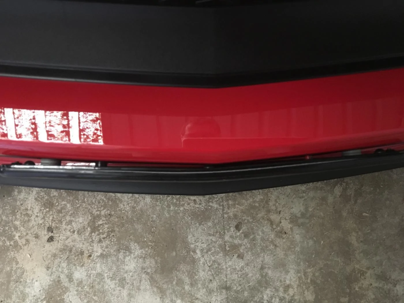

Not worth the hassle if it can be resolved by other means. Too much of a risk with a possible paint matching disaster IMO.
This is what I was confronted with at delivery.
No new bumper idiots
