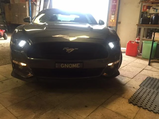

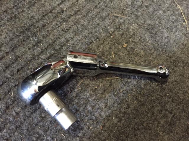

Finally after several false starts it is done. These are bloody awesome, changes the whole appearance of the front of the car in my opinion the crappy photo below does not do them justice. But after fitting them it is now clear the original incandescent DRLs and Parkers have to go, they just look dodgy with the led tri bars. First thought was just to disconnect them altogether, but now after looking at some pictures of what others have done, I think a LED swap out for them is the way to go and that will be a walk in the park after the DRLs. When I first looked at this idea I had no intention of having sequential indicators on the front, but when I saw them in action I giggled like a little school girl. I can see why DD added these, if they were just white they would have had a limited Aus \ EU market as the US already get that, but with the sequential indicators it would not surprise me if some people in the US go for these over the coloured ones, nice work DD guys!

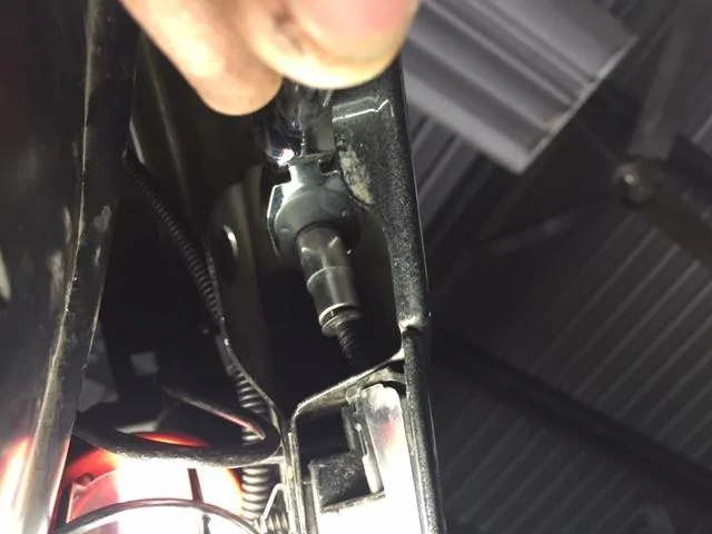

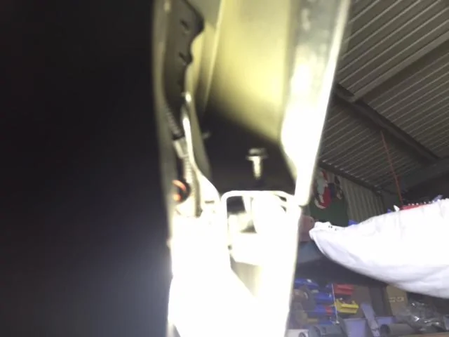

A tip for anyone removing the front bar for whatever reason. A stubby flex head 1/4 ratchet makes short work of that pesky 7mm bolt hidden in the wheel arch. After reading the problems some guys have had getting to that one I was dreading this, but with a bit of fiddling to get at it 30 seconds and it was out with the stubby ratchet.
A big shout out to [MENTION=20412]Banditvox[/MENTION] , for your advice, I owe you a beer or two.
Also [MENTION=20820]yellowpony[/MENTION] , for your input.
And one of the euro pioneers in this [MENTION=12253]papinist[/MENTION] , I read your write up on removing the front bar months ago.
And of course [MENTION=9987]Diode Dynamics[/MENTION] , for persevering with getting the kit right for cars that are different to the ones they have access to in the US.
Sorry about the crap photos, photography is just not my thing...

completely remove that cover from the wheel arch makes it a lot easier.

Nice one mate! So how did you get the bars in the headlights? Did you separate the lights or cut into them?
Gnome
Oct 14, 2015
457
529
Sydney , Australia
John
2015 GT Stang!
Cut a hole in the bottom of each light and with a bit of keyhole surgery put the led boards in place.
