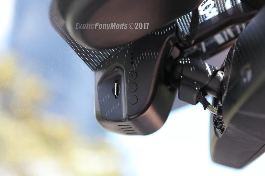

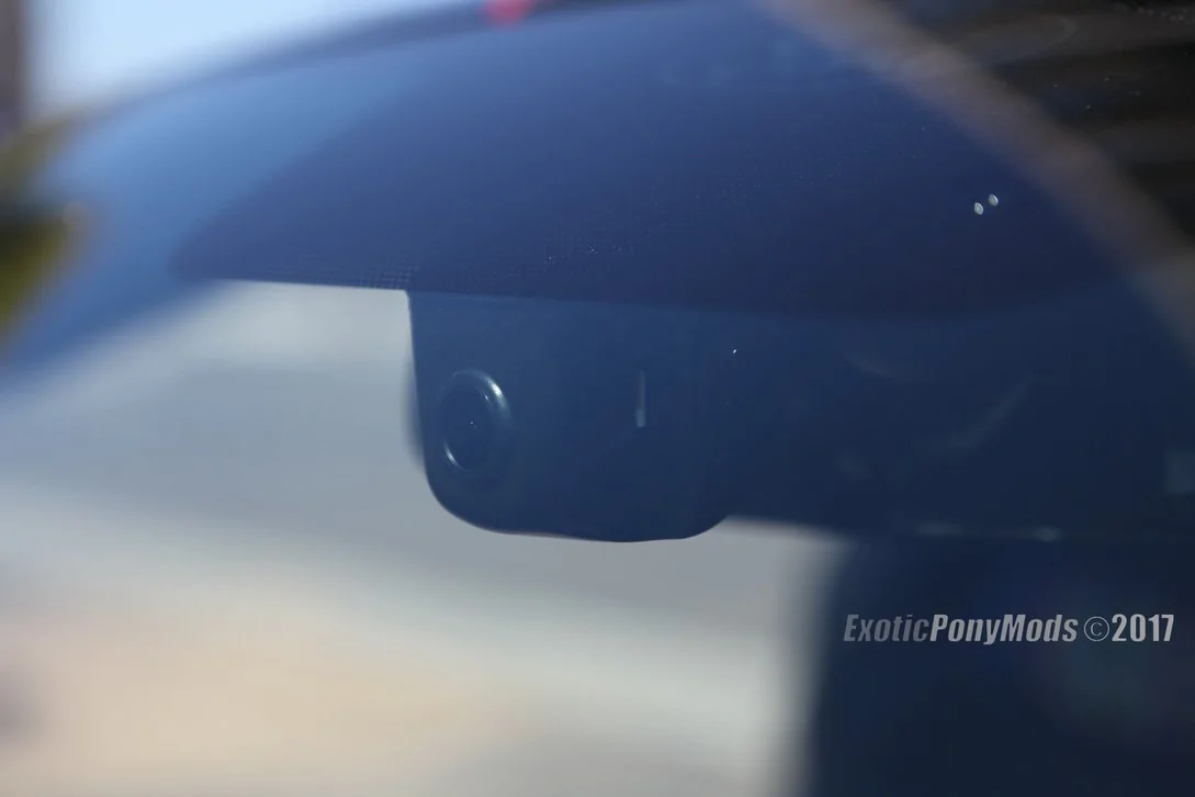

This is where Ford's electronics suck compared to others, The cigarette lighter plug's power doesn/t switch off like it does in other cars. I wasn't aware of this but luckily the battery didn't die but now I have to pull out the charger every time i am parking the carSure can.
Do you have a power management module fitted to the dashcam? I suspect not. The purpose of these is that you can set a voltage limit that when reached, the dashcam is turned off so it doesn't drain the battery.
