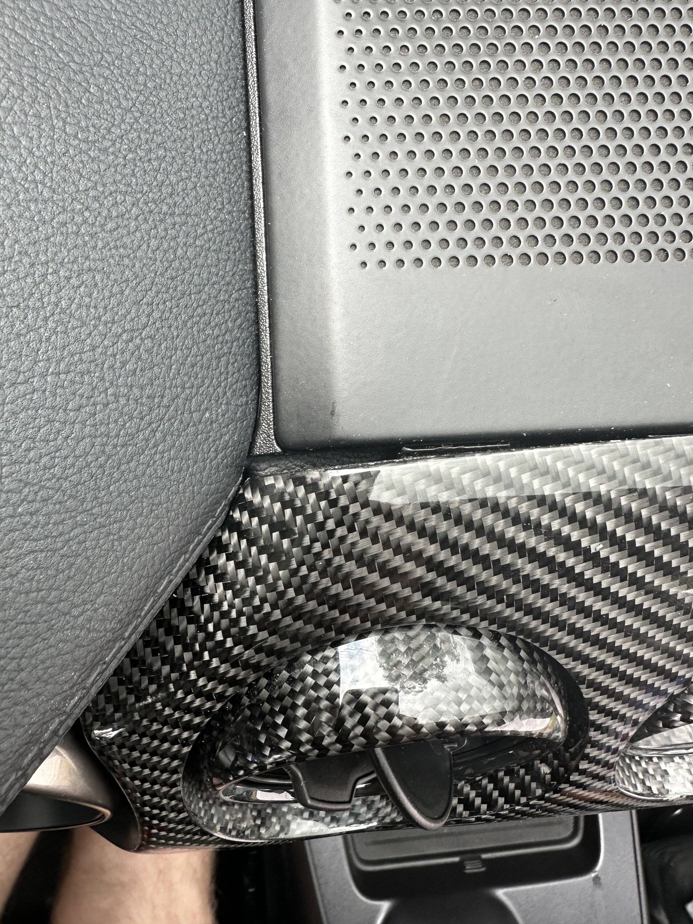

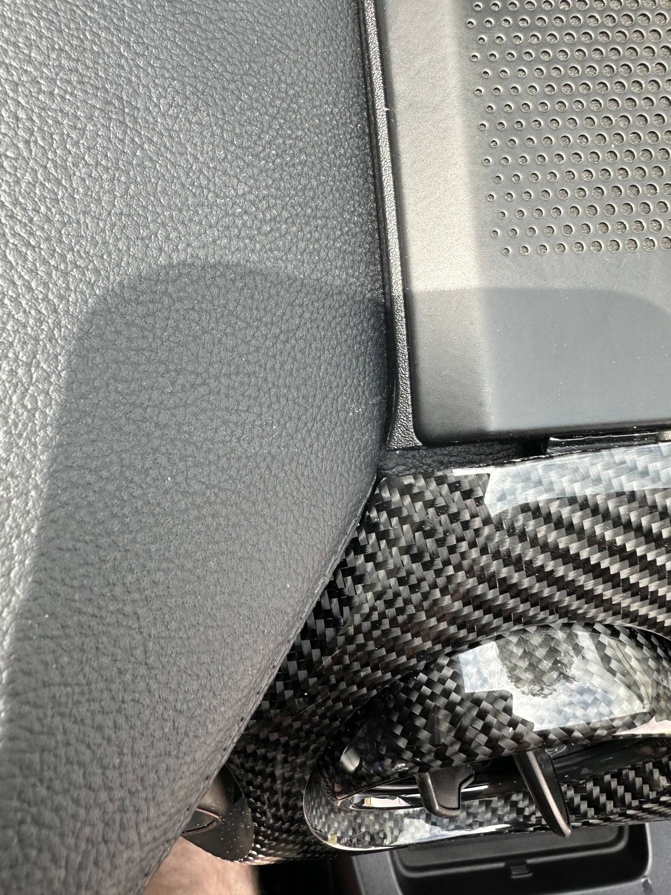

I have a 22 GT500 and have tried a few different carbon fiber dash kits. My issue right now is fitment with a gap on the top left corner. This is an oem dash piece with carbon laid over and cleared, not an overlay. All tabs are attached and in place. The corner just won’t stay and leaves a gap. I’ve also tried trimming the dash but that didn’t help.

There is no adhesive. This is an oem dash I bought with carbon laid on it and cleared. Should install just like oem but doesn’t. I even removed it and reinstalled my oem one and it fit perfect no gap

It’s an oem dash with carbon laid over it and cleared, not an overlay. It’s much thicker and doesn’t have the flex. I’ve been denied a replacement part and am now out $1400

Perhaps that end of the replacement dash may be warped so it won't lay flush?

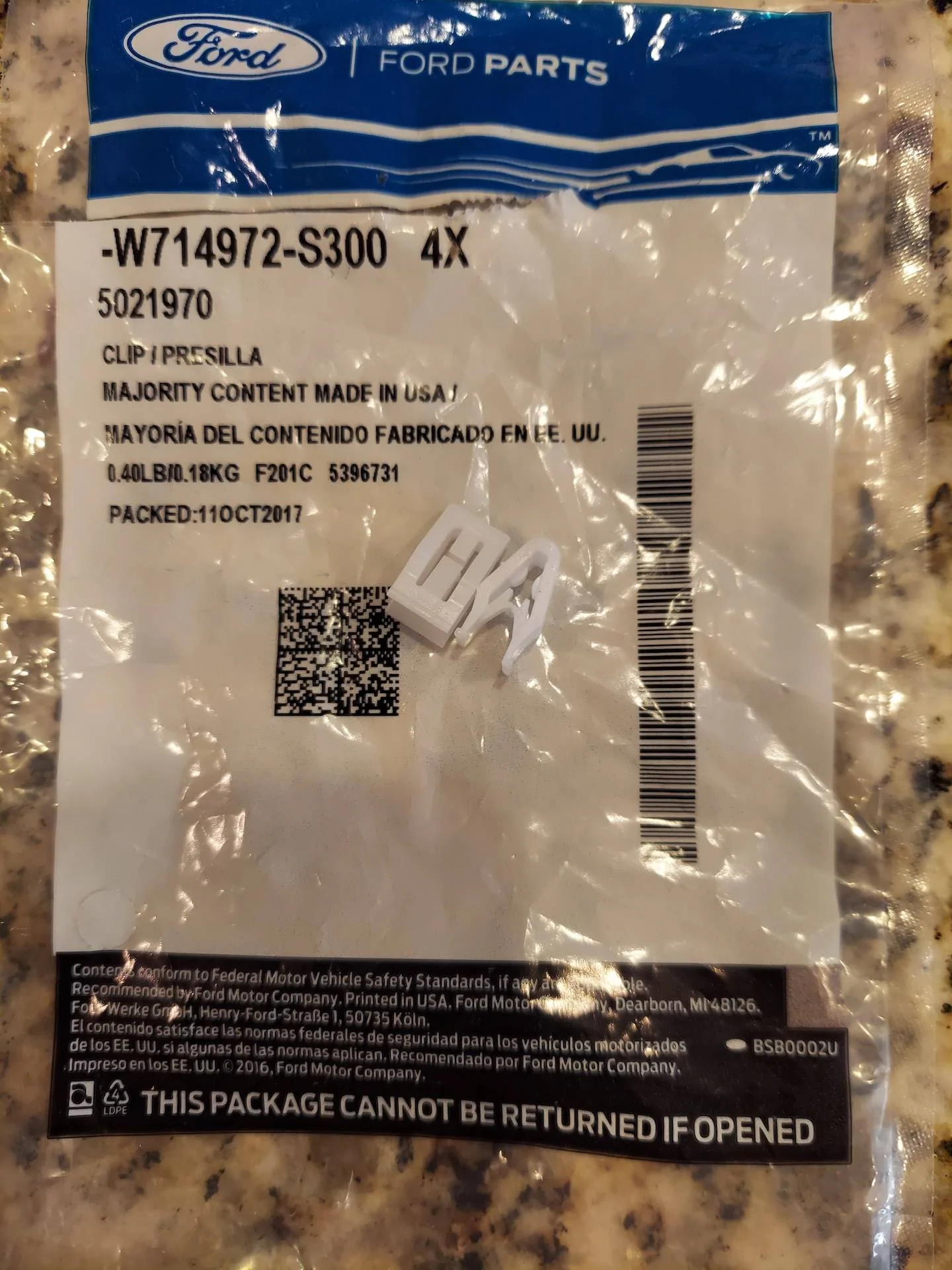

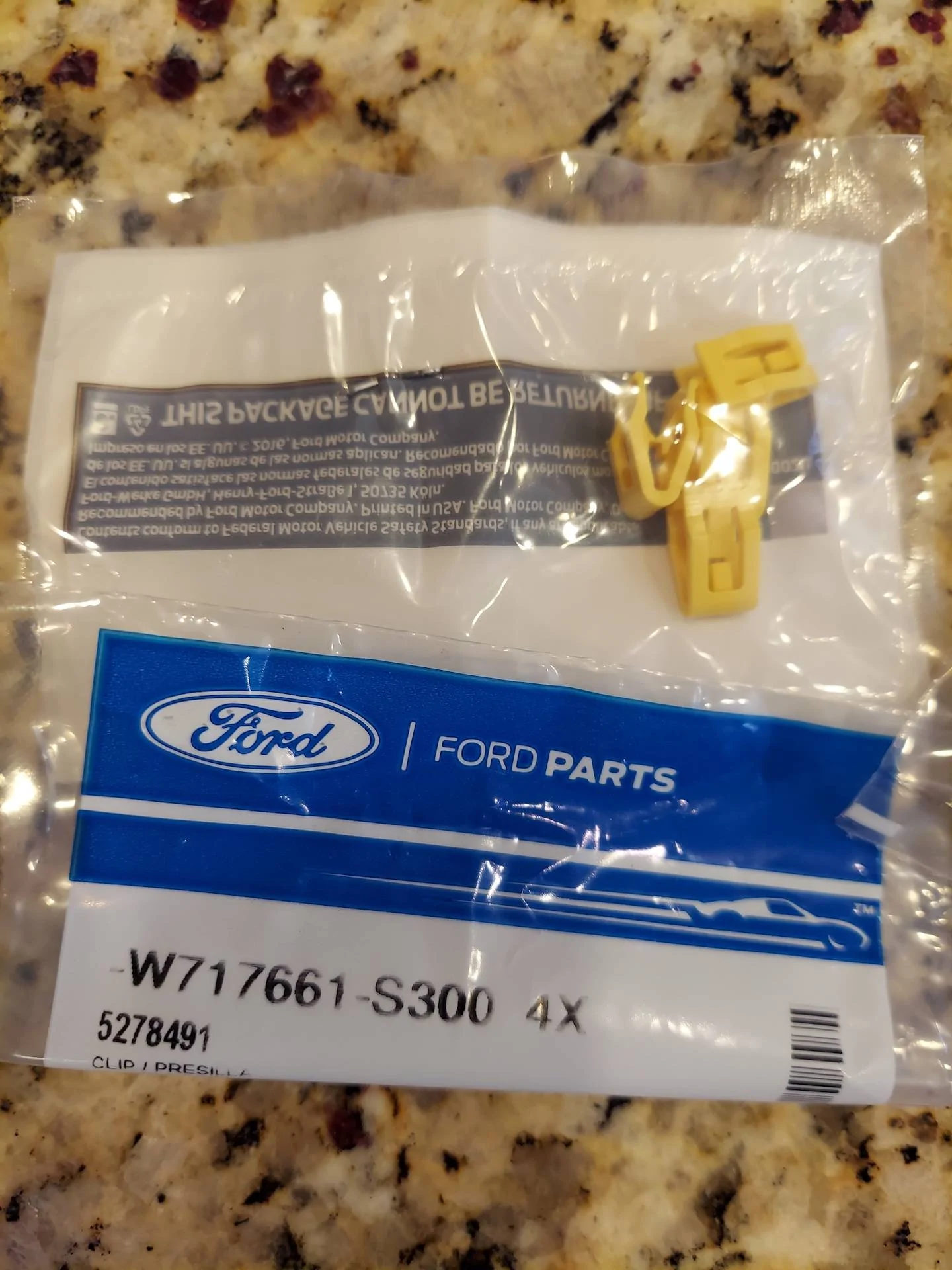

Tip: the dash insert is attached by a series of white, yellow and green clips. I lost a few white and yellow clips along the way. It would be a good idea to order some before the project. I've included part numbers for the white and yellow. I didn't need the green clips (used only in the area of the vents and gauges).

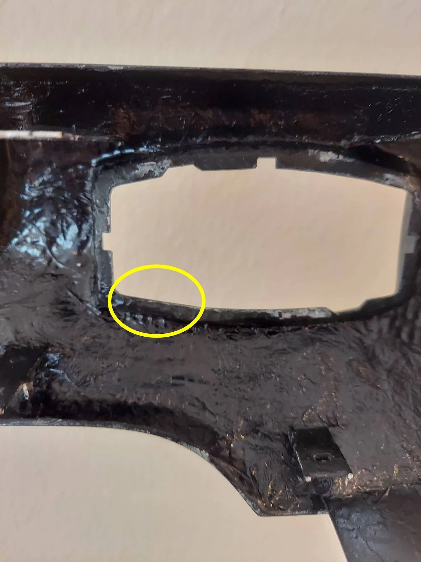

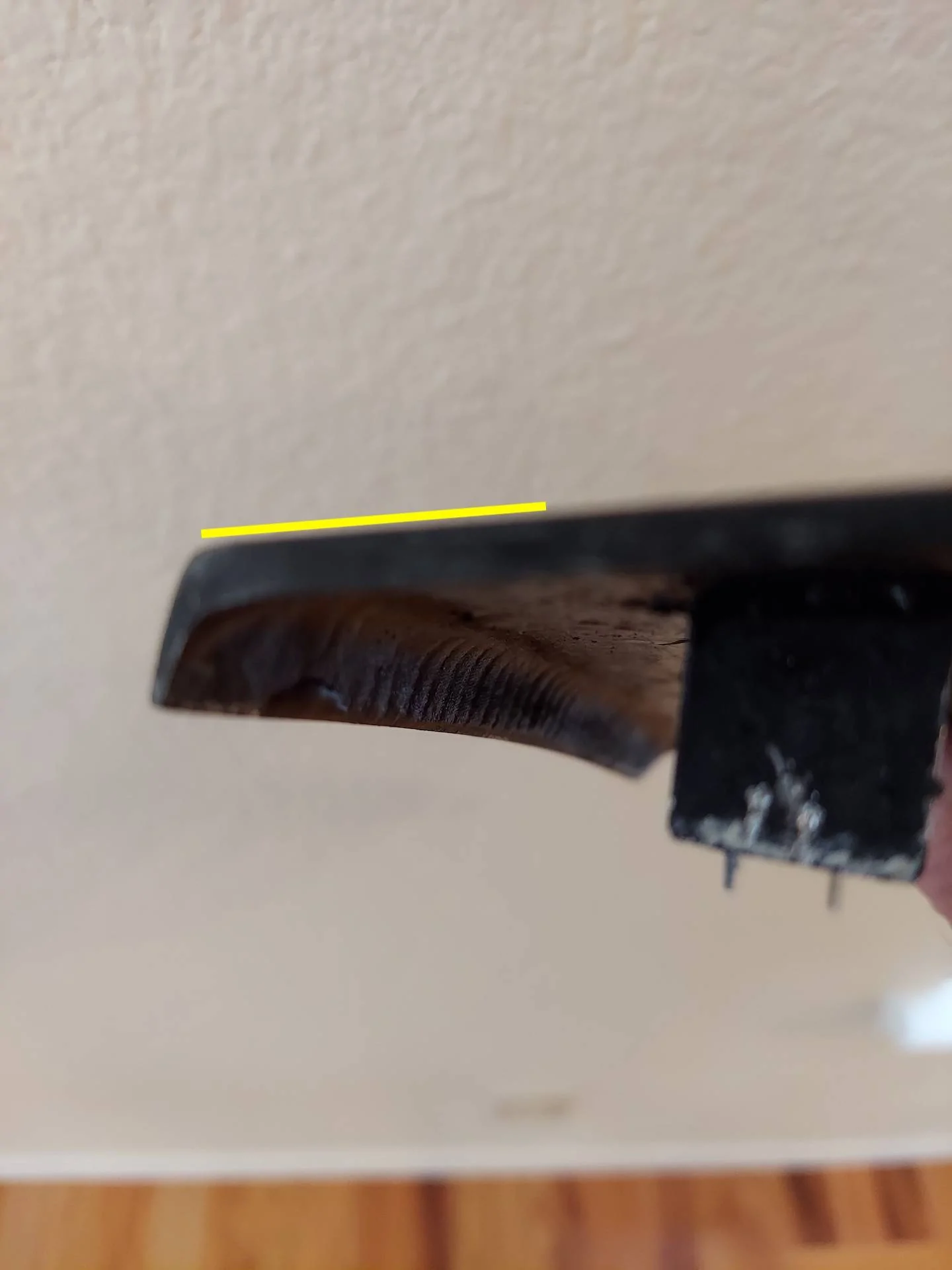

When I first attached the main insert, I felt things went OK. Unfortunately, towards the end of the project, I noticed a large gap, near the gauges. I removed the insert and re-installed. Better, but not great. Finally, I pulled it, removed all the clips, and placed it against the dash. And this is when I recognized the problem.
In the photos that follow, you'll notice the highlighted areas. On the main insert, it's pulled back a bit, twisted, near the gauge and vent area; this was preventing a good connect and seat.

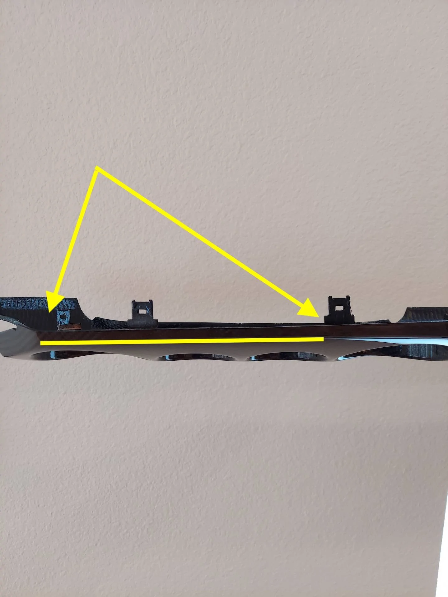

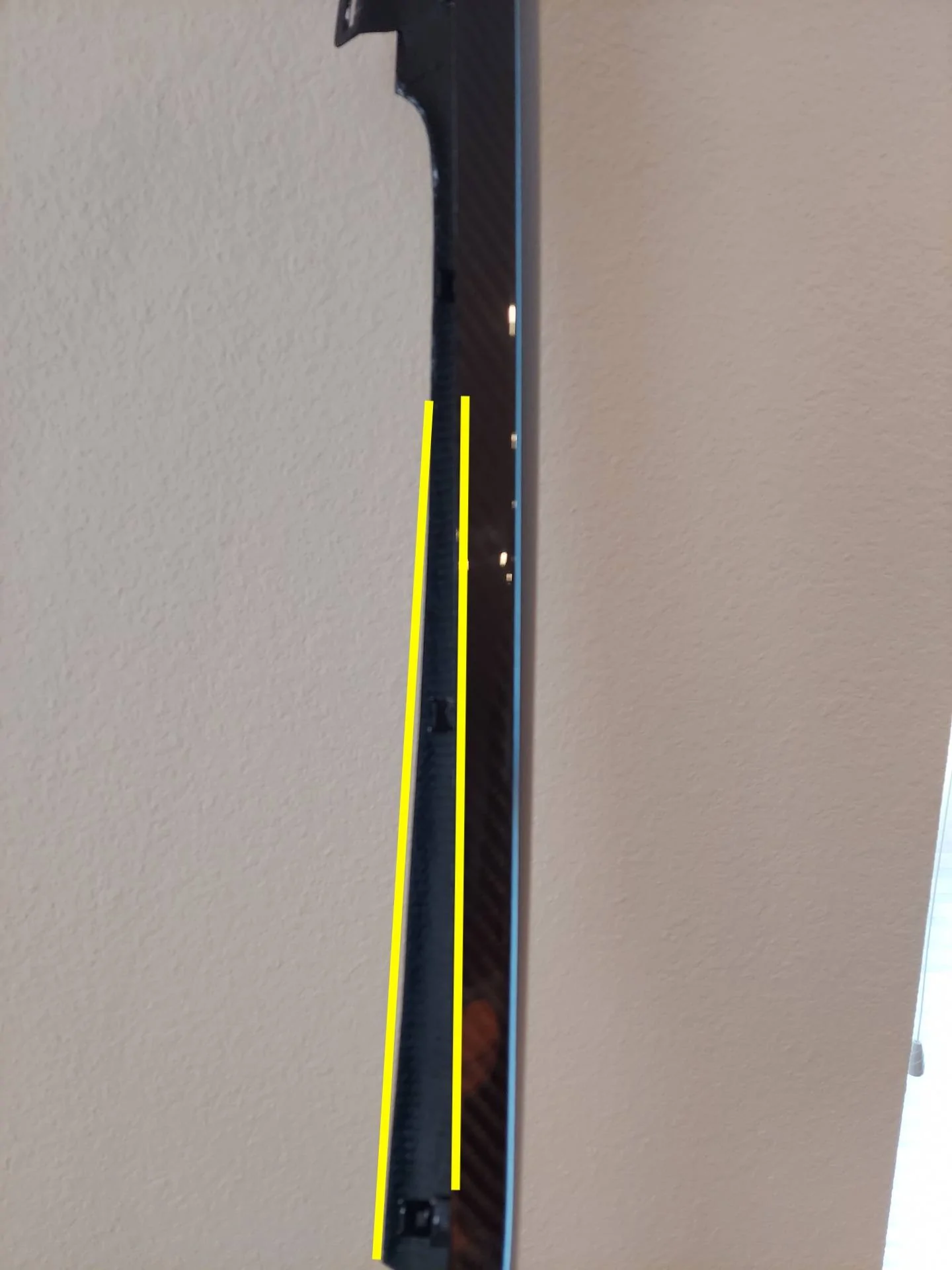

Further, looking a long the main section, there is a gentle twist or curve which is not present in the factory piece.

Notice the highlighted section, how the CF piece pulls back a bit.

Twist on the long end, not in the factory piece.

Too much material removed below. Big gap. Did not seat well.

You may have a little luck trimming the backside of the trim piece. Your video suggests there might be just a tad of excess material on the backside preventing the clips from seating fully.
This is pretty common among aftermarket vendors, and depends a bit on their process. Very likely it deformed slightly in the vacuum bagging process. It doesn't take much force to tweak a dash panel, and the carbon on top, once cured won't let it quite return to its original shape.
I've also seen similar problems when they mixed a bit too much curing accelerant in an effort to speed up the production process. The extra heat generated during curing can also warp things.

Company is stepping up and sending another main dash piece to try. It’s not my stock piece but it’s the same part # as mine and they install the carbon on it with clear etc. I think it’ll prob fit the same. The dash ends up being thicker with the added material and has less flex. This appears to be a common theme and perfect for can’t be achieved unless going full oem replacement
