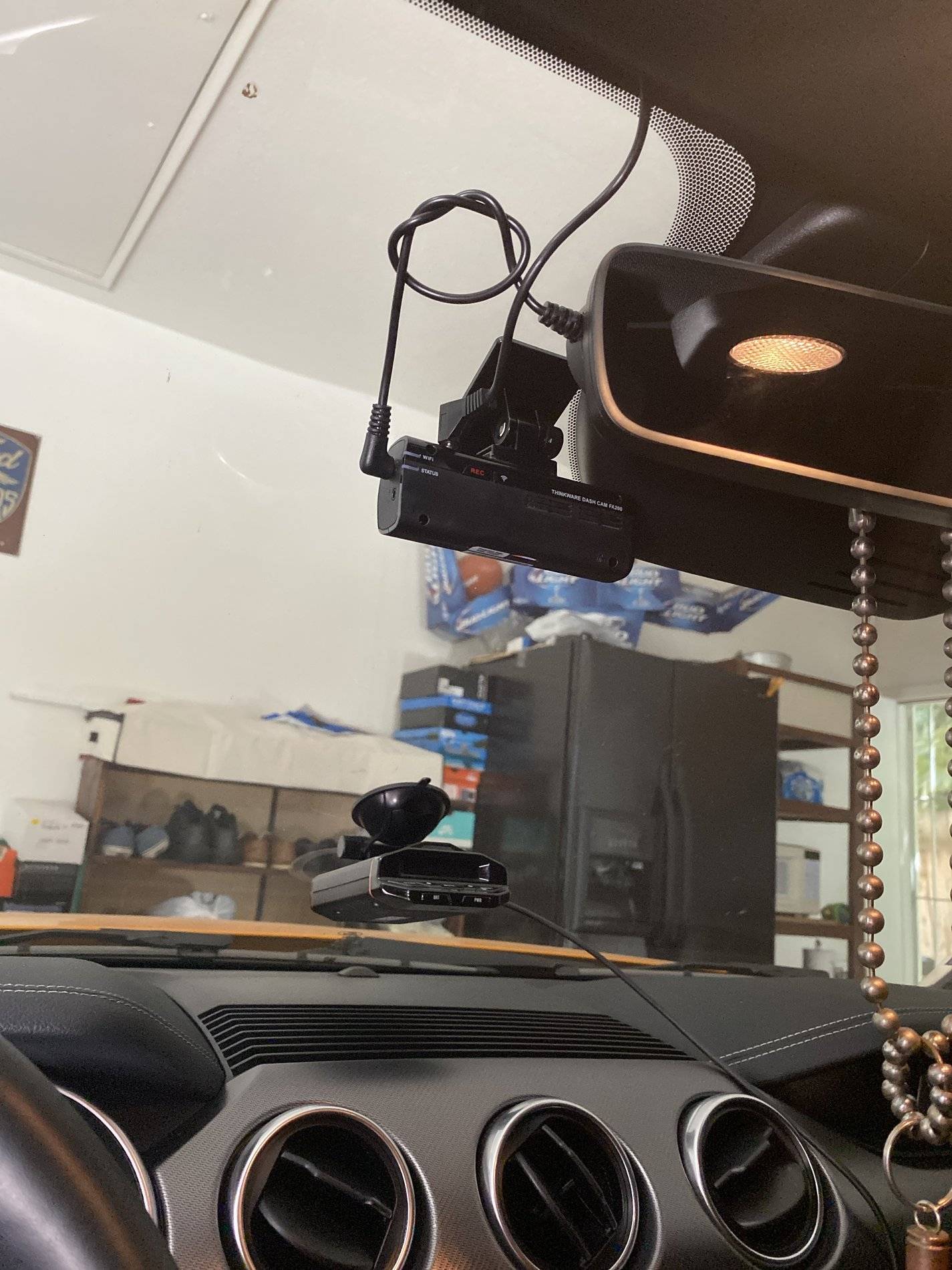

But if you already have a radar detector wires that way (like myself), then you'd need something else. That's why I'm considering a dash cam with good battery life, so I don't have to hardwire it at all. And in long trips, maybe use the charge cord if needed, but I think I'd turn it off on the highway, where it's extremely unlikely anything would happen that needs recording.

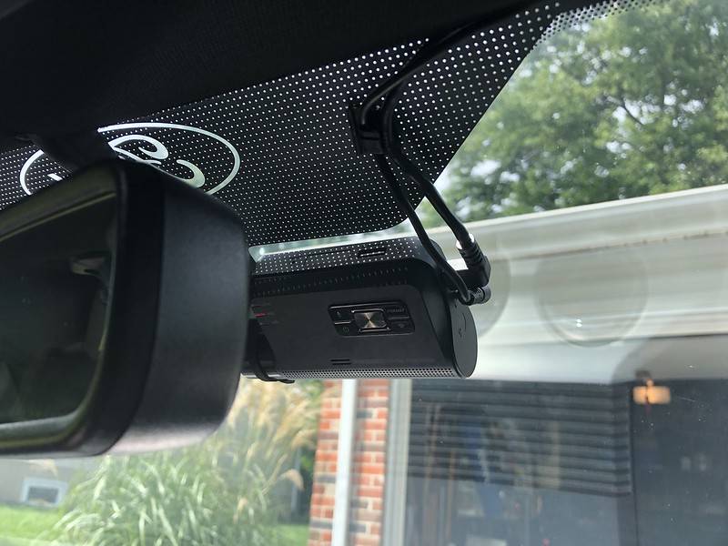

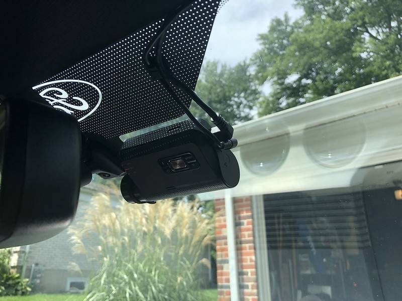

Windshield mount and hard wire to the fuse box is the way to go. Clean look and the camera is not noticeable. Mine mounted behind the RV mirror on the passenger side, I cannot see it from the drivers seat which I prefer. The only bit of exposed cable is what you see in the pics below.
Using the car battery for PM will work, just not for an extended period of time, depending on what PM's your camera offers and the amount of activity nearby. My dual cam system would only record for 3-4 hours in PM before the battery protection shut it off. I park in high traffic lot at work so it was recording often(I use motion detection). I ended up getting a Cellink Neo, pricey but it works well, recharges fast and powers the both cam's in PM for 24-36 hours. I installed the Neo in the glove box.
