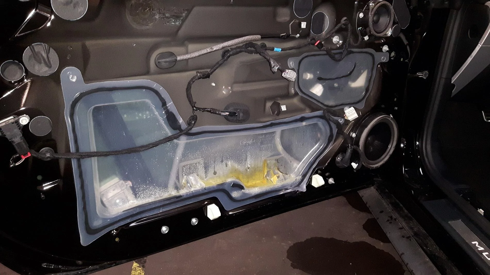

Well at the moment of writing this morning I thought it wasn't that bad as we eventually figured out... that said...
Around the drivers-seat left side frame I had a couple soaking wet spots, and noticed it came from the door. So we removed the door panel and indeed the plastic door-seal cover was leaking, the silicone came loose at one spot.

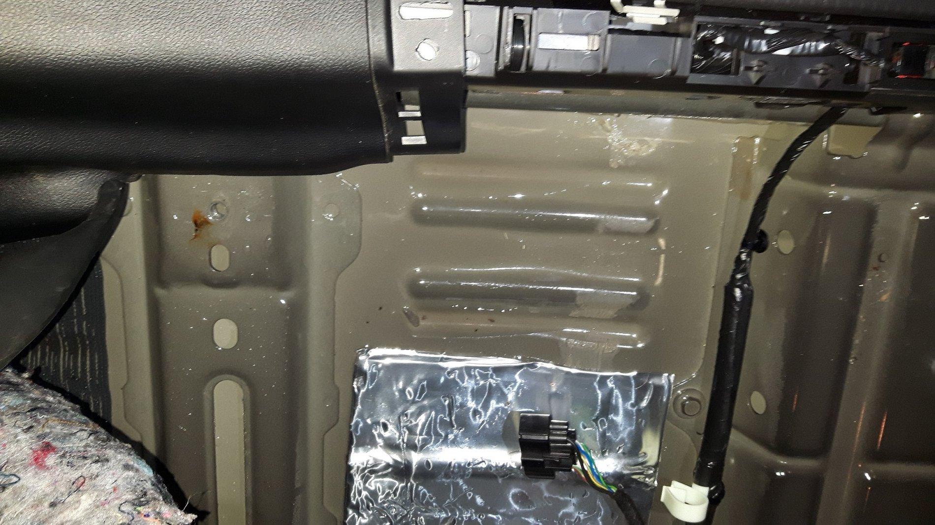

So we repaired that and vacuum dried the carpet only to find out it wasn't drying enough. Next step, we removed the seat, lifted the carpet and noticed a small swimming pool from the pedal area to the back-seat.
The carpet was soaked on the bottom side and the vacuum dryer wasn't enough to dry the carpet out.

Sad indeed, if there is as much water under the carpet again next week we didn't solved the problem, so fingers crossed we did!
I think there must be an explanation to why water got piled up in the door in the first place and searched a way out.
Looking into the bottom of the door was weird, it's like a V shaped bucket with 2 small holes for draining at the bottom where the yellow grease came out when you bought the car.
With the amount of snow, frost and rain it's seen the passed few months there must have been a point where the water level in the door was just to high and/or the holes were frozen at the same time. (Just guessing...)
On the bottom right of the transparent seal you can see where the silicone got weaken and leaked. The second pic is not covering the front area, but was much worse yet not soaked through the top of the carpet.
