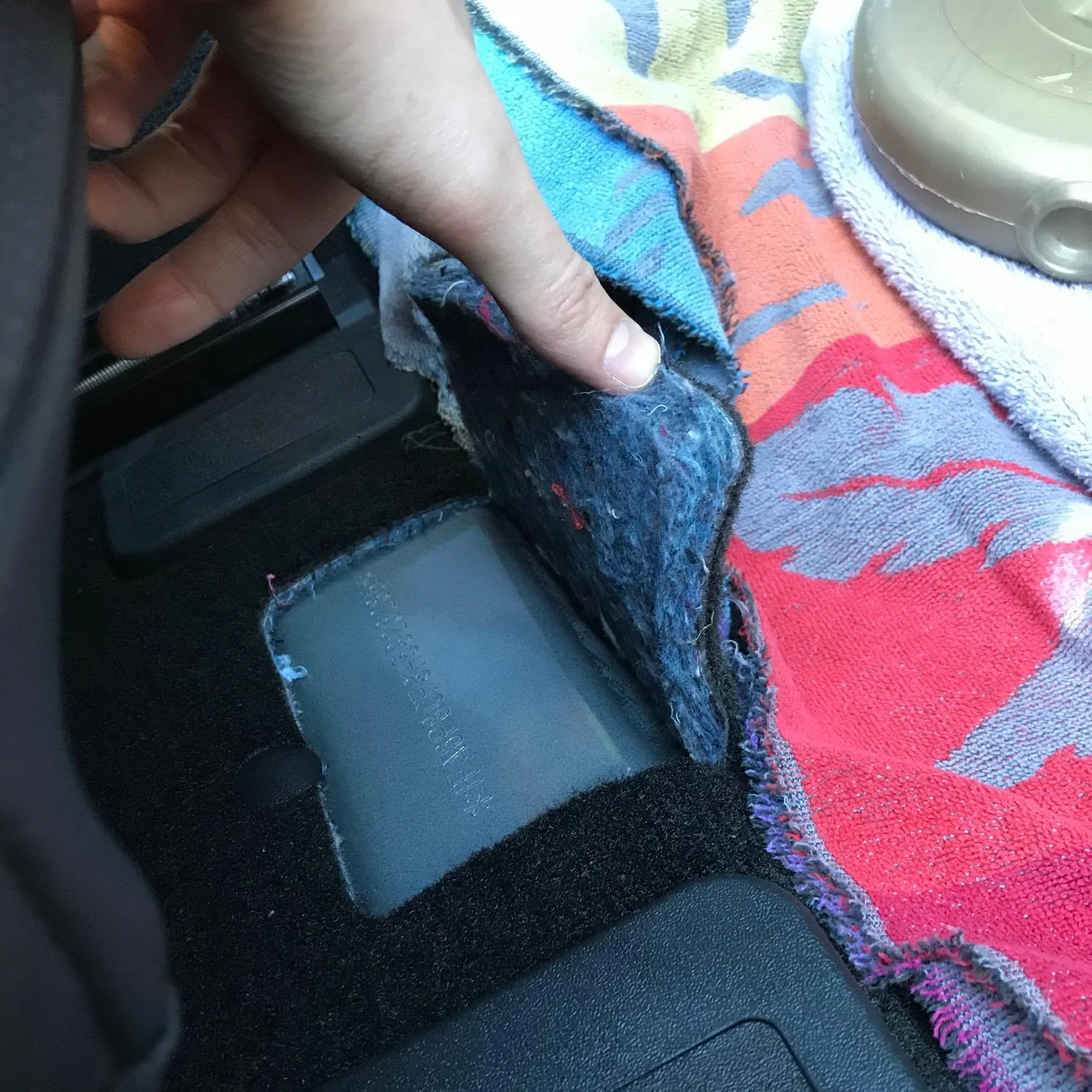

What backing has the carpet got? If it’s foam you need to make sure it properly dried out. Horrible job!
I think its that recycled cloth type backing.
Kristian87
Super Moderator
Moderator
Mar 3, 2015
87
3,874
3,210
Newbury, UK
Mustang GT
Yea this stuff - move the drivers seat all the way back, theres a small flap covering the vin...
