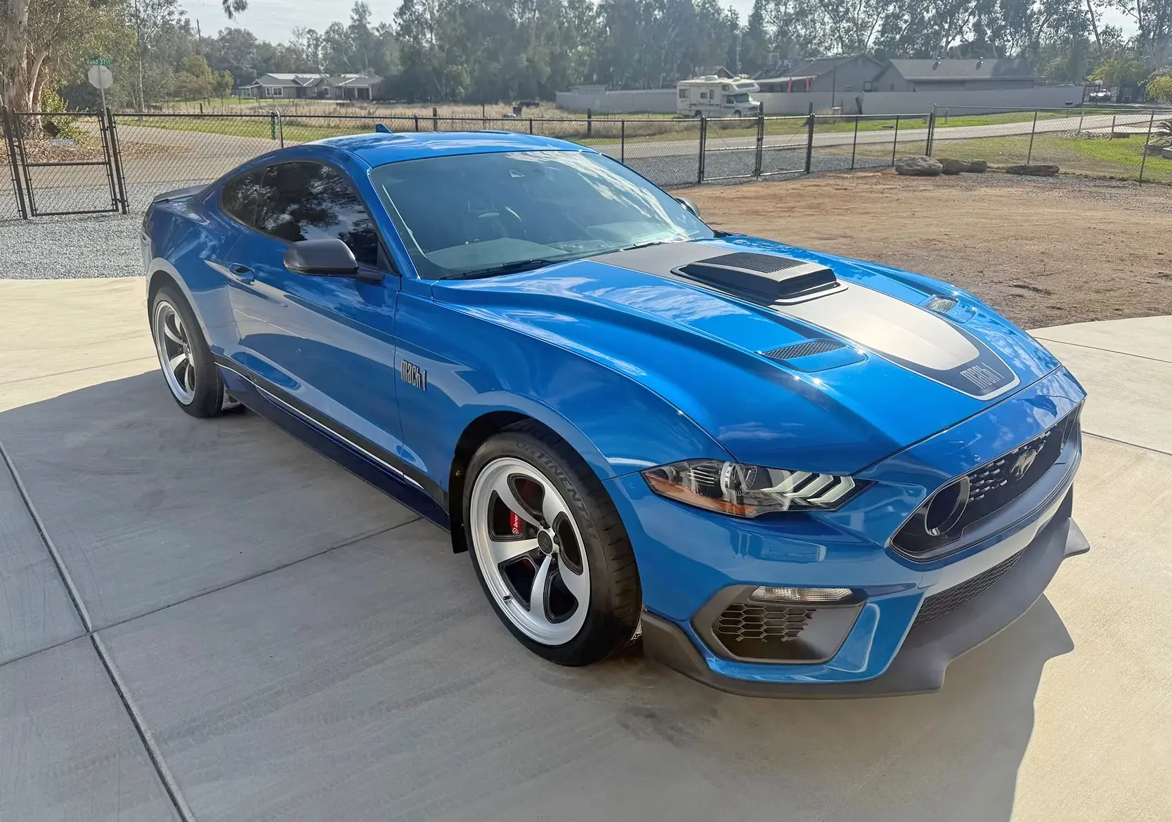

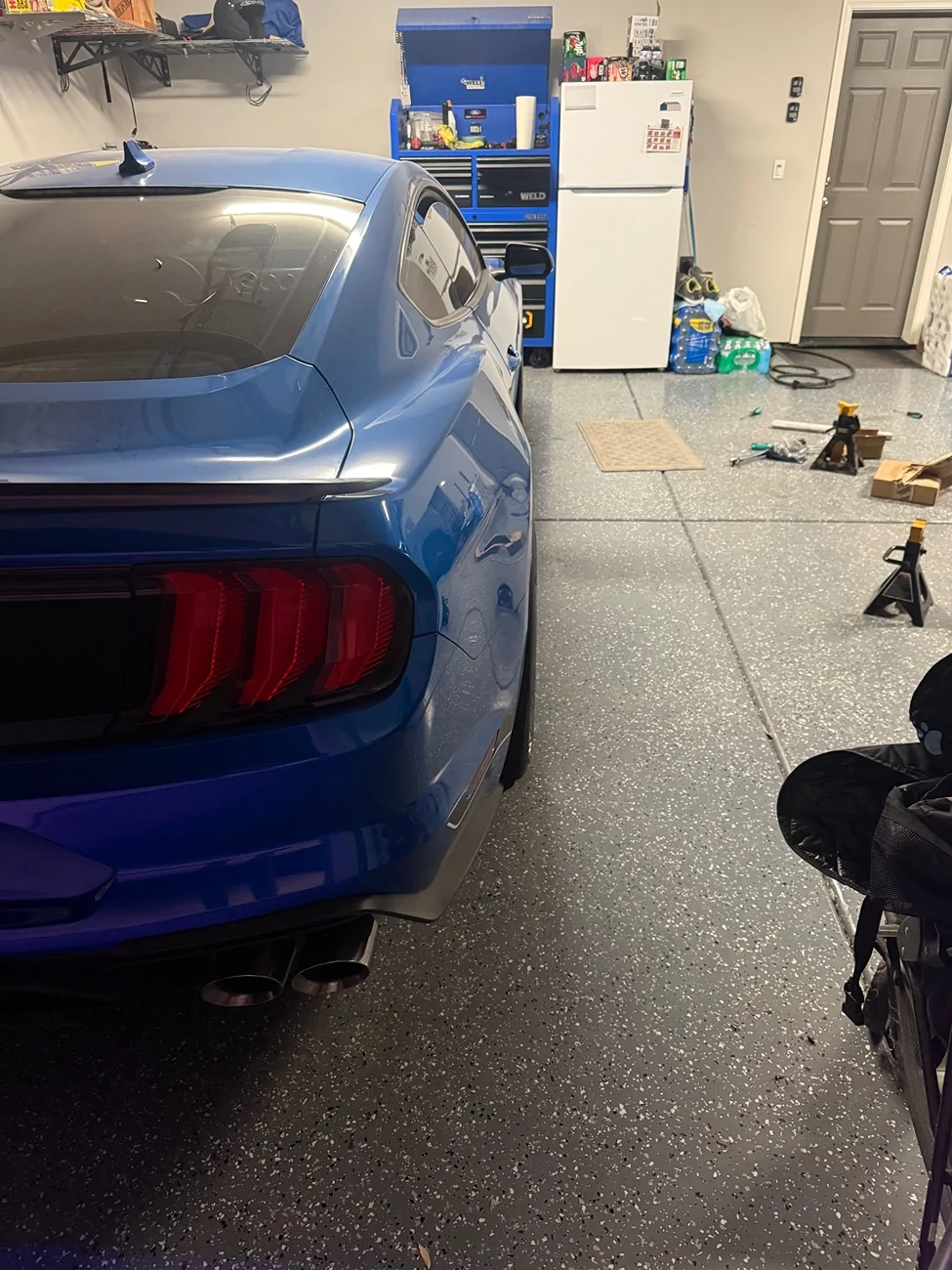

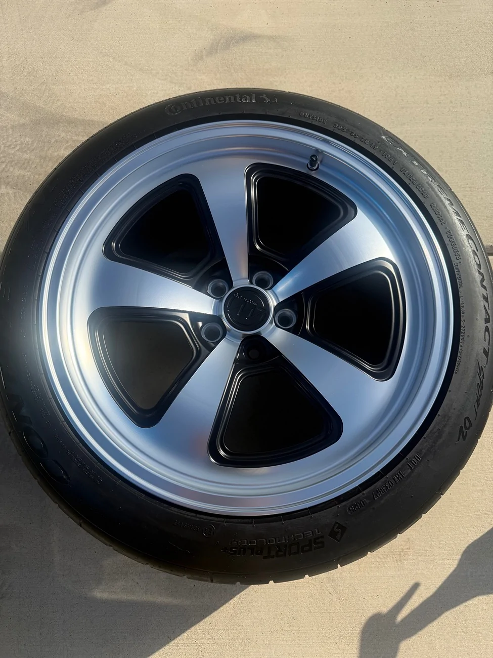

@Atomic Wheels 19x10.5 +30 front 19x11+52 Rear Custom Forged Wheels with Conti Sport 02 295/35 and 305/35. Machined Face with Satin Black.
Absolutely love the wheels. I think they turned out awesome. Thank you to Atomic! They were great to work with and very helpful with all the different changes I made. I wanted something that looked like a Modern Version of the Magnum 500.
Got to take her for a little spin yesterday before it started raining and the wheels paired with wider tires are a big improvement over the stockers. More traction, better steering feel, ride improvement and quieter. I really liked the MP4S that came on the car but loving these Contis so far. No rubbing, no issues whatsoever. Stock Height.
Also thanks to all the Members who helped with great input and insight! Appreciate our community! Couldn’t be happier.

Thanks man! That was what I was going for. Definitely changed the look!

VERY nice! Fresh (and good) looks are hard to come by!

That was a bold move. Looks great!. 👍 So does the finish…
I think I’d would have liked to be able to have had our original wheels duplicated in HP sizes. I like that idea.

The concave look is throwing it off for me

Yes, they have taken some getting used to for sure. I’m liking them more and more. IPOGT they have the design for our original wheels in those sizes. That was my original idea but I decided on a bolder move lol!

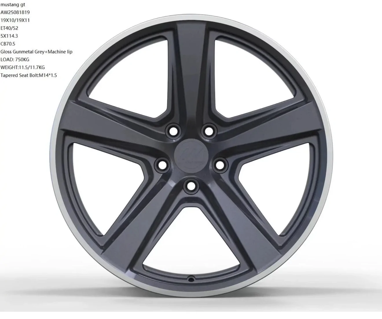

These were one of the original designs we made off of the stock Mach 1 wheels. In the rendering it says 19x10 and 19x11 but I ended up going 19x10.5 in front with +30 offset and it fits perfectly. I have a non handling pack car and didn’t want them to stick out and didn’t really want to do the flares on the HP. So it’s GT350 specs (Non R) except for rear is 19x11 +52 instead of 19x11 +62.

Thanks man, Yes, I agree! I’m thinking it would be ok with no rubbing with a minimal drop. Maybe some Steeda Drag springs.

Looks great! I think you're going to love the Conti's.

Yeah, that's all it needs.
I went with the BMR minimum drop springs. Little over a inch in the front and half inch in the rear.
