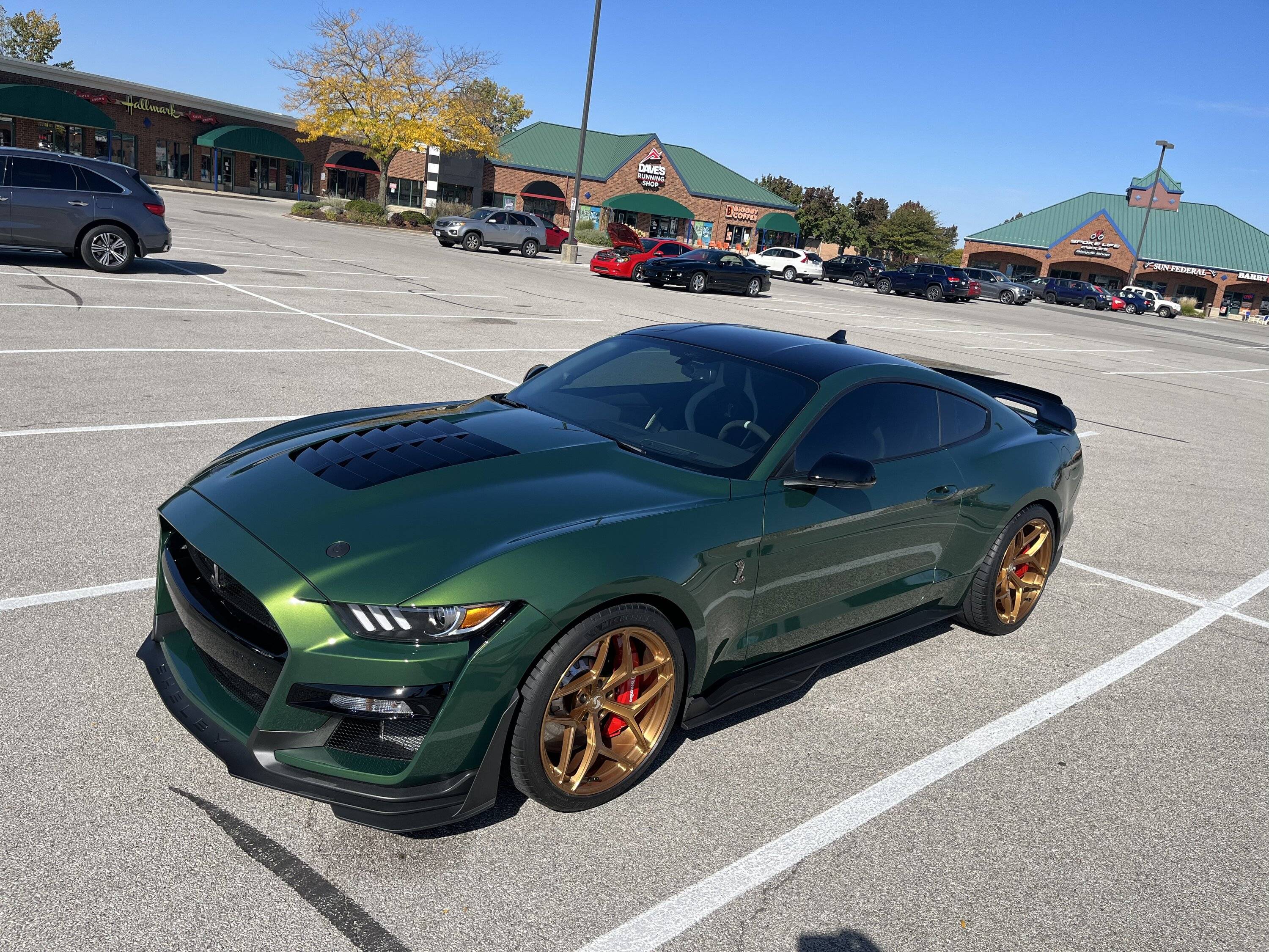

Answer: they fit!
This is before dealer clean up.
Picking up Saturday due to work.
-J
Hello,
I have a 2017 Convertible Mustang Ecoboost Premium with the OEM 20" rims. Wheels size 20" X 9", bolt pattern 5 X 4.5, offset 42.5MM for all four wheels. I have 265/35/20 in the front. And I upgraded the rear tires to 295/40/20. and they fit perfectly and still have a lot of space (like 4" towards the shocks). I bought the OEM 2020 Shelby GT500 wheels (Front wheels size 20" x 11", offset 32MM and rear wheels size 20" x 11.5". offset 50MM) I know the front would rub, but I will change the tires to 275/40/20. For the rear tires, the wheels I bought need two new rear tires. I would like to put 345/30/20 (they fit the rim width perfectly based on the Bridigstone Website). Would the Shelby GT500 wheels with 275/40/20 in the front and 345/30/20 in the back fit my car?
