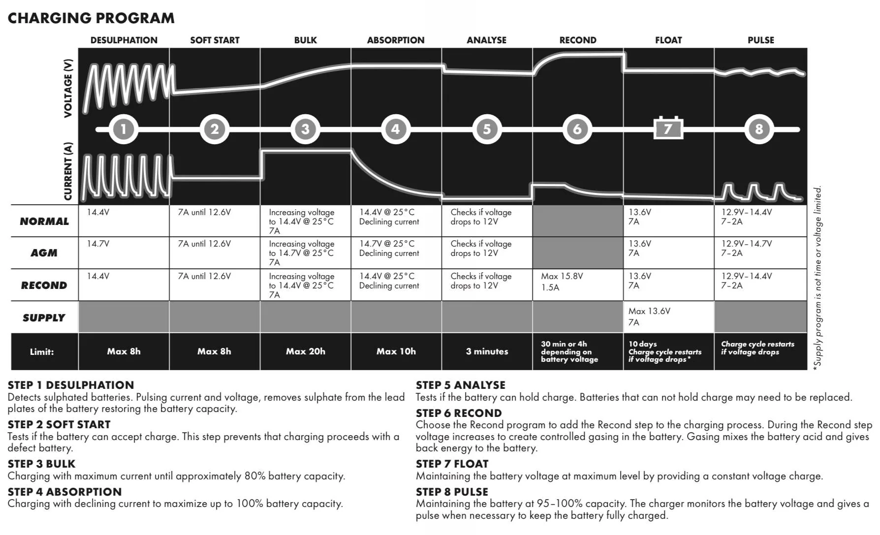

For detail...

I've had the CTEK on the car for a couple weeks and have yet to see it reach the 8th step.
This is my first season with the car on the tender for extended periods. I'm still learning both the car's and the tender's behaviors. Skye took a little over two weeks to reach Step 8.
This week, I disconnected the tender (needed the extension cord) for the day. After later reconnecting, the car was back at Step 8 by the end of the day.
The car also entered into deep sleep in the first month, but I kind of expected this. I knew the tender was connected and working. To prove it, I unlocked and then locked the car. Aprox 5 to 10 minutes later, the Ford app confirmed the car, for however long it would be, was "awake".
