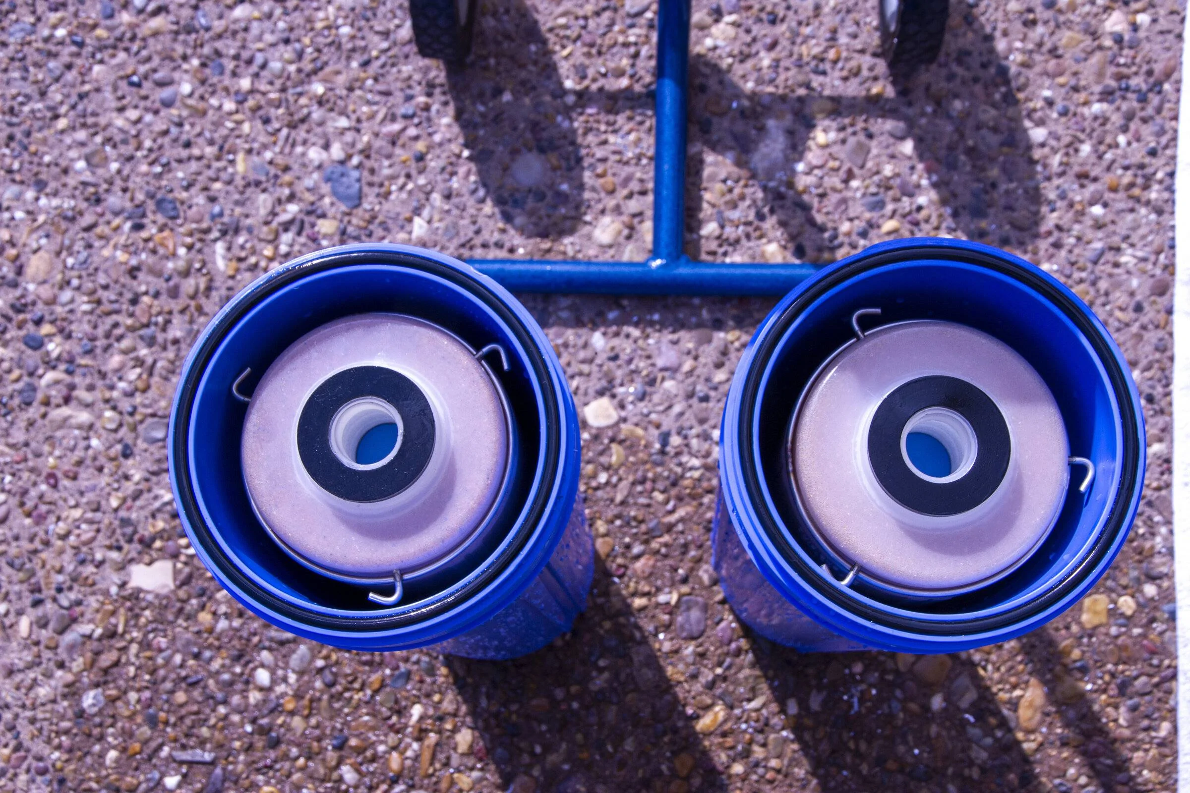

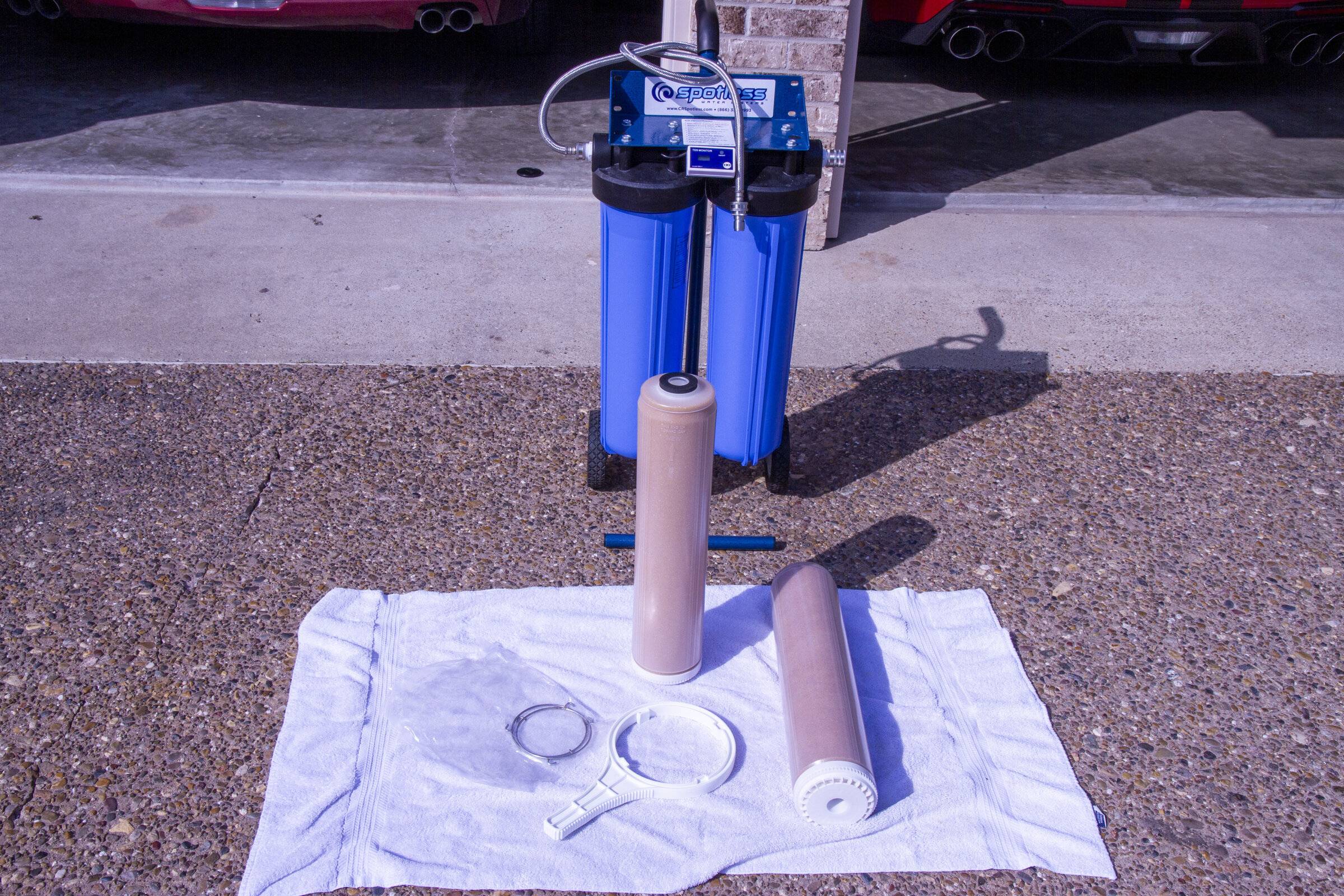

I started seeing positive numbers on the DIC-20 display after seven months of regular and frequent use. Ordered the new carts and did the swap yesterday.

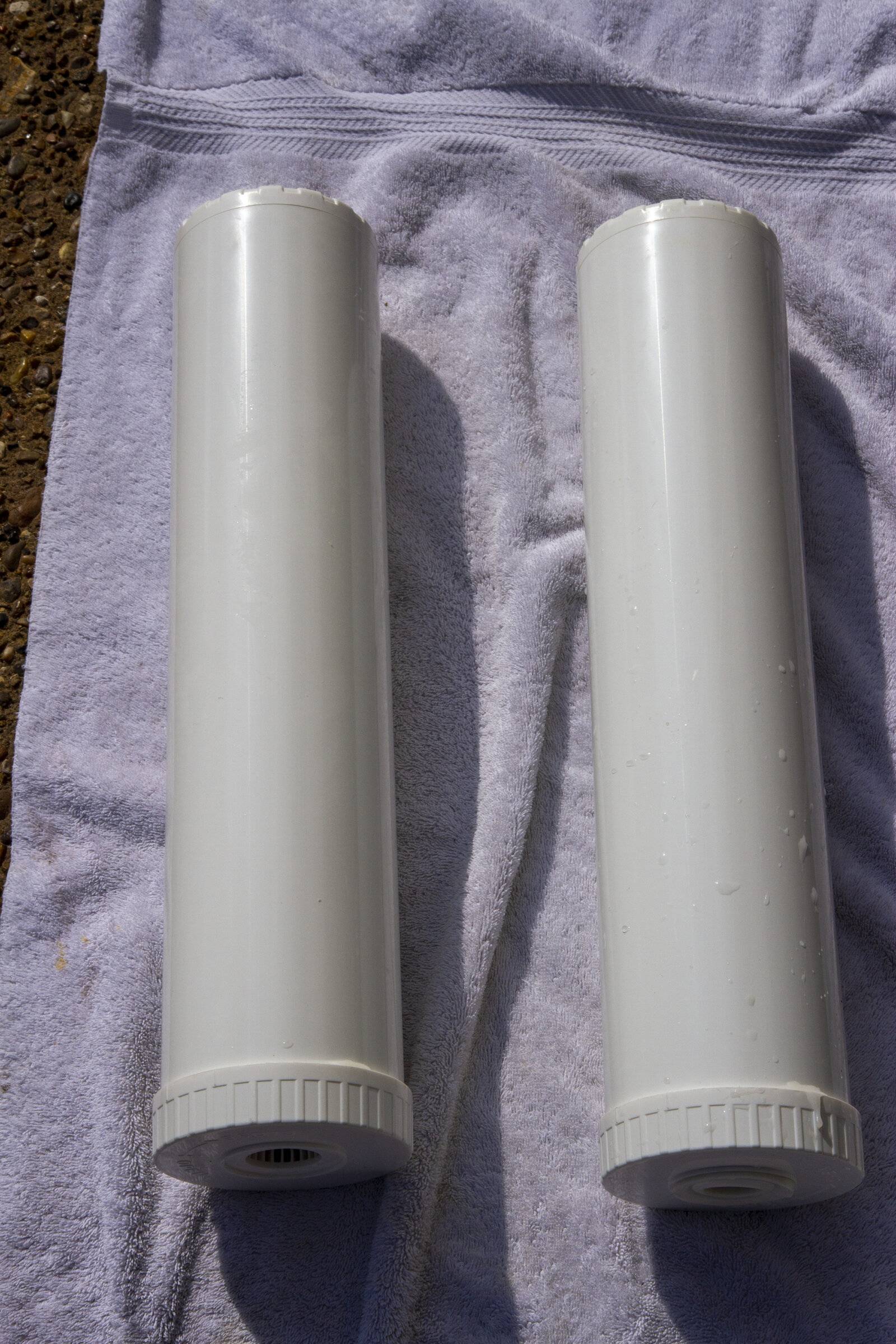

The original carts were not "see through" so I couldn't tell how "dirty" they were but the exterior of the new carts is clear. I added the metal centering gizmos because I had them for the house water treatment carts.
Easy ten minute job.

With my experience as a chemist, you won’t see the resin look “dirty” when it is exhausted. So, you didn’t miss anything.
For your consideration: next time, try regenerating the resin with a 15-20 wt% solution of salt (NaCl) dissolved in distilled or deionized water. Flush the CR resin containers in reverse-flow mode (add the brine to the outlet of the CR unit and collect the effluent from the inlet of the first CR cartridge. Then flush the unit, again in reverse-flow mode, with distilled/deionized water to remove the excess brine. Based upon your pictures, you would probably need 2-3 gallons of brine and 3-6 gallons of distilled/deionized water to regenerate the resin if you can get a pump to deliver the brine at a 1-2 gallon/hour rate. The distilled/deionized water flush can be performed at a faster rate. You will save a lot of $$ and not generate a lot of plastic waste by regenerating your resin.
