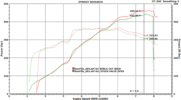

Are the Borla results fiction?
We'd never survive as long as we have if we posted bogus results. Furthermore, icons like Shelby and even Ford themselves would not be using Borla as their exclusive performance exhaust supplier if we posted bogus results.
We're not pulling a rabbit out of our hat either and we've gone into great detail on this forum with graphs showing the results along with pictures, drawings and editorial demonstrating the differences between Borla and stock, explaining how and why we were able to accomplish these gains.
Also, it's not like we're talking about gains that are not believable. The gains we posted are modest and well within the realm of possibility. We never post the best runs, rather we post the run that seems to be most consistent out of dozens performed over different conditions. You should see what the best run looks like.

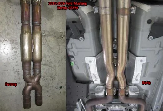

David, are you able to tell us what the primary restriction is? Cats? X pipe? Mufflers?

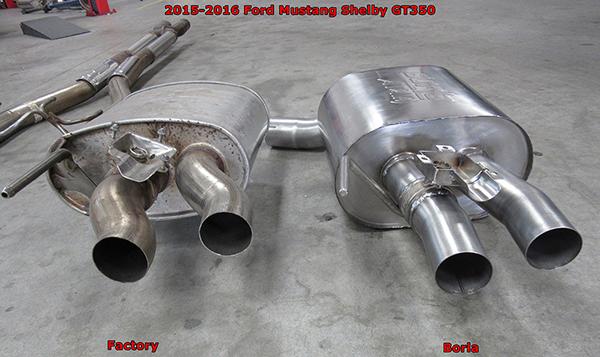

I cant speak for him but I can see restrictions in both the x-pipe and the mufflers. The x-piple clearly necks to 2.25" on both ends and the opening to the mufflers where the valves are is not a smooth transition at all. Im guessing the "blatty" sound when removing the resonators is partly to do with the mufflers themselves and this transition. Its as if the flow rate builds up just prior to peak torque causing it to transition to turbulent flow and then smooths out and goes back to laminar.
And just looking, I can certainly tell there are parts of the exhaust that are not the greatest design. I think I need to make it clear too that the reason why I'm skeptical about gains is that know just because a system CAN flow said CFM doesn't mean the engine is taking advantage of all said CFM. Now I know Borla has given a ton of info and in terms of FLOW CAPABILITY, I totally believe it. I had maybe eight different exhaust configurations on my '11 GT NOT including headers + catback and not a single alteration from the cats back did a thing to improve power and torque. The only exhaust modification that uncorked anything was from my long tube system.
Also, none of what we have discussed changes the fact that I still want the Corsa X pipe regardless of power or not.

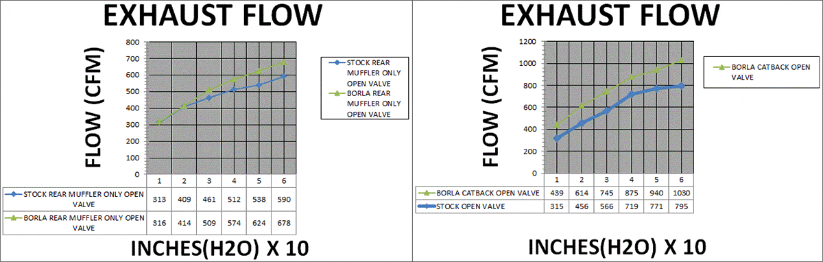

As much as I love Borla, I'm hard pressed to believe ANY power gains from a catback alone from any manufacturer. Flow capability is one thing. Actual power gains? Completely different. Yes manufacturers give dyno numbers but we also have no idea what conditions those were under and how many runs were done to produce those results with what deviations.
As David stated before, "We'd never survive as long as we have if we posted bogus results." That said, we always encourage others to do their own testing and share their results. We are confident in the power and sound enhancements that we were able to make, but your experiences should be shared as well. We are always open to feedback.
I've attached our R&D photos and Testing Results below.
The OEM x-pipe is really not a true x-pipe but rather a stamped piece, and that's not ideal for flow. The Borla is a true x-pipe that maximizes flow and maintains the 2.75" diameter throughout.

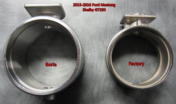

The Borla muffler also outflows the stock muffler with the valve open, and closed. Reason: [FONT=&amp]The major area of restriction in the stock muffler looks to be the tailpipe portion where it has a nominal 2.50” valve that has ridges that restrict to 2.25”. There are also complex tight radius bends in the tube. In contrast, the Borla tailpipe [/FONT][FONT=&amp][FONT=&amp]is nearly straight and [/FONT]uses a valve without ridges and therefore no restrictions.[/FONT]
