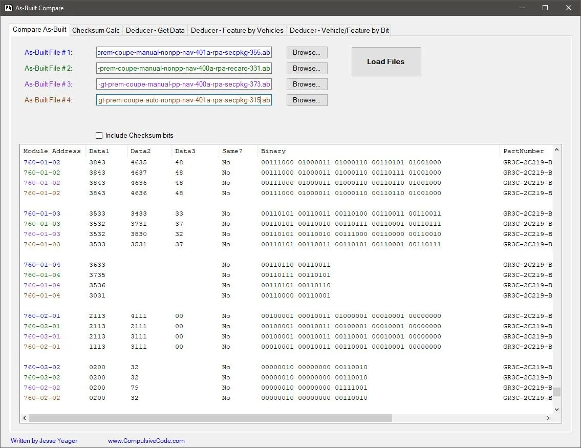

Process of elimination - maybe we need to be looking at the ABS as-built.
Or maybe we don't.... uggh.
So I compared four different cars. ABS is module 760.
Blue is GT Manual with 3.55's.
Green is GT Manual with 3.31's.
Purple is GT PP Manual with 3.73's.
Brown is GT Auto with 3.15's.
At first you might think, hey! Lots of differences! But not really. 760-01-01 through 760-01-04 are merely the VIN.
That leaves us 760-02-01 and 760-02-02 as the only lines that have meaningful differences.
The first digit of 760-02-01 would seem to correlate to whether the car is an auto or manual. Not helpful.
The fifth digit of 760-02-02 does change, but for some reason is the same for the GTPP with 3.73's and the Auto GT with 3.15's.
The fifth and sixth digits of 760-02-02 seem to correlate to whether the car is a PP or not. I do know that the fifth digit seems to control whether you're able to use the drive mode toggle when you do a swap from base to Sync 3.
Maybe the ABS needs a relearn procedure just like the PCM does? :frusty:

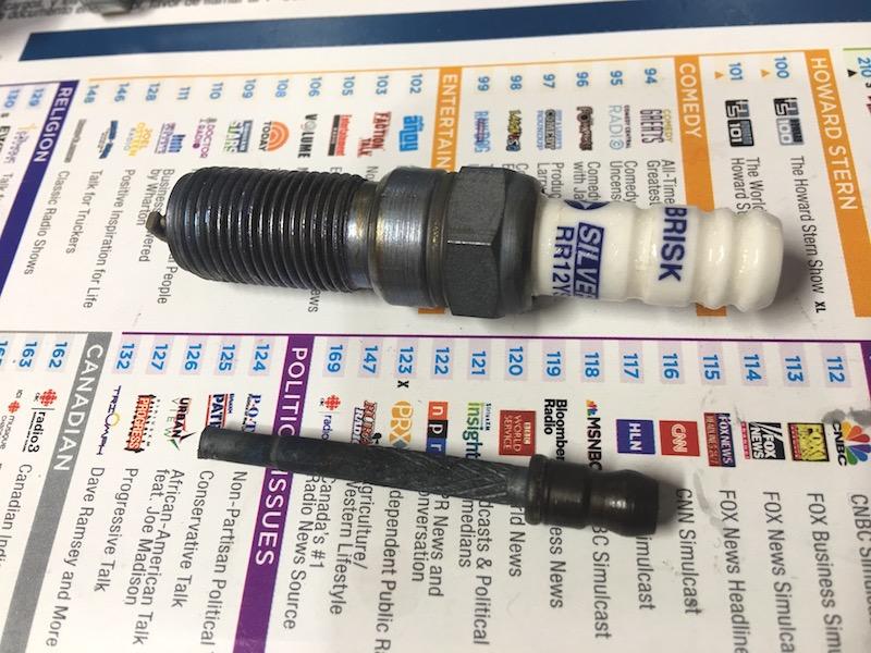

I'm having the exact same issues that you are. I also swapped out the 3.73s for 3.31s and the car goes into limp mode under load. It stays like that for ~10 seconds and then returns to normal. The worst part is that in limp mode the afr goes so lean that I'm getting misfires. It actually broke the electrode inside of one of my plugs and based on the resistance I'm seeing there is another that's almost broken. So you changed the BCM line 0726-12-01 to 014B-XXXX-XXXX and it didn't fix anything? I thought the plugs were my issue and didn't realize that the gear swap was causing this. My tuner, like yours, also said that there were no changes needed with the swap since the speed sensors handled the speedometer. Did you ever figure it out? I ordered new plugs and was just about to put them in and change the BCM to account for the gears and tire size but if that doesn't help anything then I'm not sure what I'm going to do. I really don't want to go back to the 3.73s or drop the rear end again for any reason actually. My brother's a master mechanic and also didn't believe there were no changes to be made after a gear swap. He said at the very least the new pinion ratio would need to be changed in the ABS module or settings (not sure where it's located without opening forscan). I guess that's where I'm going to start looking. Here's a pic of a nearly new plug that's been destroyed as a result:
