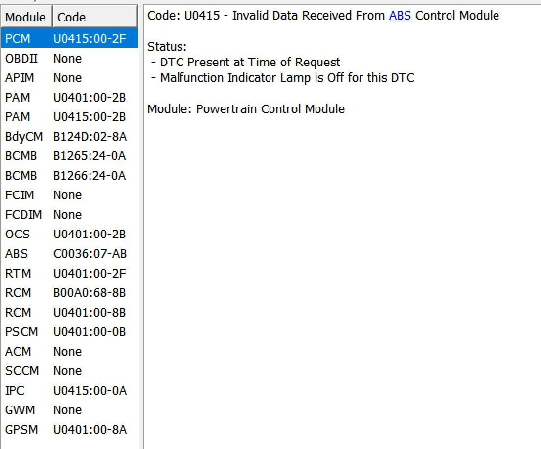

I just went out to my car 5 min ago and took the following screen shots.
Is there anything I'm doing wrong? the PCM has been refreshed and the i don't get a P160A error

In Addition, here is the FULL DTC Text
===PCM DTC U0415:00-2F===
Code: U0415 - Invalid Data Received From ABS Control Module
Status:
- DTC Present at Time of Request
- Malfunction Indicator Lamp is Off for this DTC
Module: Powertrain Control Module
===END PCM DTC U0415:00-2F===
===OBDII DTC None===
Successful DTC reading, no error codes found
Module: On Board Diagnostic II
===END OBDII DTC None===
===APIM DTC None===
Module: Accessory Protocol Interface Module
===END APIM DTC None===
===PAM DTC U0401:00-2B===
Code: U0401 - Invalid Data Received From ECM/PCM
Status:
Module: Parking Aid Module
===END PAM DTC U0401:00-2B===
===PAM DTC U0415:00-2B===
Code: U0415 - Invalid Data Received From ABS Control Module:frusty:
Status:
===END PAM DTC U0415:00-2B===
===BdyCM DTC B124D:02-8A===
Code: B124D - Tire Pressure Sensor
Additional Fault Symptom:
- General Signal Failure
Status:
- Malfunction Indicator Lamp is On for this DTC
Module: Body Control Module
===END BdyCM DTC B124D:02-8A===
===BCMB DTC B1265:24-0A===
Code: B1265 - Left Rear Turn Lamp Feedback
- Signal Stuck High
Status:
Module: Body Control Module B
===END BCMB DTC B1265:24-0A===
===BCMB DTC B1266:24-0A===
Code: B1266 - Right Rear Turn Lamp Feedback
- Signal Stuck High
Status:
===END BCMB DTC B1266:24-0A===
===FCIM DTC None===
Module: Front Controls Interface Module
===END FCIM DTC None===
===FCDIM DTC None===
Module: Front Control/Display Interface Module
===END FCDIM DTC None===
===OCS DTC U0401:00-2B===
Status:
Module: Occupant Classification System Module
===END OCS DTC U0401:00-2B===
===ABS DTC C0036:07-AB===
Code: C0036 - Left Rear Tone Wheel
- Mechanical Failures
Status:
Module: Antilock braking system
Freeze Frame :
-GLOBTIM: 92937406 sec - Global real time
-TOTDIST: 106279.0 km - Total Distance
-MAINECUV: 14.50 Volt - Main ECU voltage supply
-OUTTMP: 19 °C - External Temperature From Sensor
-POWER_MODE: Running - Power Mode Status
-ABS: Inactive - ABS
-AYC: Inactive - AYC
-BTCS: Inactive - BTCS -201D
-HDC: Inactive - HDC
-RSC: Inactive - RSC
-BTC: Inactive - BTC
-VAC_BST_ST: Inactive - Active Vacuum Booster State
-BST_REL_SW: Inactive - Booster Release Switch State
-HYD_PMP_ST: Inactive - Hydraulic Pump State
-VPWR_ABS: 14.50 Volt - Module supply voltage
-VSS: 15.0 km/h - Vehicle Speed
===END ABS DTC C0036:07-AB===
===RTM DTC U0401:00-2F===
Status:
Module: Radio Transceiver Module
===END RTM DTC U0401:00-2F===
===RCM DTC B00A0:68-8B===
Code: B00A0 - Occupant Classification System
- Event Information
Status:
Module: Restraint Control Module
===END RCM DTC B00A0:68-8B===
===RCM DTC U0401:00-8B===
Status:
===END RCM DTC U0401:00-8B===
===PSCM DTC U0401:00-0B===
Status:
Module: Power Steering Control Module
Freeze Frame :
-STEER_FEEL: Normal - Steering Personalization Status
-STRWHL_POS_CAL: No - Steering Wheel Position Sensor Calibration
-SW_RAW: -17.60 ° - Steering Wheel Angle - Raw
-SW_ANGLE: 0.00 ° - Steering Wheel Angle
-SSHFT_TQ_S2: 2.5 Nm - Steering Shaft Torque Sensor #2
-SW_ALIGN_OFSET: 32.76 ° - Steering Wheel Angle Alignment Offset
-GLOBTIM: 154896 sec - Global real time
-MOD_SUP_V: 14.40 Volt - Module Supply Voltage
-PSCM_INT_TEMP: 21 °C - PSCM Internal Temperature
-EPAS_MOTOR_CUR: 8.60 Amper - EPAS Motor Current
-VSS: 14.0 km/h - Vehicle Speed
===END PSCM DTC U0401:00-0B===
===ACM DTC None===
Module: Audio Control Module
===END ACM DTC None===
===SCCM DTC None===
Module: Steering Column Control Module
===END SCCM DTC None===
===IPC DTC U0415:00-0A===
Status:
Module: Instrument Panel Control Module
===END IPC DTC U0415:00-0A===
===GWM DTC None===
Module: Gateway Module A
===END GWM DTC None===
===GPSM DTC U0401:00-8A===
Status:
Module: Global Positioning System Module
===END GPSM DTC U0401:00-8A===

Are you getting a U0422? I am after my swap/BCM edits/relearn, and while I'm having problems there nothing like your video.
No I am getting U0415 Invalid Data Received From Anti-Lock Brake System Control Module
