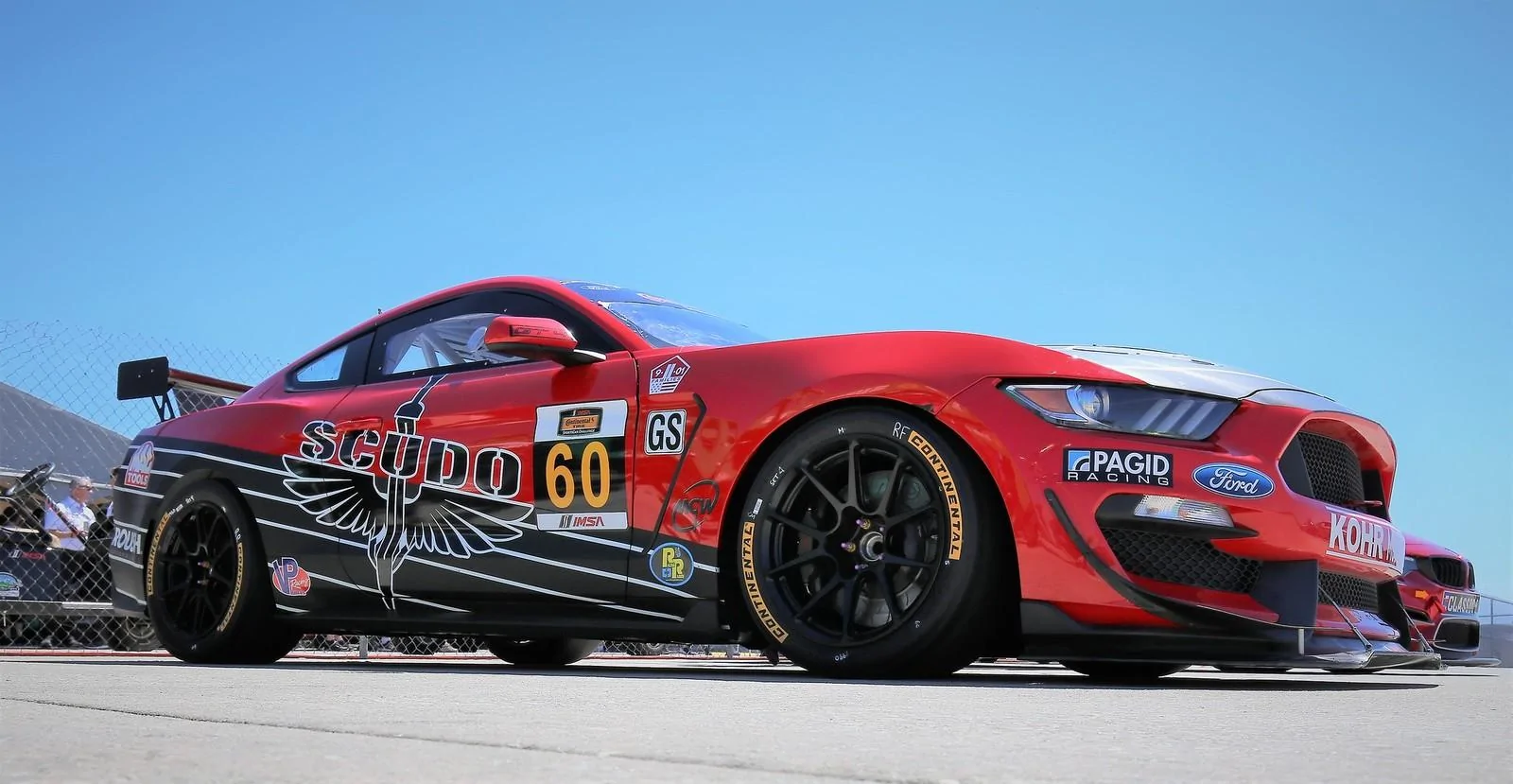

The best testament to MSI's gear is seeing it in action on the GT4 Mustang cars at the IMSA races. When these cars come into the pits smoking hot the MSI hardware is held to a standard most will never have to worry about. The lug nuts and studs they sell are as robust as they come.
Every single GT4 Mustang that Multimatic manufactures comes so equipped.
