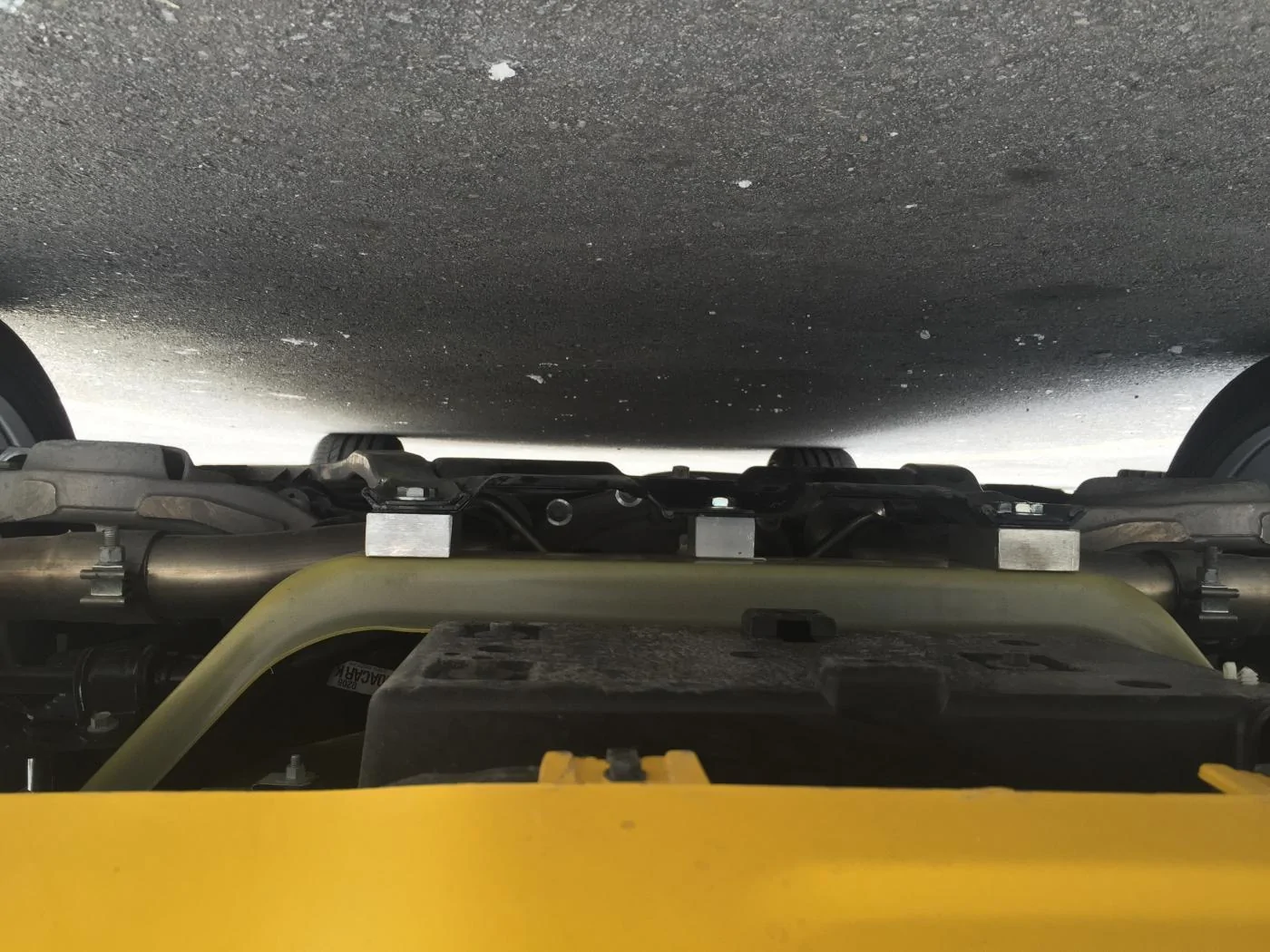

It's an easy fix... I've had the same issue with borla S-Type.
Here is what's needed... They need to put spacers to the braces...

I don't understand why my images are upside down...

Can you see the brace now from behind?
I had a similar setup with my SW exhaust and it looked terrible. People actually told me that there's 'something wrong' underneath my Stang.

No you have to be lying down on the ground to see it
