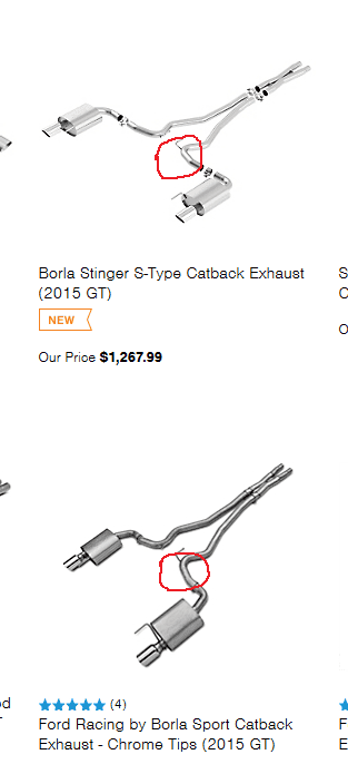

I'm not sure it will fit...
As you can see in the attached picture... the problem is at the area that I have circled.
The bend needs to be upward towards the body of the car. Which both exhausts do not have.
The original exhaust doesn't have an actual bend in the pipe at that point... they have a piece that has been welded on that goes around the brace.

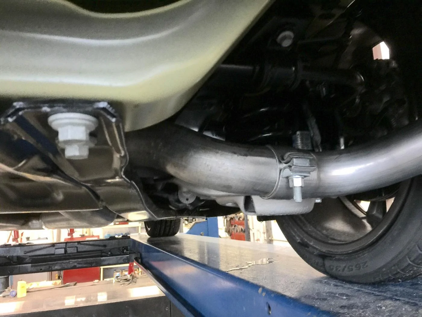

After some extra work, the Borla S-Type catback is finally on my car. It took the addition of some bushings, relocation of the pin on the drivers side muffler and some pipe modifications...
All in all, an additional $220 in cost... I'm definitely not overly happy with the fact that Borla has made an exhaust that they state will fit the convertible when in fact it does not.
But I must admit, I do love the sound of this exhaust now that I have it on the car.

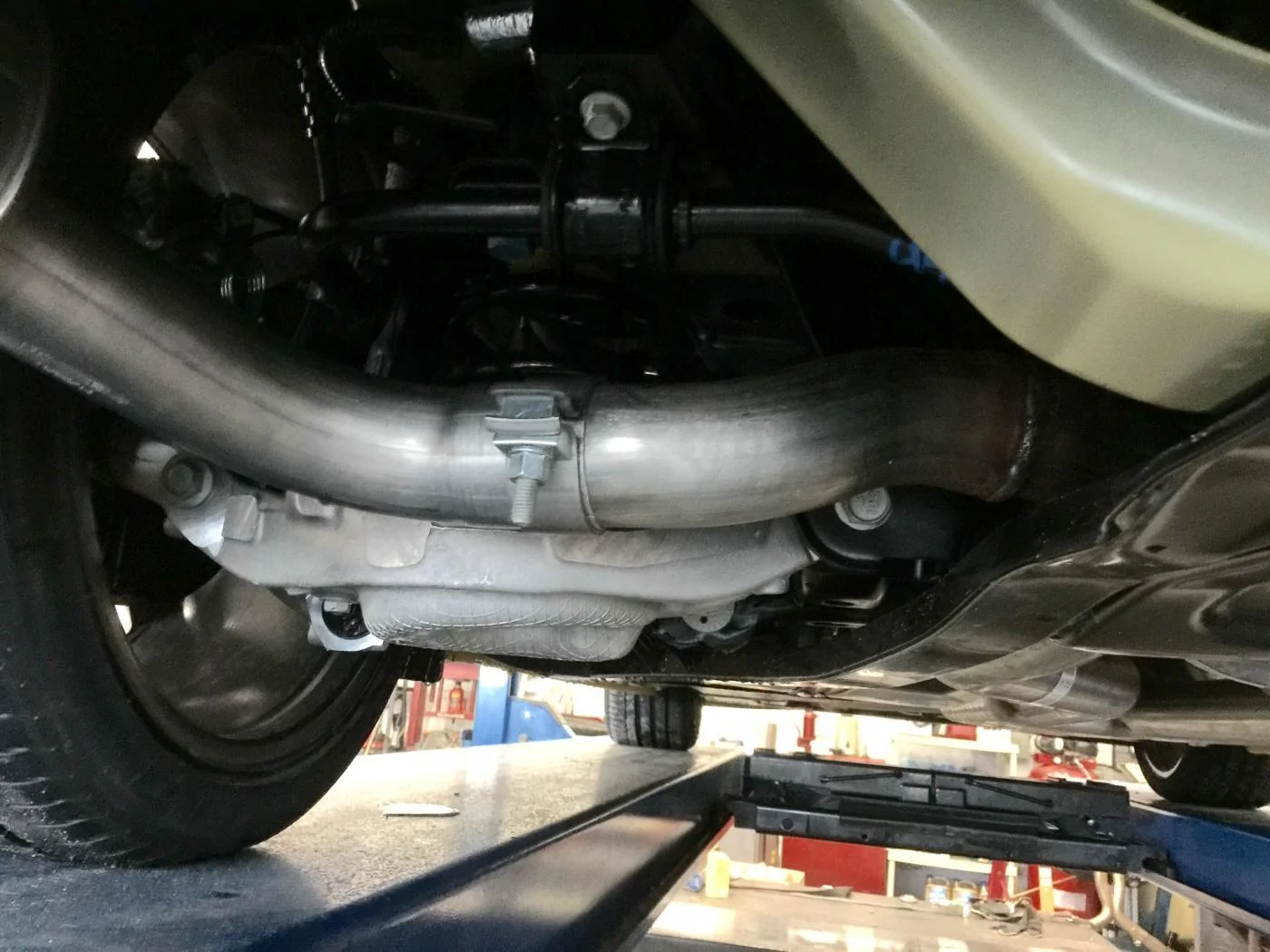

I had the Roush axle back mufflers installed on my 2015 Mustang GT convertible this week. As you can see from the pictures I took, they do fit, as previously pointed out. The cut point is before the convertible brace interferes on both sides. Thank Goodness! :headbang:
