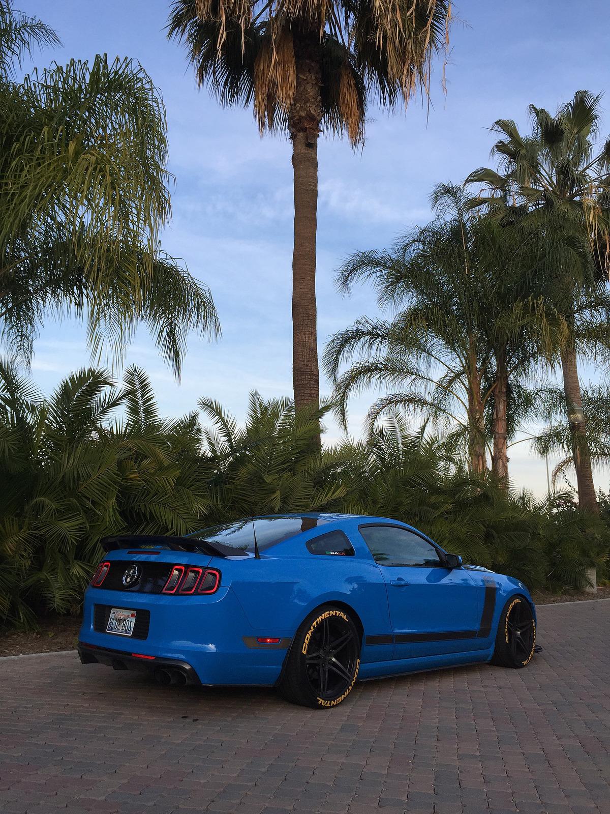

Anyways I had the same issue with wheels out there in the market. I came from the import scene and had a 350z with more play then the mustang in offsets. Yes other cars with lower offset are going to have better looking cast wheels.
The only way your going to get great fitting concave deep wheels for the mustang is to go forged custom. I was frustrated and made my own wheels to fill in this gap.
You can still get a deep concave with a Monoblock wheel for the mustang. The issue is really the 55 offset, and custom you can get around what a cast or rotory forged company will not do.
The main issue with Forgestar, HRE and TSW is their wheels are universal. Even though forgestar can work with blanks then grind down the pad to the right offset The spokes stay the same.
For $400 more than a full set then HRE flow forms you can do custom concave monoblock wheel. Quite frankly have a lighter stronger set of wheels that are tailored to your car.
I lost 40lbs off the stock wheels and went wider 19x10 & 19x11. Run a 295 tire front 305 tire rear. I also track our car so the wheels are just not for show.
image by Saleen513, on Flickr
