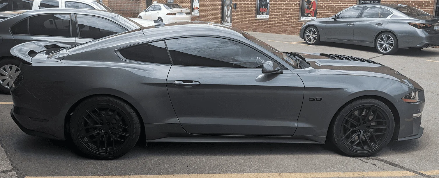

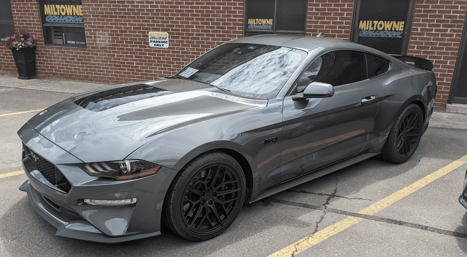

Really does transform the look of the car!! Stripes, PPF and Ceramic is next week.
