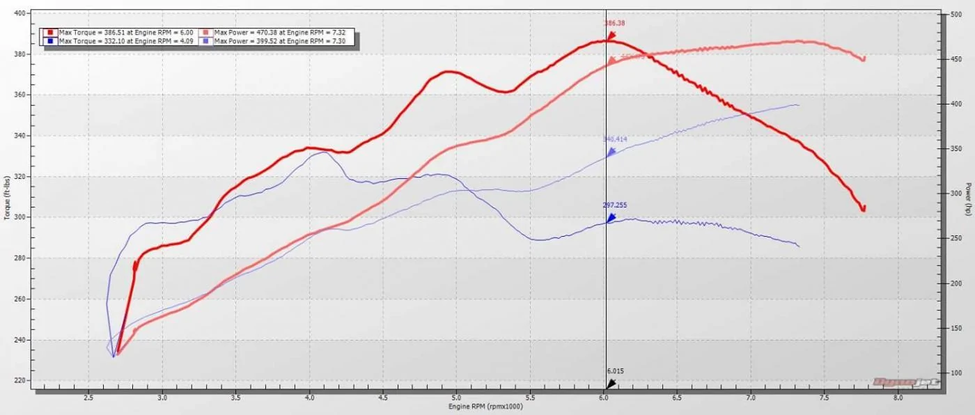

Jon Jr doing some magic with stage 2 comp blower cams on an n/a cat with plans of adding a sc later on
From. Jon Jr's Facebook
The "power" of cam timing. I tuned some Comp Stage 2 Blower cams on a 2015 GT Auto that is NA with a GT350 manifold and e85 today. I thought it was a bit odd, but he's going to add a blower later so I told him we should definitely dial in the cam timing so he can get the most out of it while it is NA. The blue line is what we started with. The Red line is what we ended up with. Under the curve it picked up over 100 rwhp in some areas and almost 200 ft/lbs of torque! Got to love these Coyote engines!
We are gonna have to talk about driving out to u for a install of cams gt350 intake and opg and crank gear in Dec I am sold lol
One hell of a gain in torque where it is needed

Holy sh*t that's good, Beef!
