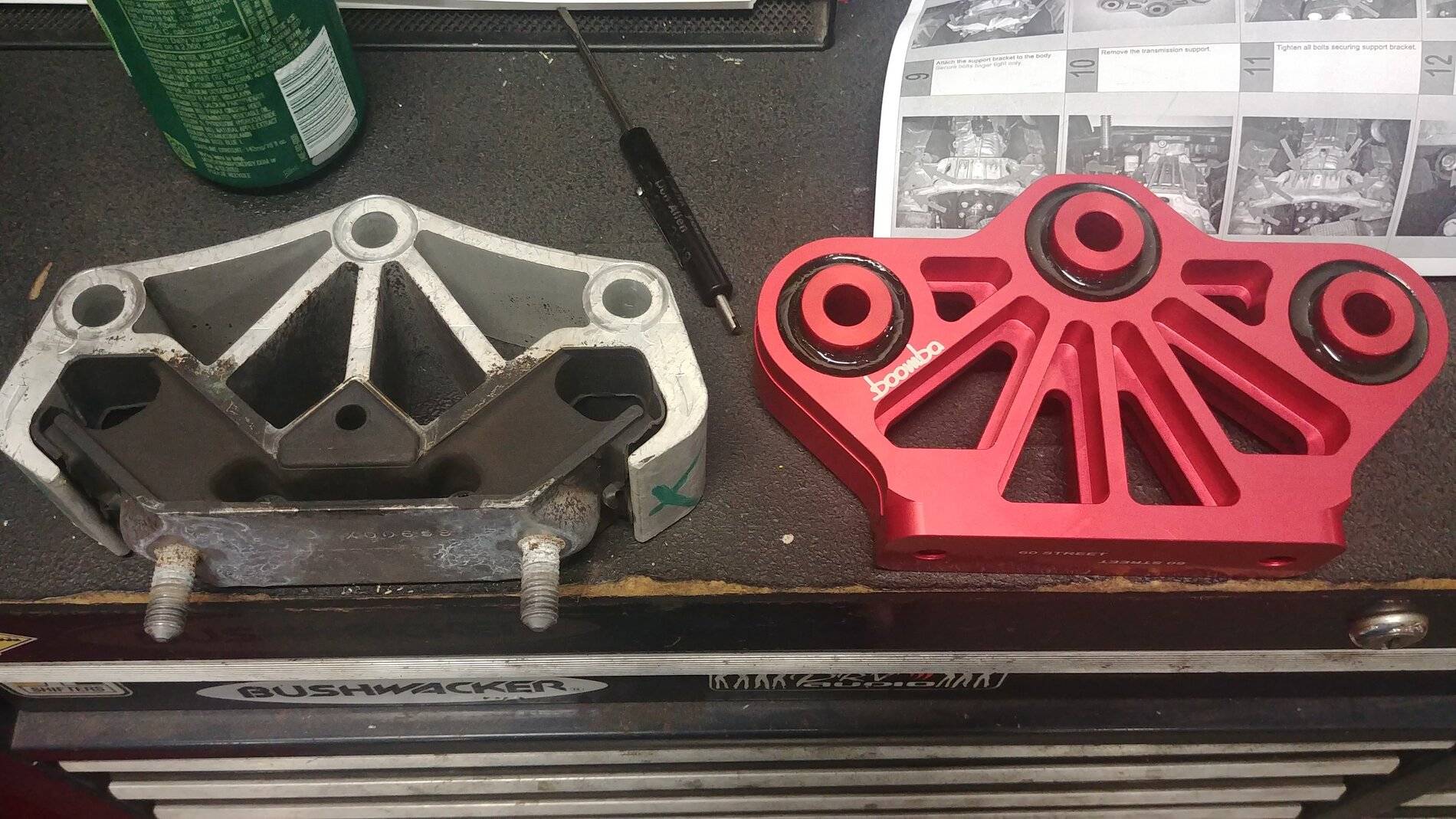

2016 Mustang GT PP
Thanks! Previous owner said he changed the fluid. I just ordered the mount. Hopefully that helps.
Hope you have similar results. Below is a pic of the 2 mounts side by side before I replaced. There will be considerable less "flex" in the boomba mount. I did notice a little more noise but it's minimal and after a couple drives I don't notice it. Good luck!
