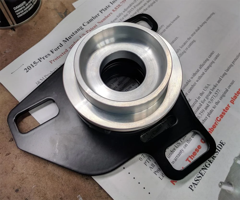

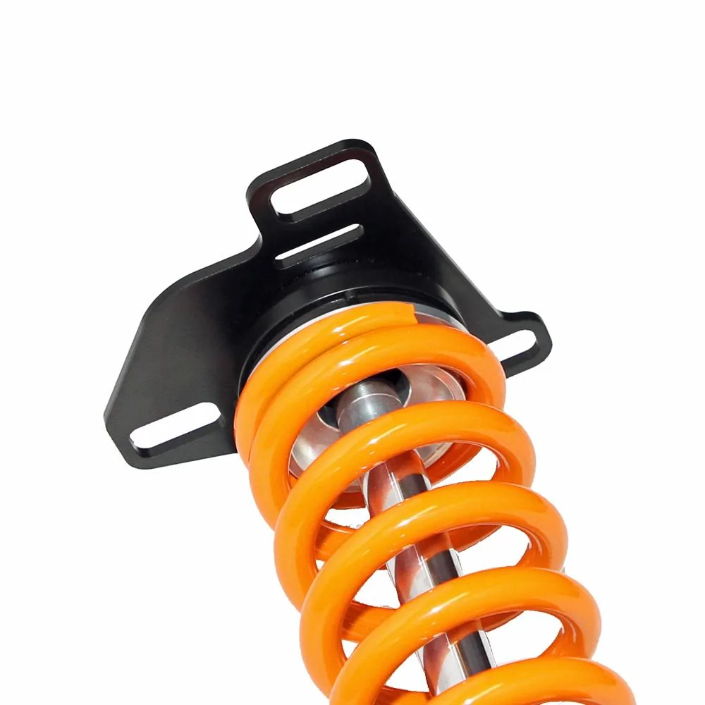

We have been in contact and will be carrying the Ohlins once they become available. The unique part is we will be offering them with our Caster/Camber plates with our 2.5" spring seat that is loaded on the Caster/Camber plate itself just like stock instead of putting the spring load through the spherical bearing.

We are planning on selling them with our Caster/Camber plates along with Vogtland springs in any rate the customer wants.
