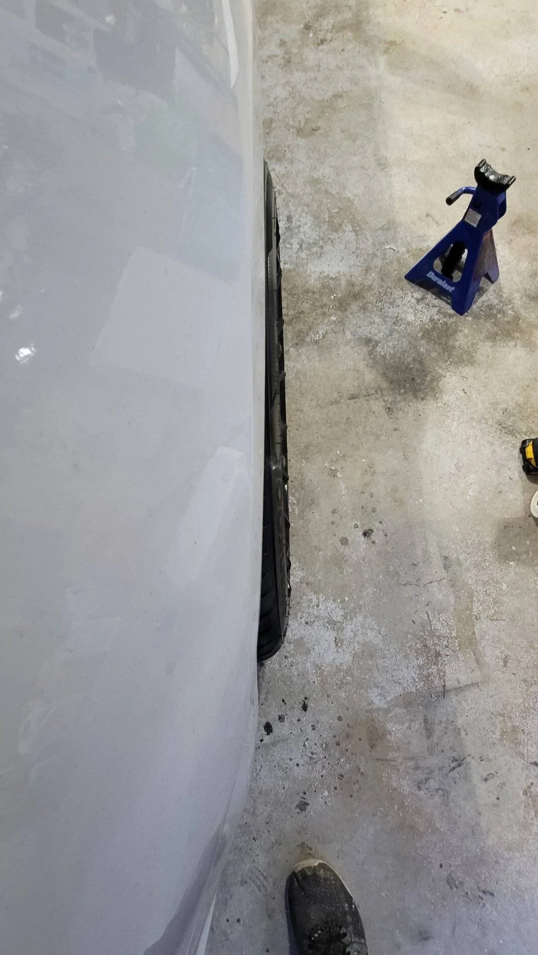

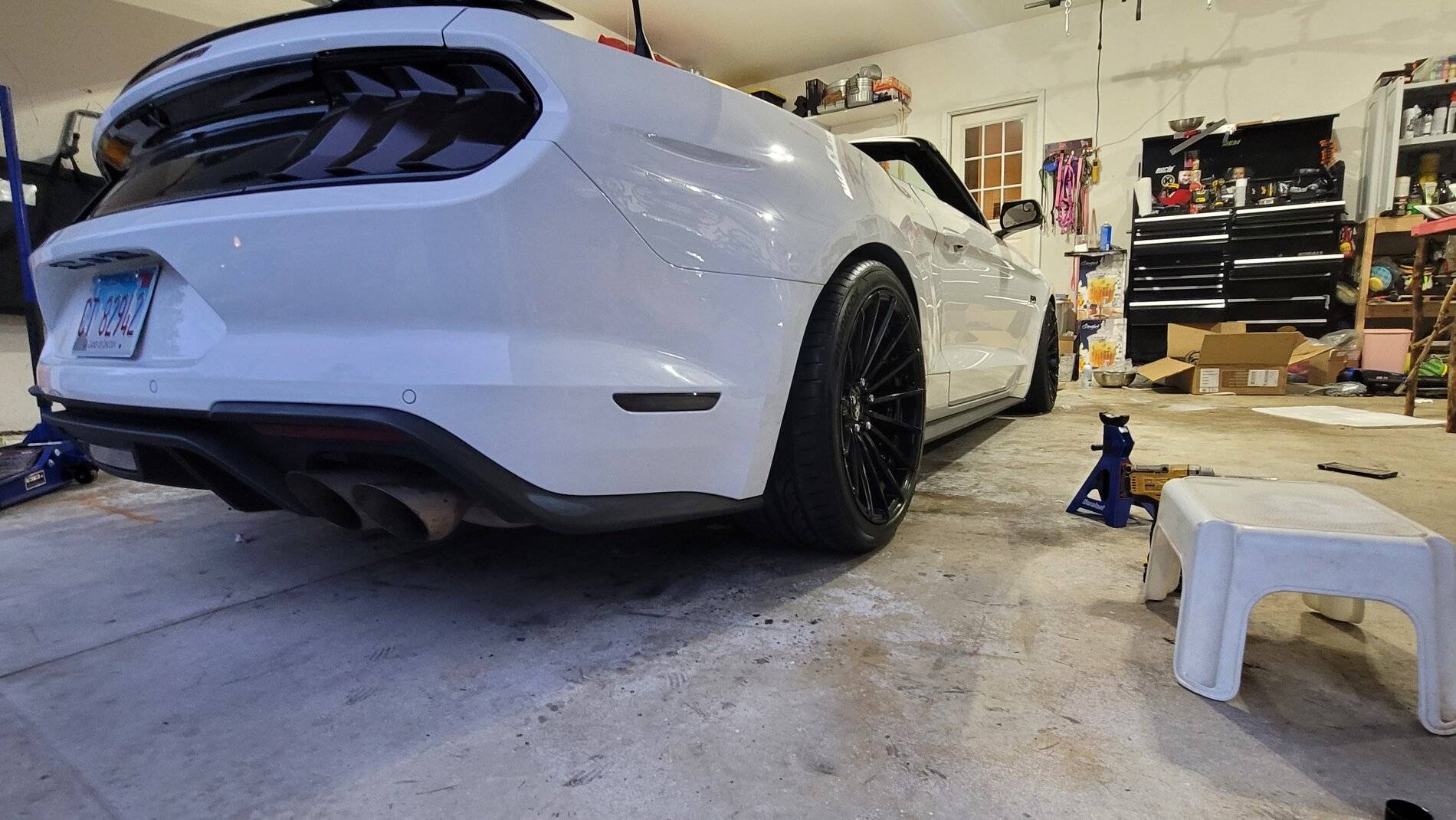

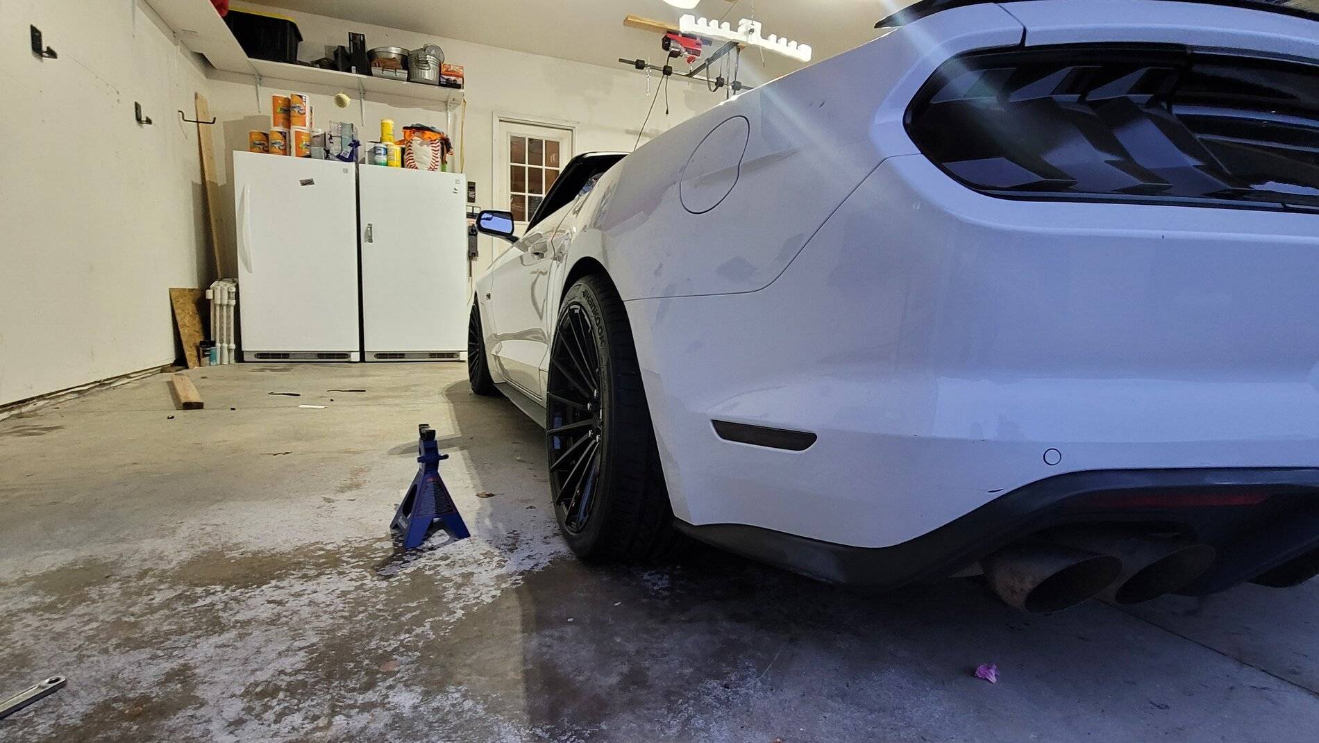

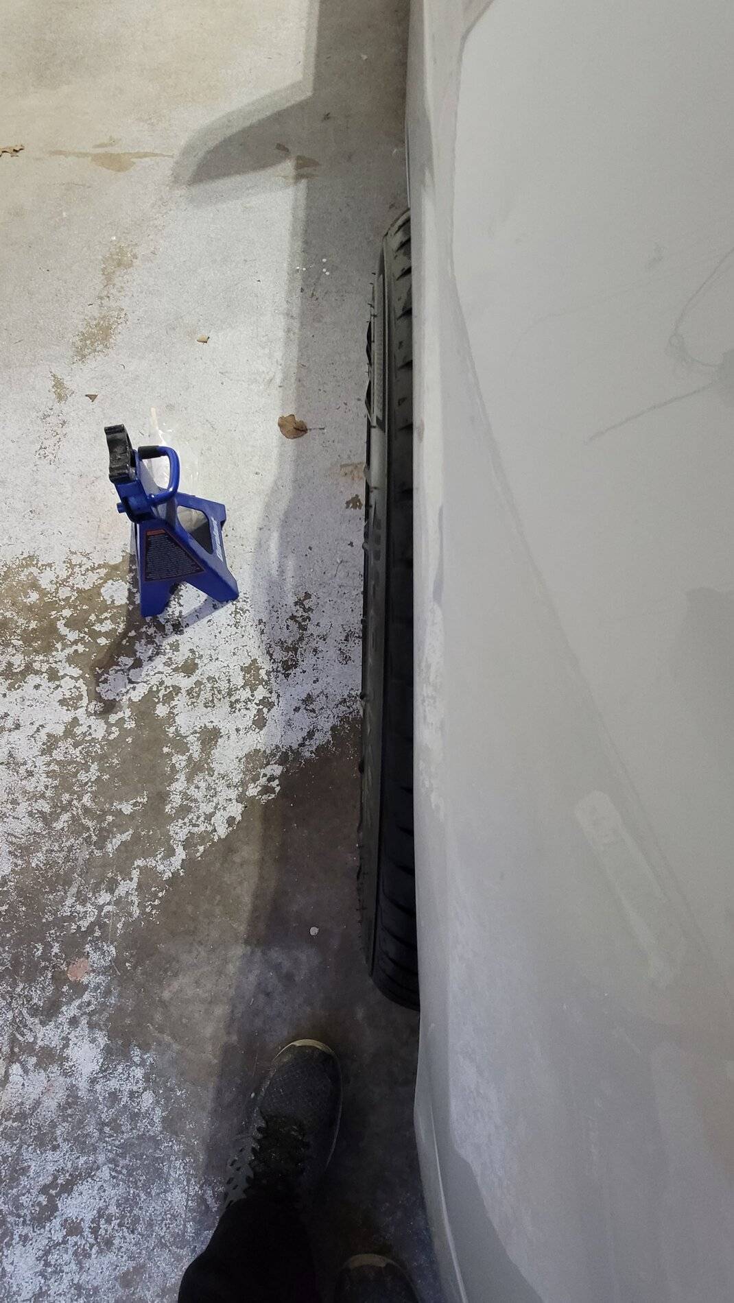

Okay, so I finished my install and the rear end is bugging me and I am hoping it is just an alignment issue. The rear end is 3/4 different from one side to the other and the side that is 3/4 taller, also has the wheel sticking out more. So, I took it all back apart, measured everything and the measurements were exactly the same on both sides. Put it back together and same issue. Not a lot or real noticeable, but... I know lol. Excuse the garage mess. Haha
Left rear is the one sticking out further.

Most likely you’ll need to realign your subframe. I’d recommend using Steeda’s subframe alignment kit.

you've loosened the IRS and put in alignment dowels?

The alignment dowels go where the large blue bolts go. Those align the subframe to chassis. The brace that you talk about only connects to front subframe brackets but it doesn’t align the subframe. So the best way is to get the dowels to get the guess work out of it.

Did you adjust it as low as it will go? With the poke in the rear, I would be worried that the tire hits the fender when you hit a good size bump.

Nah, rear is about 1.5 and these coilovers will drop to 3. The subframe alignment makes sense. Only problem I see is those with verts having to remove the whole stiffener to get to the front bolts. It blocks the sleeves/ dowels from going into its hole.

Now that you have coil-overs, you have a new adjustment to set. Corner weights as @Grintch said. It's not that hard but whomever does it needs to have scales. Your driver's side being high will fix itself with a corner weight adjustment. Right now most of the car's weight is on one of the diagonals.
