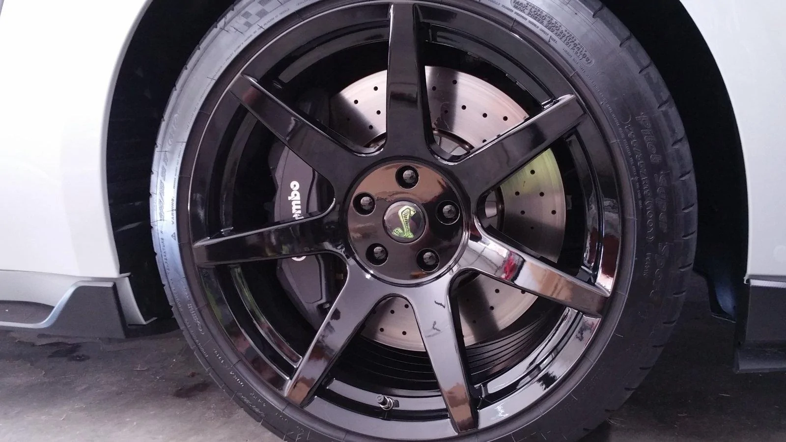

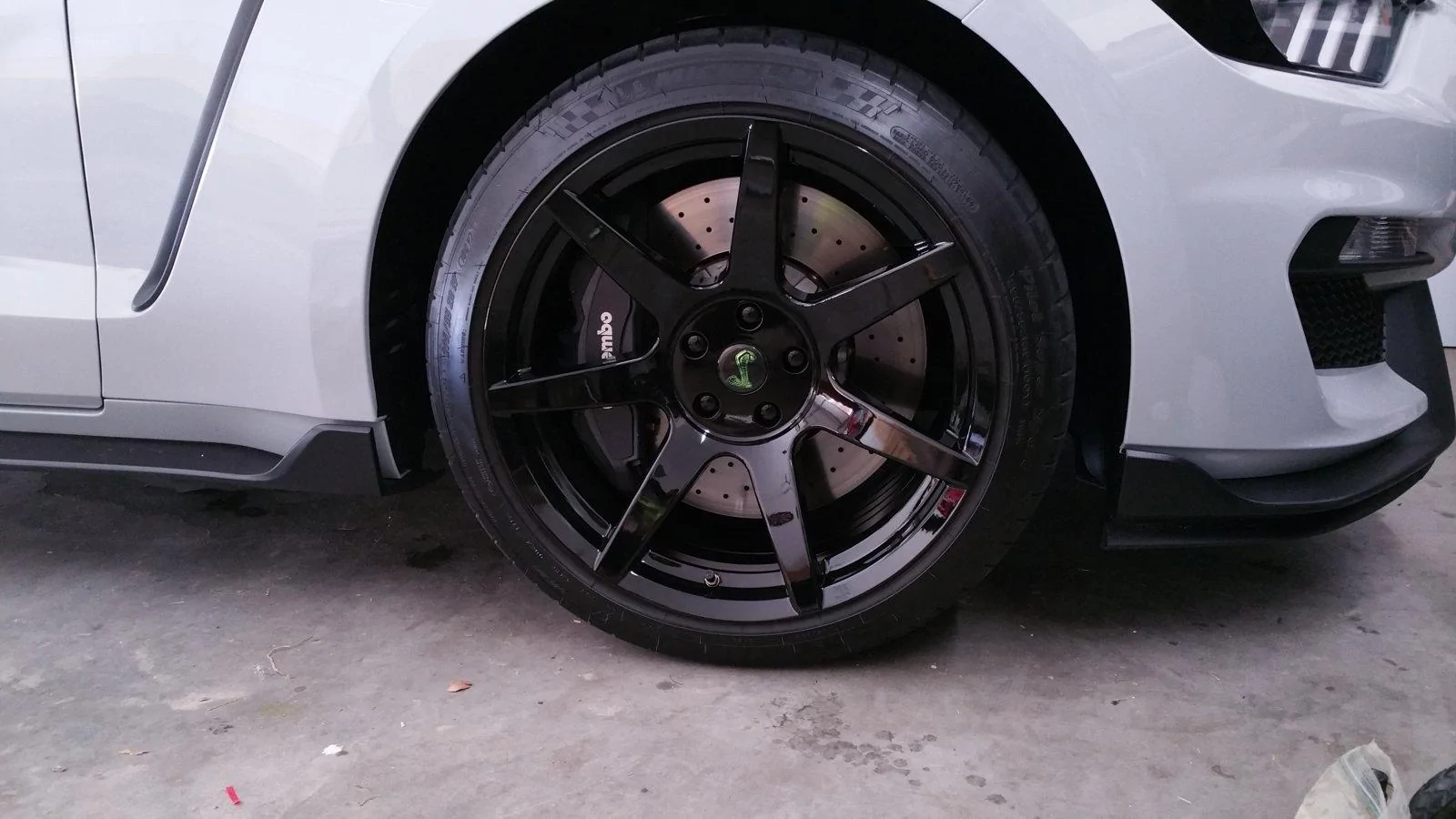

I made my own for my 350. Ordered everything to make them for the 500 in reflective orange to match.
Texxas: Can you tell us how you made them? I'm confused about how you did it with reflective tape/vinyl. TIA.
TexxasGT350
Nov 16, 2015
239
346
Odessa, TX
Brandon
2016 GT350, 2018 Rator, 2020 GT500

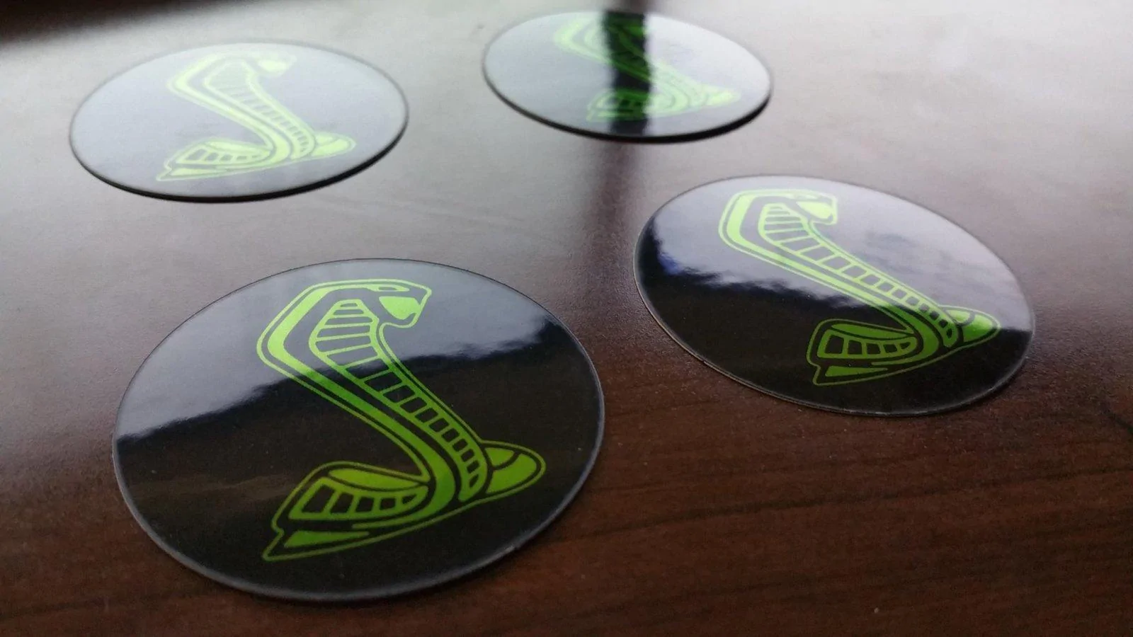

I created 2 color vector file the size of center caps. Used https://stickerapp.com/material/mirror-stickers/ to print these. Anything black in the design masks out the reflective foil, any color shows up as metallic.

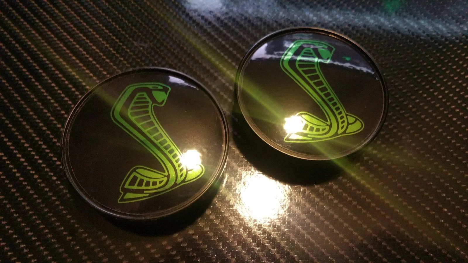

Stuck on blank center cap

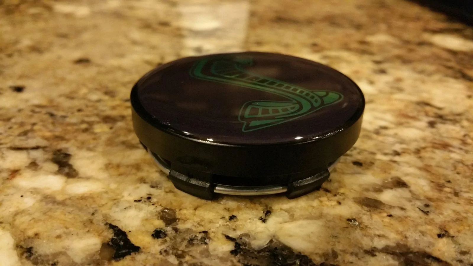

Used 2 part clear casting epoxy and torch to get bubbles out. Just dripped it on until it was domed up.

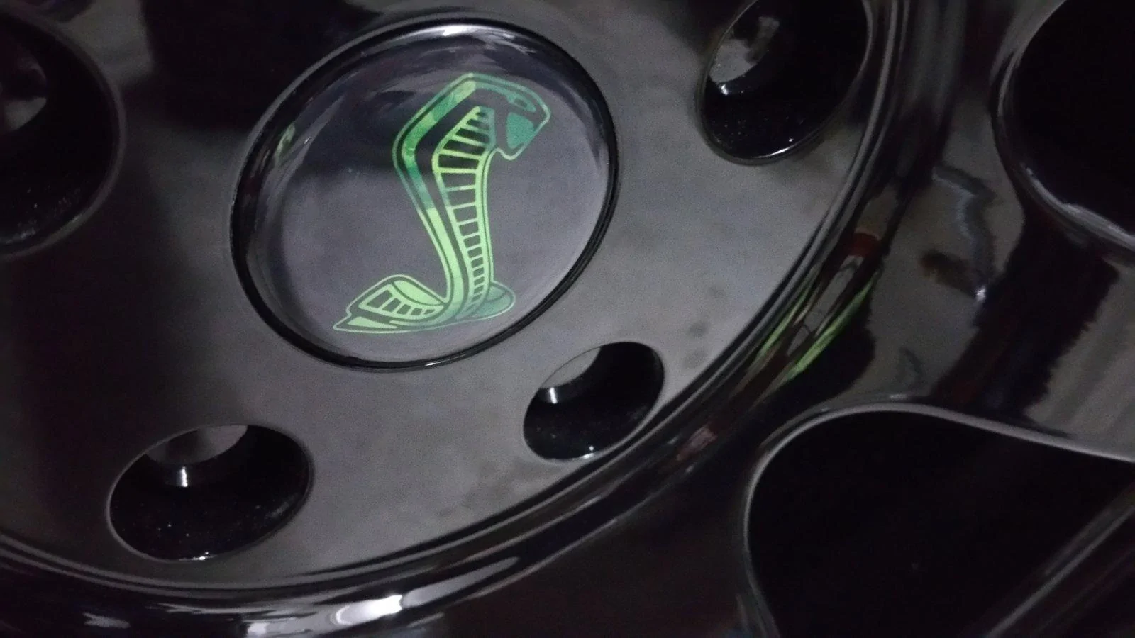

Final Product
